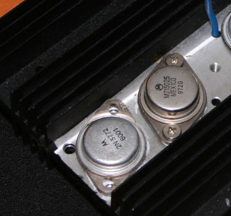

I have an original GAS Ampzilla amp and one channel is now no output.
Repair tech has testedand said there is no output in the 2 pairs of output transistors GAS 101 (both) and GAS 102 (both)
He claims the closest equivalent isMJE 15003 which he claims should have adequate volt and amp capacity.
Has anyone any ideas on suitability. or my best substitutes for these transistors (GAS) ?

As long as they are not counterfeit, the MJ15003/04 will work.
The MJ21193/94 are much better parts, and are recommended by the designer of that amplifier.
MJ15003/4 are in current production and run about $3.50 a piece. Do people really bother counterfeiting these?
Sadly, yes.
I have some "MJ15024" and "MJ15025" that aren't much more expensive nowadays and they are counterfeit.
They blow up at about 1/3 (derated for temperature of course!) rated power 🙁

The MJ21196 is a recent part, not available in 99.
The MJ15024 case does not look like that, never has.
The MJ10022 has an 02 date code.
Measure the B-E capacitance, it should be in excess of 2800pF on real parts.
Motorola became ON sometime in 99 (real parts shown above).
megajocke said:Sadly, yes.
With the 15003/4 you're more likely to get a counterfiet than a real one. According to On's website, they don't appear to be in production anymore.

Aws near as I can tell, only one of the many vendors on eBay has real parts.
All the counterfiet photos are from current eBay auctions.
