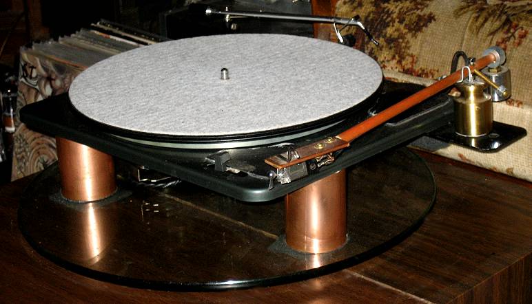

Been There...Done That...Sounds Great!
There is No Rumble at All using a Detached ToneArm...
Stews Arm, for that Matter....Thanks Stew...

Hey sled...
...looks good. Which table did you use for the basis? Sorry haven't been keeping up on everything... I lost all email contacts, and previous email notifications, but my iMac is finally working (semi) normally.
How does it sound? Did you use Kynar?
