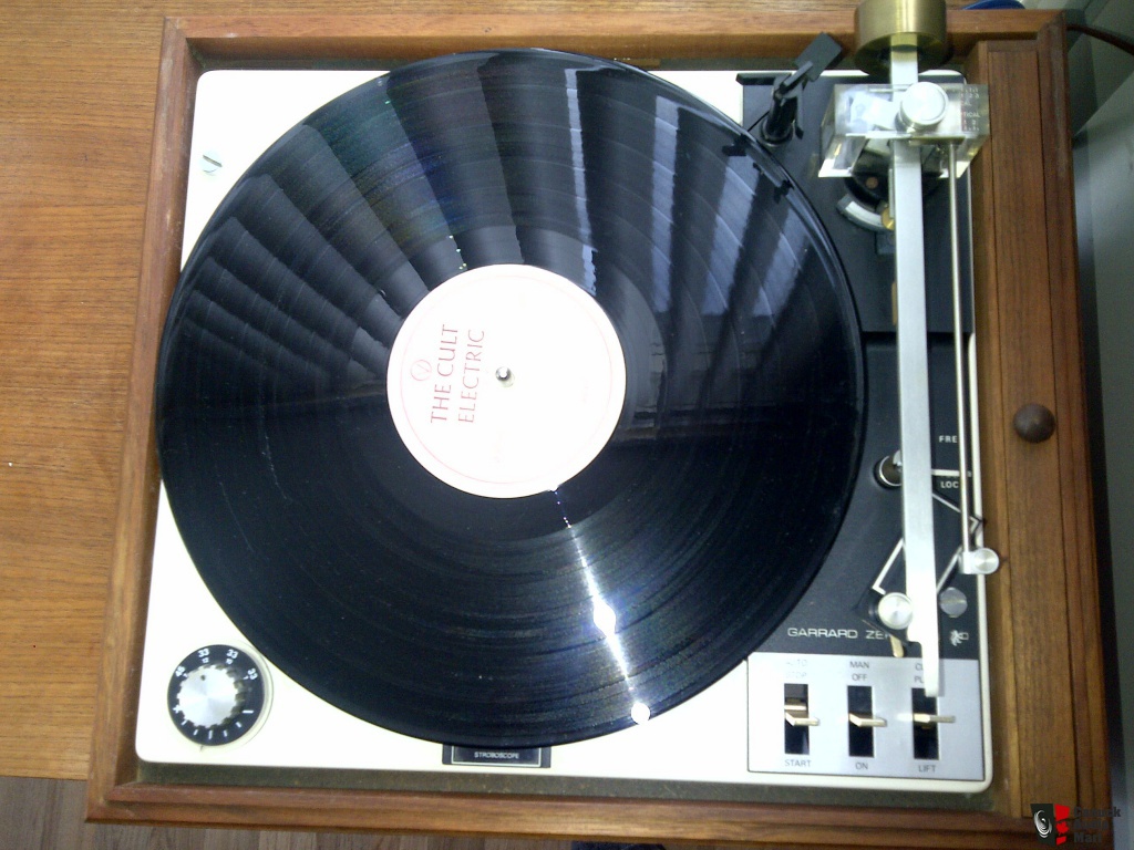

I have a Zero 100 that I bought in 1973. It does have a few problems I am working on, but overall is still in good shape. I have heard that they had good and bad years where quality went down to save money. Hope you are able to get it going again.
