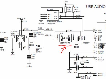

Hello.
Could anybody help please?
I wish to connect my laptop (USB to USB), to an rCam DAC.
Going direct, as you can imagine, the background noise is horrific!

looks like there is already an internal isolator see attached u101.
Have you tried contacting Arcam for their solution? maybe some issue with grounding DAC wall wart or laptop AC/DC power brick. Use laptop batteries or SPDIF and/ or optical.
A galvanic isolation would not use the USB power supply and ground directly in the device. That IC is just an EMI filter and line terminator http://www.datasheetcatalog.org/datasheet/SGSThomsonMicroelectronics/mXyxuss.pdf
thanks for looking that part up. yes not a real isolator I should of known cause the 3.VDC connection on the input side and common ground.
6V shown on schematic seems low for 3T linear reg. ripple rejection, but probably measures higher in real life. need to use O-scope to check.
