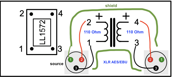

Hello, I have a PCIe card with AES/EBU 110 Ohm output that I want to connect to the AES/EBU 110 Ohm input of my DAC through a cable.
I would like to add galvanic isolation to this connection using the 1:1 transformer LL1572 by Lundahl.
Which schematics do you suggest, among the solutions A-B-C below? Thank you in advance.

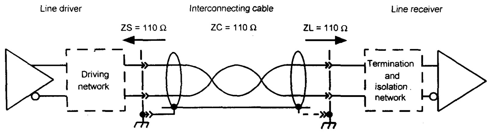

None of the above. IEC60958 say to have the transformer in the signal and connecting the grounds with the shield of the cable. So your transformer should go between pins 2 and 3 and pin 1 should connect to the shield of the cable. For normal distances in house you could leave pin 1 unconnected.
As for a transformer, a miniciruits T1-1T is also usable.

It's solution A with pin 1 in the source connected to the cable shield (and pin 1 floating in the destination), right? Thank you 🙂
