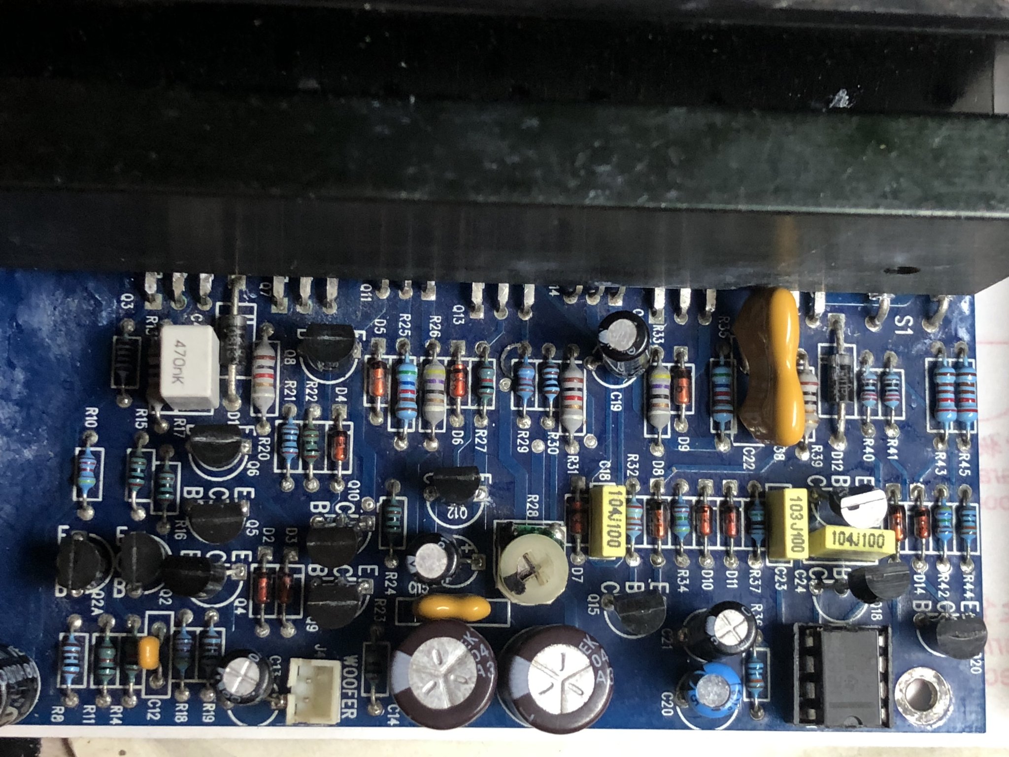

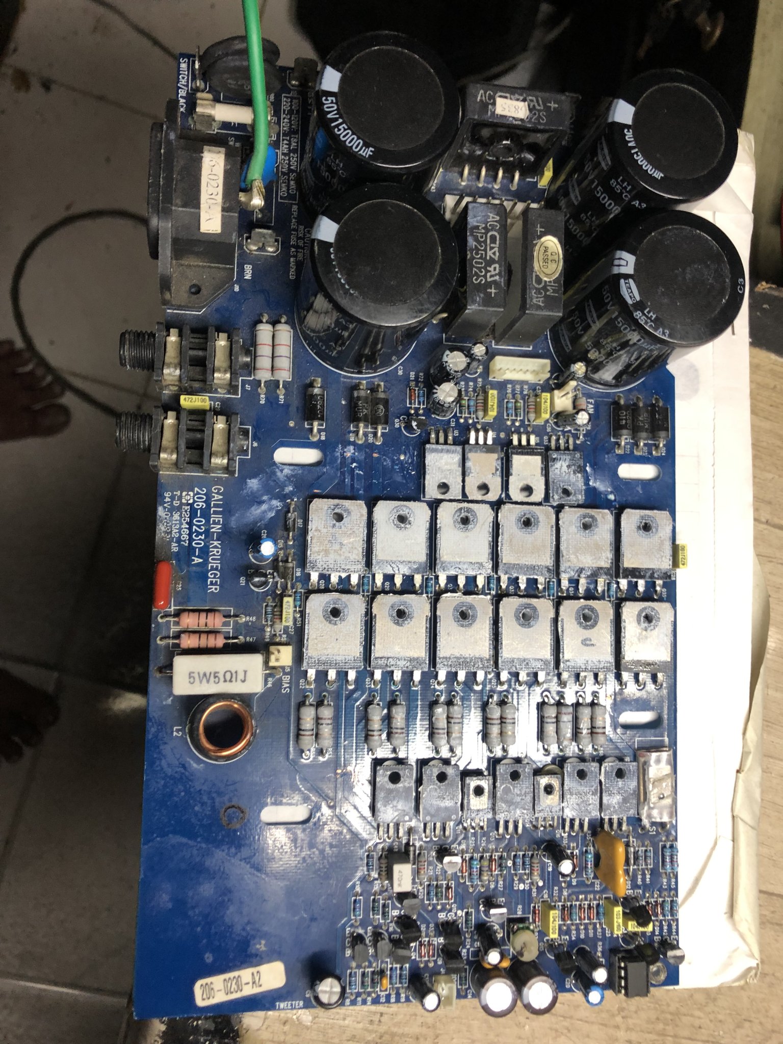

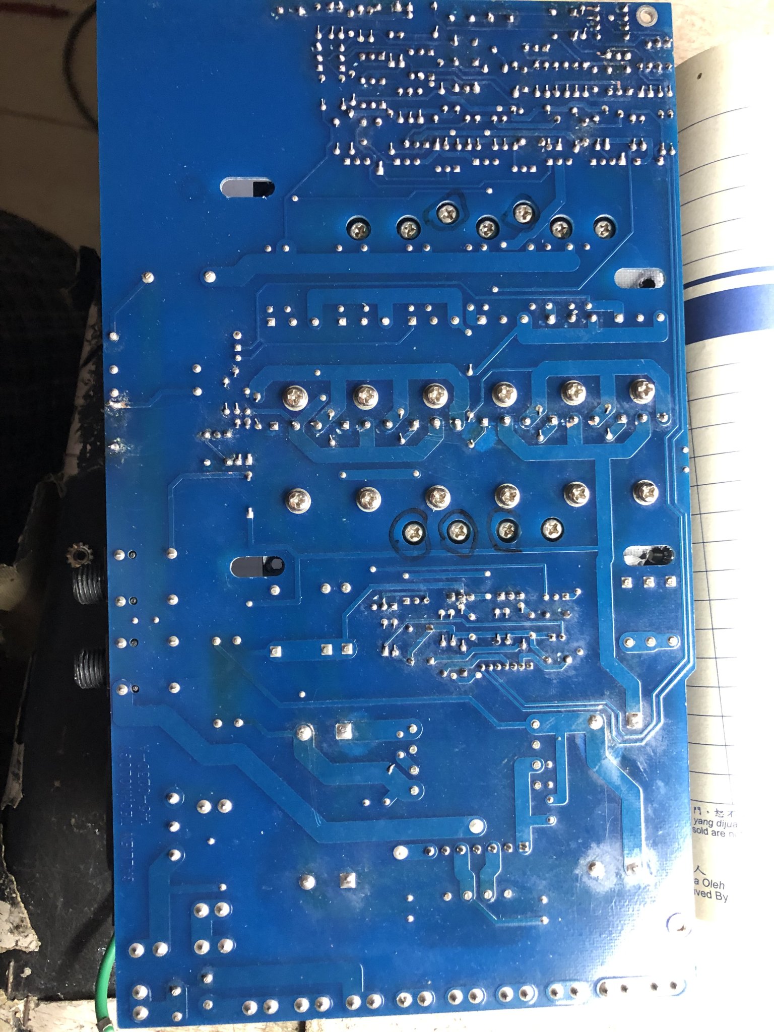

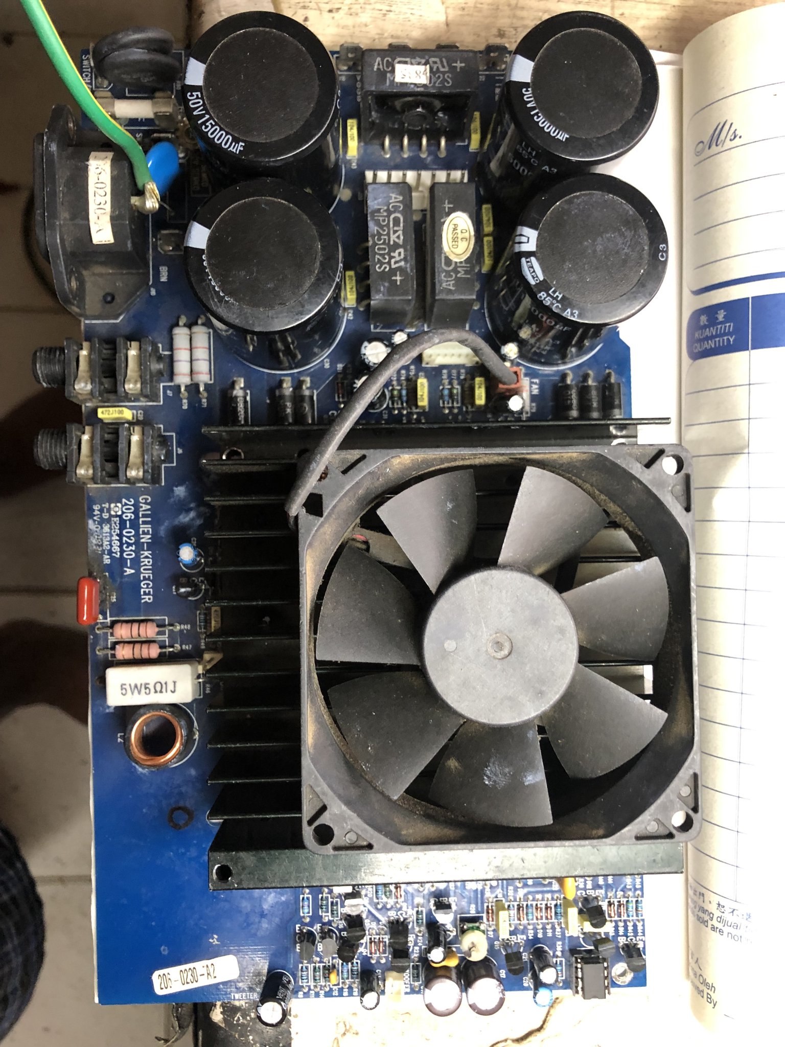

Hi
I am sorry, there are lesser transistors on the board than compared to the schematic and the numbering is not as in the schematic. There are only 15 (T0-92) signal transistors on the whole of the power board. I have not taken any reading as I am not sure of the transistors concern as the numbering is different. As I said the voltage at L1 is approx 16 to 18mV. The bias pot is set at minimum (maximum resistance). I have removed all the 15 transistors out of board and tested them. I guess it is not due to some shorted component but due to some problem with the protection circuit itself or oscillation as suggested by you. Any idea what I should check for apart from the transistor readings.

I'm sorry you don't have a schematic to work from--- makes the effort far more tedious. But the low output offset is very reassuring. Do you have a scope to look for oscillation? If the 0.1uF Zobel cap is good and there's no warmth in the Zobel resistor, perhaps oscillation isn't the culprit. Then a problem within the Fault circuit is a good guess.
With the new 555 in place, is the cycling like it was in your first post? Try to confirm that activity from the Fault signal triggers the shutdown sequence. Remove the 555 again if necessary to get a stable failed state. With luck, the Fault signal will be showing activity. Try to trace Fault line from the known location near the 555 back to the originating components. The circuit will probably resemble what's used in other versions.

You would not believe what happened today. I removed the heatsink, removed all the screws on the transistors. Looking at the board especially underneath the transistors, there was solder paste all over the place, as I resoldered the whole board earlier. As I dont have a heat gun, I placed the board under the hot sun for about an hour. After cleaning the board, I apply a thick layer of heat compound on all the transistor. Without putting back the screws, I placed the heatsink and screwed the heatsink on to the chasis. When I powered on the amp, the red LED came on. the fan started spinning for a while and stopped and about 2 secs later the blue LED came on. I plugged in a CD player and it remained on for an hour. I turned the amp on and off several times and it never failed; not even once the red LED came on. Before this the fan never came on. I am going to put back all the transistor screws and try again tomorrow. Will inform.
Reactions: JMFahey and BSST
Hi
It is not over yet. I fitted back the screws on the transistor and powered the amp on. It turned on without any problem. After about 30mins, It started turning on and off again. The heatsink was fairly hot, but the fan was not turning. I used my finger to push the blades and then it was running. I feel it has something to do with the thermal protection circuit. There is a terminal breaker and a heat sensor (LM35DT) under the heatsink. About 3hrs later I turned on the amp, and it started without any problem. I turned off the amp about 20mins later as I had to attend to an appointment. Will keep you informed .
