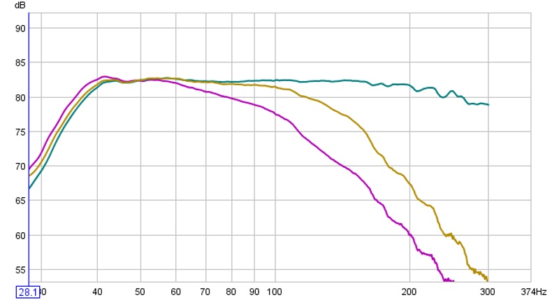

Bought this secondhand, mainly for the electronics. Consists of an average, standard 8inch woofer, mounted in a thin walled, 12inch cube enclousure. Relfex loading, with little internal dampening. However, I was surprised with the measurments I recorded (see attached).
Is this what one would expect to see from a cheapo small sub?
Expect? Hard to say, but it seems reasonable to me since I use to build similar size box volume (Vb) speakers with cheap RS drivers with similar results when I used T/S max flat alignments.
