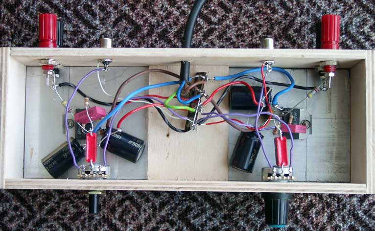

Since you posted a pic of your ML TQWP speakers, maybe you could post a pic of your gainclone and we could see what might go wrong. It doesn't seems that too many builders are so dissatisfied with their clones (like you are), so maybe something indeed went wrong when you were building it.😉

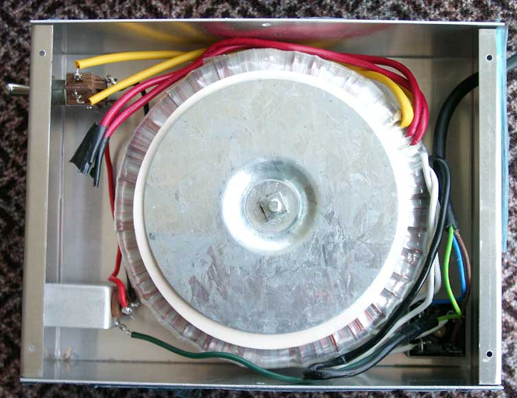

Re: power supply pic

Jim Read said:The transformer is 34-0-34V 200VA, 50 amp bridge, and a 'smoothed' Euro socket
One Bridge? Not my Circuit. Your circuit.
As for the Sony, I hope you turned Loudness off and bypassed the tone controls, so that you are comparing the Amplifiers and no the presence and absence of Frequency response shaping.
Sayonara
If that's the AC voltage on a transformer, it seems pretty high by usually accepted standards, 24-0-24 is much more appropriate.
With that transformer your exceeding the maximum supply voltage by 5VDC per rail and probably driving the amp well outside it's optimum range for optimum THD+N operation. You can find the specs at http://www.national.com/ds/LM/LM3875.pdf.
As Peter recommends, staying on the low side of the recommend voltage range seems to provide the best sound.

Re: pic of the amp
Koinichiwa,
And something I overlooked. If you Mains transformer is really 34V-0-34V you are very likely triggering the IC's over Voltage protection. The absolute MAXIMUM secondary Voltage I recommend is 24/25V and that is borderline already in the UK with maximum tolerance high mains voltage.
With 34V-0-34V and 7% regulation as well as a 230V primary Mains Transformer on the UK 240V mains you get approximatly +/-52V power supply Voltages. ABSOLUTE MAX rating with no signal is +/-47V and with Signal +/-42V!!!! If the PSU voltages are notably higher than that the overvoltage protection circuit will cut in. The result should sound awful.
What 0.1uF? I never specified 0.1uF. And are you sure it has the voltage rating to withstand the Supply voltage, Tantalum usually does not come in 100V or higher?
And by non-polarised you hopefully do not mean non-polarised electrolytic capacitors. What did you use as PSU Capacitors?
Anyway, it seems to me that you have changed a few things that in my view are absolutely essential and quite possibly have actually made an non-functioning Amplifier.

Koinichiwa,
I see three things that I'd note.
1) Ground routing - no dual mono as recommended and no seperate windings, this must lead to "dirty" ground
2) Output Resistor is 1/4 W Type (or thereabouts). Not good.
3) From what I can see the RC circuit on the non-inverting Input is not present, this may cause excessive offset which with a speakerload may heat up the chip too much.
Further, if the rails are at the kind of voltages I suspect they are at the PSU Cap's and the Chip are near or above absolute limits.
For one thing I would like to say is that I have to disown this gainclone as being "according to Thorstens Design". It is not. It is according to Jim's design and in a number of key areas seriously problematic.
Sayonara
Peter Daniel said:Here's Jim's gainclone. I asked him to e-mail the pic to me, so I could post it for him🙂
It's looking pretty good and if there are any problems with sound, it may be because of too high rails, indeed.

Thanks for loading the pic Peter
In answer to some of the points raised, the sensible ones, some people on this forum can't even read a circuit diagram and certainly don't read the posts properly.
