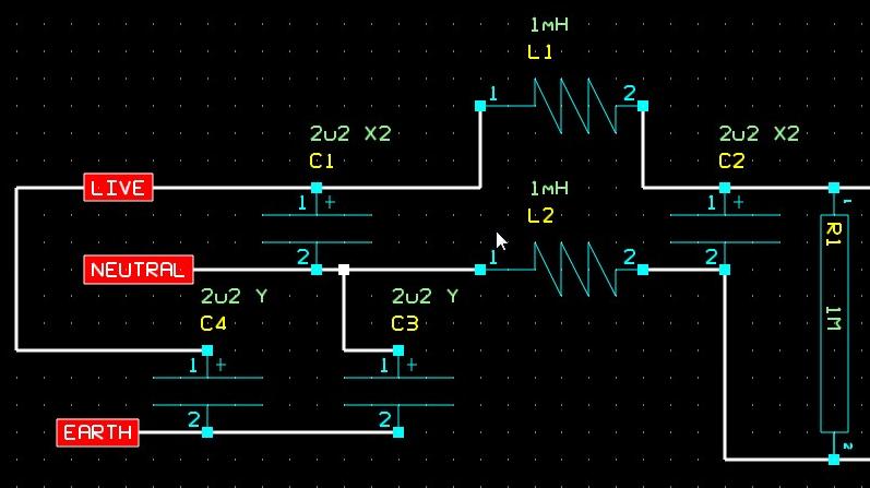

Can i have a diagram of a simple rf filter for the mains?
Stormrider said:I have a similar problem in my house. There is a store built into the house, so when one of the bigger coolers turn on i get a pretty loud pop through my speakers. I'm using a Hafler P230 and a Ashly FET-200 amp in a bi-amped setup. Installing IEC filter connections in both amps seems a waste if i could just install a filter myself.
c3 & c4 are too large.nigelwright7557 said:
Reduce to about 2n2F to 47nF to keep earth leakage to acceptable levels. Earth connected caps must be Y rated as shown on the diagram.
AndrewT said:c3 & c4 are too large.
You will need to scale down the components a bit as this was used with 110V and 30 amps !!! I just pinched it straight from an old project. It gave excellent results during EMC testing.
