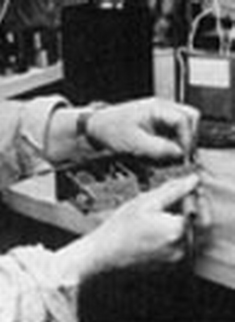

I´m almost sure the old pictures that were around are from a real Gaincard. The rods, wiring and attenuators are the same. Just a small thing one makes me doubt about it.
In this picture
the boards are square shaped.
In this one, taken before the revision
the boards look rectangular, just like those in the newer pictures.
Perhaps something went wrong and they were rebuilt by the owner?

That's a keen eye 😉 I'm sure he's laughing at us. Quite impressive that he's kept anyone from getting into one to take independent pics. Good on him.
With all due respect to Yoshi, all the similarities between the official and unofficial photos suggest to me that both are photos of real Gaincards.
I think that photos in question are of an earlier Gaincard. After the negative reaction to the workmanship, I think they went in and revised the insides of the amp. It's not unheard of at all for manufacturers to make changes or adjustments to a product without announcing anything. I think that's what happened here.

PauSim said:I´m almost sure the old pictures that were around are from a real Gaincard. The rods, wiring and attenuators are the same. Just a small thing one makes me doubt about it. In this picture the boards are square shaped.
In this one, taken before the revision the boards look rectangular, just like those in the newer pictures....
That IS a very keen eye you have. I didn't even notice what you were pointing out until I went back and stumbled on it.
You're right. Kimura is, indeed, working on a Gaincard and the boards look rectangular. In fact, aren't they even more rectangular and bigger than those in the current "official" photos?
I recall seeing this picture Kimura a number of years ago, so if they switched to a different board they must have done so early on. That suggests that the boards in the mystery photos may have been a very early version of the Gaincard. Perhaps. It's also possible that there are any number of board revisions. For example, the Brian GT LM3875 boards are already on v.3, all a little bit different.

Also, the debate about the Gaincard pictures is officially solved. They were of an earlier version of the Gaincard according to the review.
