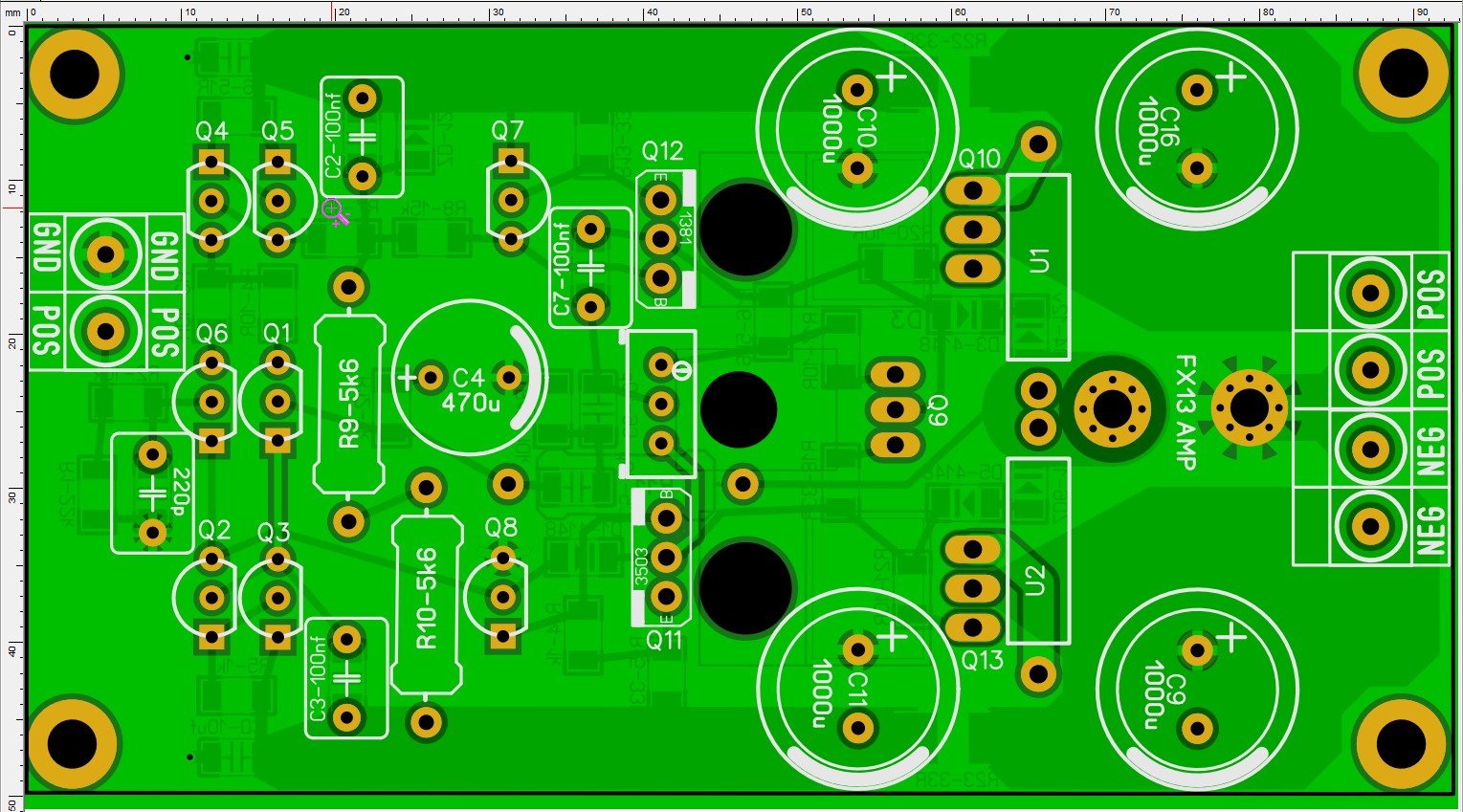

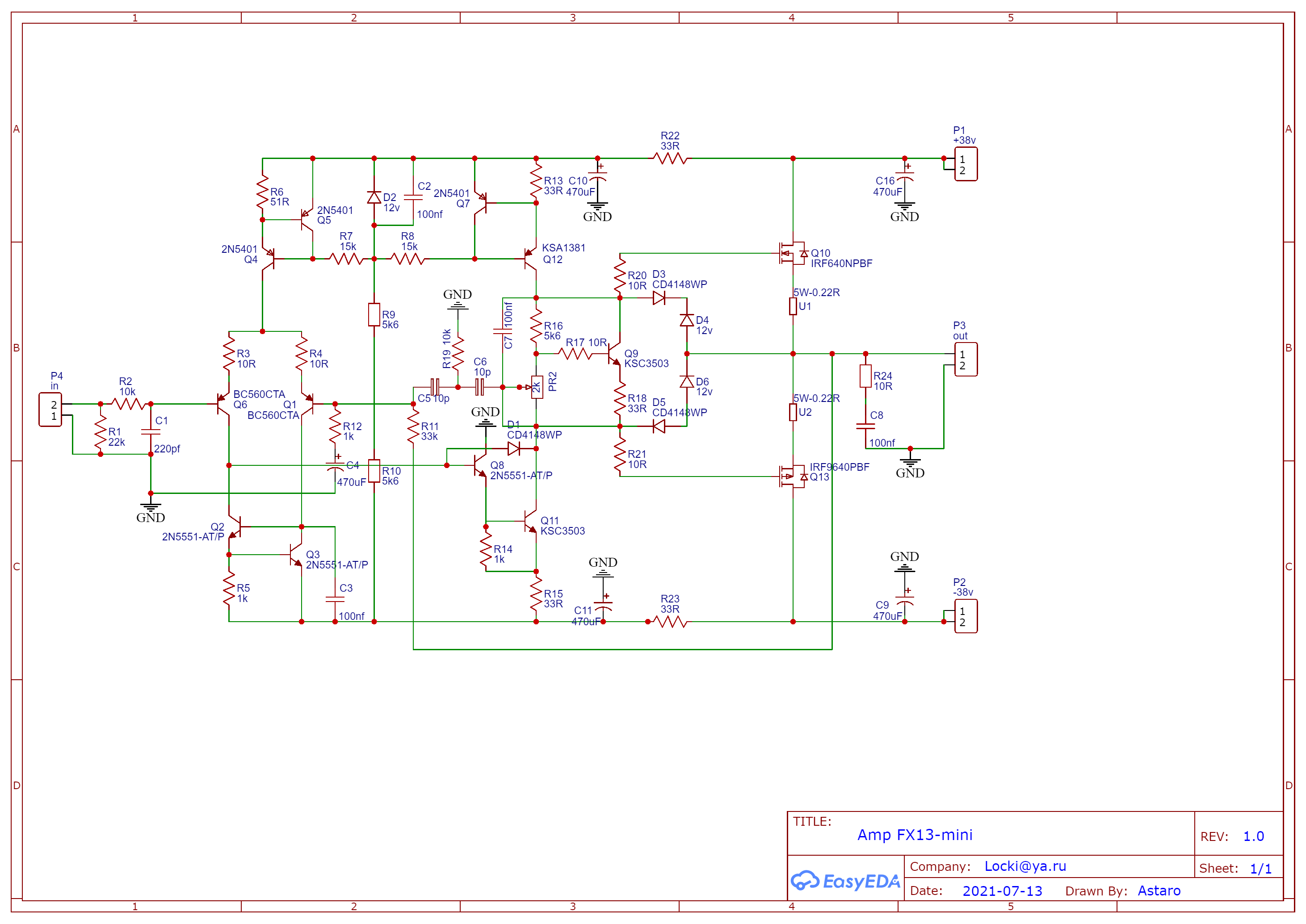

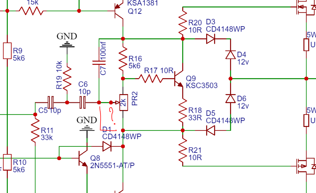

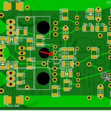

I found this circuit of the amplifier board, do you think it will sound good? Can it be better than Apex FH9\FH11?
Astaro Member Joined 2010 2021-07-15 10:57 pm #2 2021-07-15 10:57 pm #2 Files for the production of Gerber s in the archive. Attachments FX13.ZIP FX13.ZIP 33.7 KB · Views: 78 Скриншот 16-07-2021 005718.jpg 340.2 KB · Views: 213 D duncan2 Member Joined 2013 2021-07-15 11:02 pm #3 2021-07-15 11:02 pm #3 That circuit is not far removed from a standard JLH mosfet design, even the feedback is similar. Astaro Member Joined 2010 2021-07-16 9:07 am #4 2021-07-16 9:07 am #4 Okay, great. And what is the conclusion? It is better than the Apex FH9 Astaro Member Joined 2010 2021-07-16 11:06 am #5 2021-07-16 11:06 am #5 or not? Bensen Member Joined 2003 2021-07-16 12:10 pm #6 2021-07-16 12:10 pm #6 When looking at the circuit, I noticed something strange by the Vbe multiplier. Can it be that a connection is missing? Attachments Correction.PNG 164.1 KB · Views: 167 Astaro Member Joined 2010 2021-07-16 3:18 pm #7 2021-07-16 3:18 pm #7 Bensen You are very attentive and it does you credit.Yes, I corrected it. On the board, this is a small line -) Attachments Скриншот 16-07-2021 171208.jpg 55.7 KB · Views: 92 Schematic_FX13_2021-07-16.png 397.9 KB · Views: 120 FX13.ZIP FX13.ZIP 33.8 KB · Views: 62 You must log in or register to reply here. Share: Facebook X (Twitter) LinkedIn Reddit Pinterest Tumblr WhatsApp Email Link
