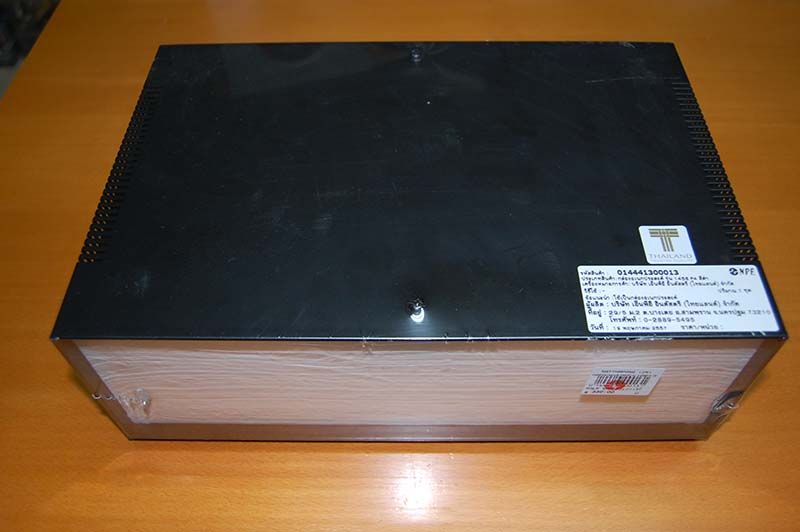

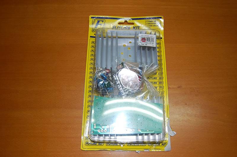

I found this at my local electronics outlet.
FK661 OCL 50W+50W stereo amplifier kit.
FUTUREKIT.COM :: HIGH QUALITY ELECTRONIC KITS - FK661: POWER AMPLIFIER OCL 50+50W STEREO R1%
Info here: http://www.funnykit.co.kr/bemarket/shin/menual/fk661.pdf

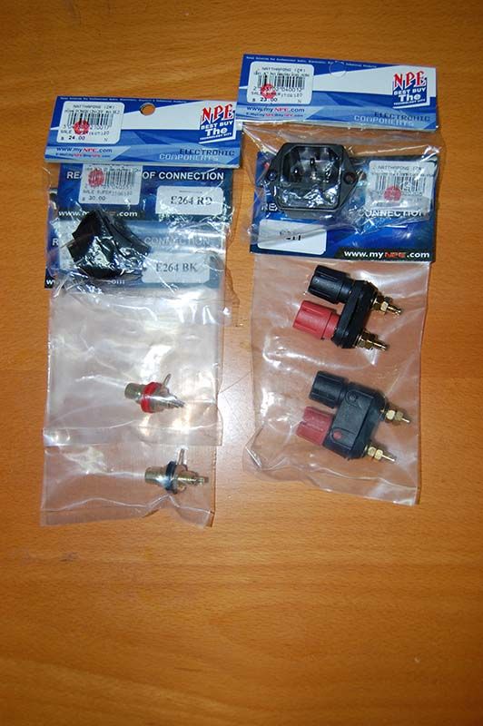

So with a little extra shopping I have pretty much all I need for a simple compact amp to use at my apartment in the big sand pit called Qatar! It should keep me occupied for a few evenings putting it together at least.
I'm not expecting much, well some noise at least though I'm guessing the "Fi" might be less than "Hi" 🙂
Here's what I have so far,
If I can source a suitable transformer I should be all set, already have a suitable bridge and some 22,000uF at 80v capacitors kicking about. My investment so far, a whopping £20, about US$34.
Any thoughts before I kick off?

Toroidal transformers seem almost unobtainable here so this is the arrangement I am planning.
Anything obvious I should think about or change from this basic layout?
A quick thought... but visual symmetry in layout, while it looks good, doesn't always lend itself to the best electrical layout. There will be a lot of wiring carrying high AC charging currents that are close to both boards.
Transformer and caps close together at one corner might be a better option from that point of view.
Also plan where you put your heatsink.. Output transistor jumper leads should be as close as possible. (I built one with long leads and it's doing fine, no hum but might as well be safe).
Thanks for the inputs. Heatsinks will be on the rear panel an I think I will mount the pcb's vertically on standoffs on the inside of the rear panel. This will give short leads to the output transistors and keep the boards as far as possible from the power supply.
I'll keep the psu toward the front of the case with the junction of the two smoothing capacitors as the star point ground.
