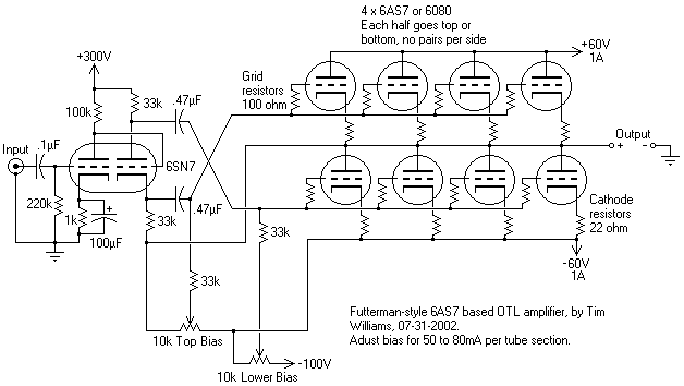

Can the Futterman style design for the 6AS7 be modified to use other tubes? if so what types?
What is the plate impedance of the 6N6P? 68 ohm? Is the symbol Ri for plate impedance?

Based on prior experience I would say your +/- 60V supplies are a bit too low, something on the order of +/- 100V - 120V is more likely the case. The Russian made equivalent of the 6AS7 works very well in OTL amps.
The symbol for plate resistance is rp, but don't be misled as there are other losses in the tube that are not directly reflected by the plate resistance such as limited emission, etc., that come into play particularly at high plate currents.
The 6C33, 6336A/B/C are also good choices and a single one of either will comfortably replace a pair of 6AS7..
Rather than substituting different types in this design I would build the basic design, learn how it works and then perhaps build another using more exotic types.
Note that I would not necessarily recommend an OTL as a first tube project which I suspect this might be. They look simple on the surface but getting them reliable and safe is an arcane art not easily mastered by a newbie.
The output stages require the same sort of power supply capability current wise as a solid state amplifier, but at much higher voltages to account for the voltage drops in the output tubes under load. Several amperes can be required for reasonable output power levels and it has to be well filtered as well because the design has mediocre PSRR - this gets very expensive.
Building a proven design as intended is a much safer bet.

The 6N6P tube has a Rp of 1.8kohm, not 68 ohm, 68 ohm is the cathode resistor value for typical operation, see here http://www.mif.pg.gda.pl/homepages/frank/sheets/113/6/6N6P.pdf
2 requirements that must be met by tubes in an OTL are low enough output impedance and to be able to handle high peak currents.
the output impedance for the inverted Futterman that is shown in the schematic has an output impedance which is Rp/(2(1+µ)) so with 6N6P we would get 1800/(2*(1+22)) which is 39 ohm, if we connect a few in parallel we could reduce this to a reasonable value that could be lowered even further by feedback.
The 2nd requirement is more difficult to fulfill, 6N6P have a max allowed anode current of 45mA and if we don't want to exceed that in operation it would give us very low output power.
For a push-pull OTL that works in class AB the average current of each tube is the peak current divided by PI so for 45mA average we would get a peak current of 141 mA, this would give an output power of ~80mW in 8 ohm. Doubling the number of output tubes would increase the utput power by 4 times and so on...
6N6P is therefore not a good choice for an OTL, 6080 variants are OK, 6C33C is better as with this tube you don't need more than 2 to get useable output power, (25W in 8 ohm).
Parallel connection of output tubes can give a lot of problems and should IMHO be avoided if possible, therefore the 6C33C is probably the best alternative for an OTL today

I do believe the 68 ohms is the subjested cathode resistor
and the plate resistance is 1.8K . By the way the circuite
you posted is not the Futterman it is the tecknics sp? variation
of the futterman. In the Futterman the top plate resistor
of the phase inveter goes to the top output tube and the
cathode resistor in the phase inverter goes to the botom
output tube. And as posted that circuite will have a verry
high output impedience.

By the way the circuite you posted is not the Futterman it is the tecknics sp? variation of the futterman
Yes as I wrote it is an inverted Futterman described in the schematic.
In the standard Futterman both tubes work as if they where cathode grounded and the output impedance is Rp/2
In the inverted version both tubes as if they where cathode followers and the output impedance and is Rp/(2*(1+µ))
And as posted that circuit will have a very high output impedance.
No, this circuit gives lowest possible output impedance of any Futterman variation, however I would change the value of the cathode resistors that should be in the order of few ohms.
