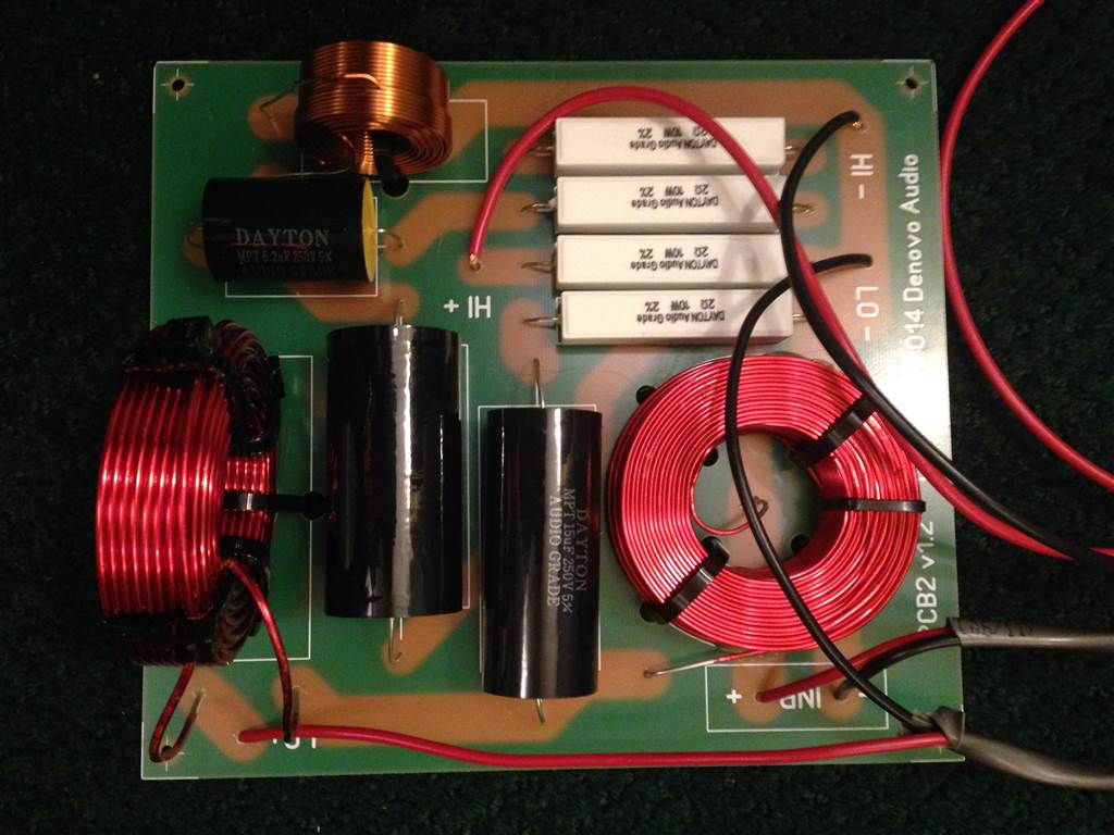

Purchased a bare bones Fusion 12 kit from DIYSG back in August 2020. Erich was able to provide me with a list of crossover parts but no photo or schematic of the crossover. My last email response from him was in August when he stated that he would provide some sort of assembly instructions for the crossovers. Have emailed several times since then but no response.
Wonder if anyone would be willing to share this information, privately of course. Would like to run this by Erich but I would not be asking for this if I were able to get in contact with him.

Hi Chuck

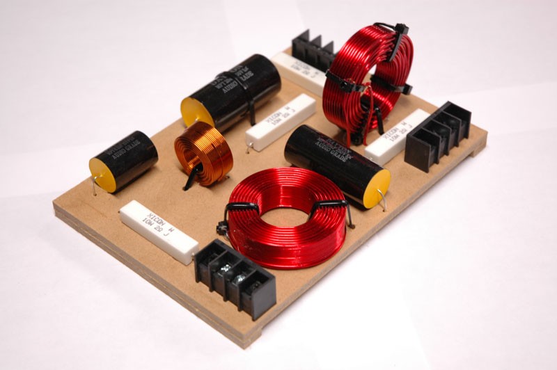

The network won't be difficult to figure out if you tell us the values ( or not ) of the parts you've bought.
I'm not sure why this shouldn't become open source now that JeffB. has passed away and the F12 ( Tempest ) has been superseded by the HTM line.
A quick overlook shows ( essentially ) a 3 over 3 ( poles ) with a handful of 2 ohm resistors ( 4 in total ) modifying horn level as well as modifying the Q's of the second pole in each leg ( both HF + LF) .
I have enough pics of the network to publish a partial schematic ( where you get to fill in the unknowns based on "best practices + a bit of logic" ) .
- ( the second pic displayed above quite clearly "telegraphs" the wiring order of the parts layout )

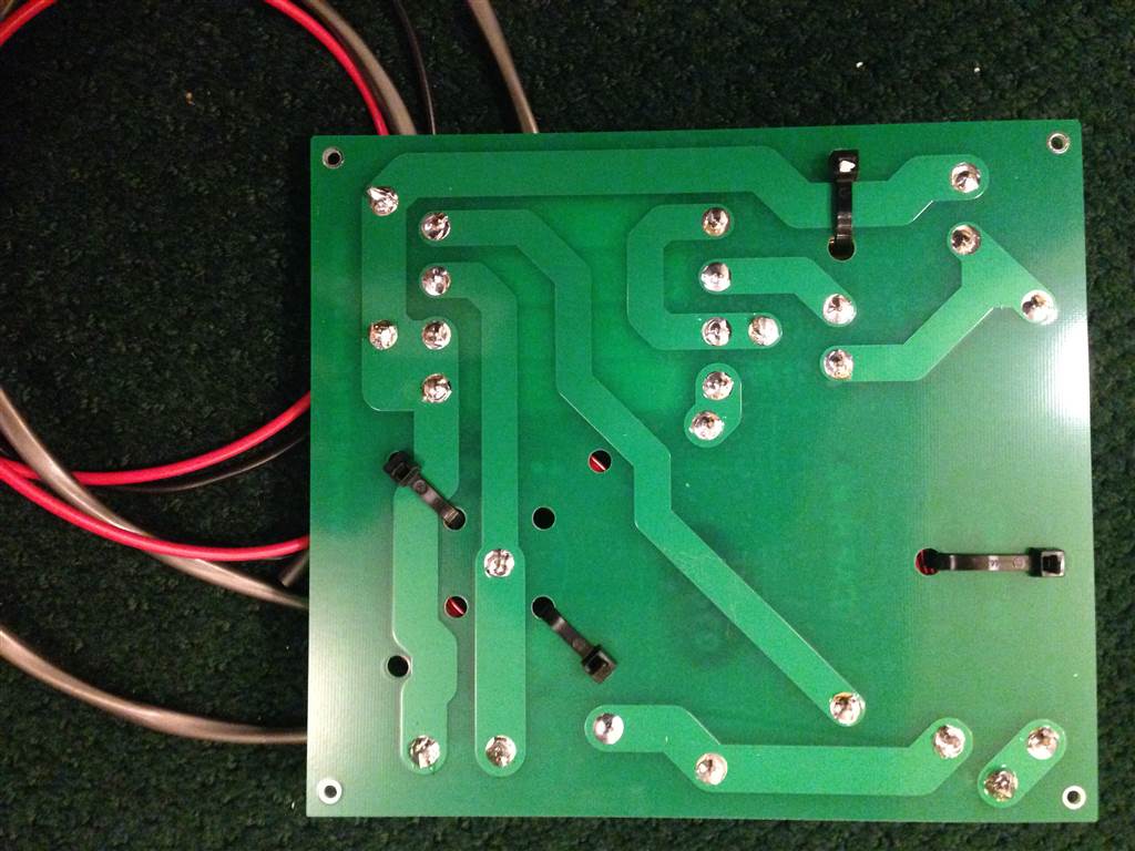

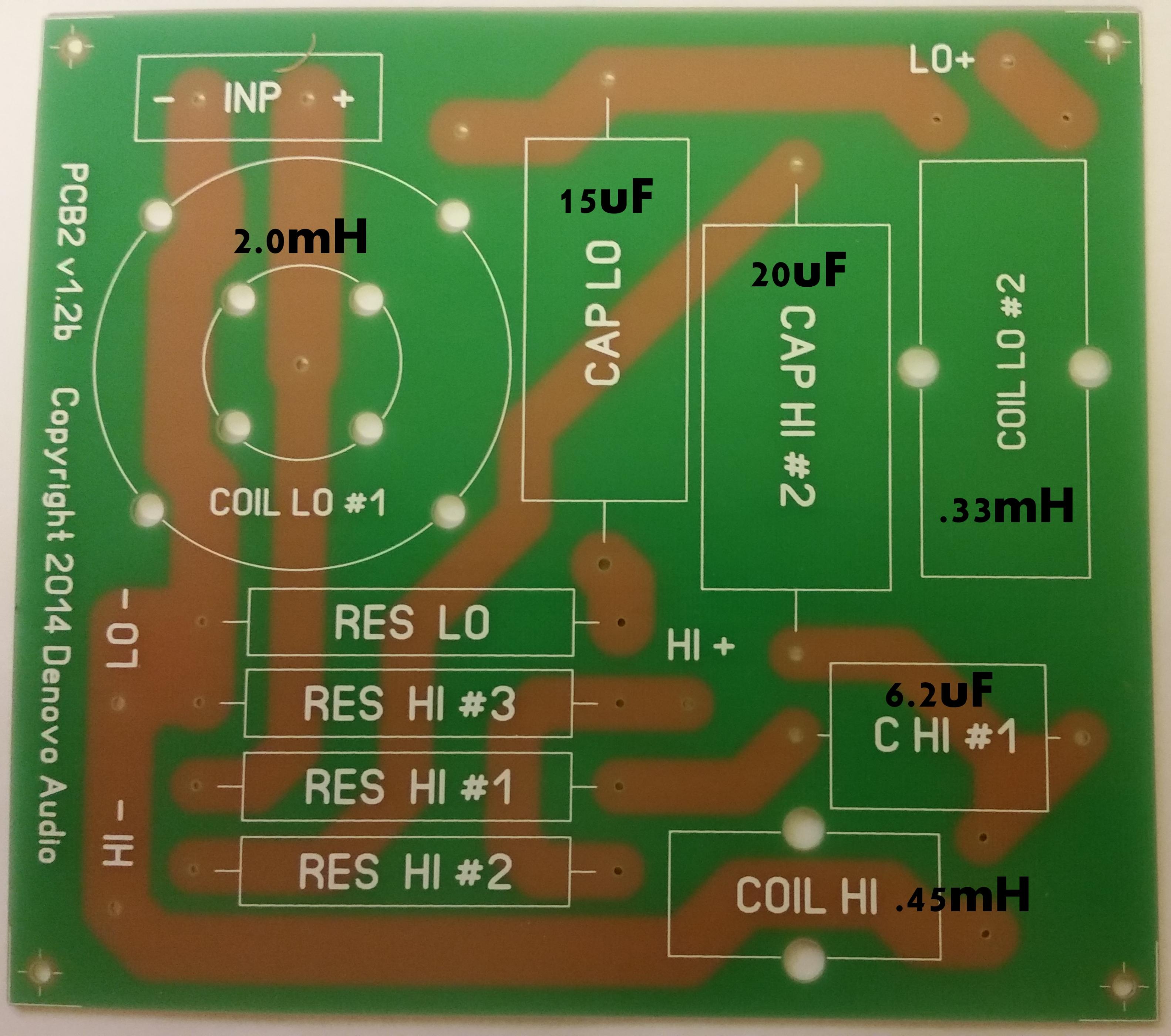

Thanks for your reply. Am attaching a photo of the crossover board I purchased overlaid with what I think are the correct locations for the components.
Most of the parts seem to suggest their locations by size as outlined on the circuit board.
The two large coils are similar in size. Based on diagrams of third order networks I have examined, the larger of the coils would be located first in series, closest to the input.
Your assistance is appreciated.
Chuck Sedivy
Chuck Sedivy
Hi Chuck,
Yes, you've placed/located the caps + coils correctly.
( The resistors are of course a "no-brainer" since they all have the same value in my pictures ).

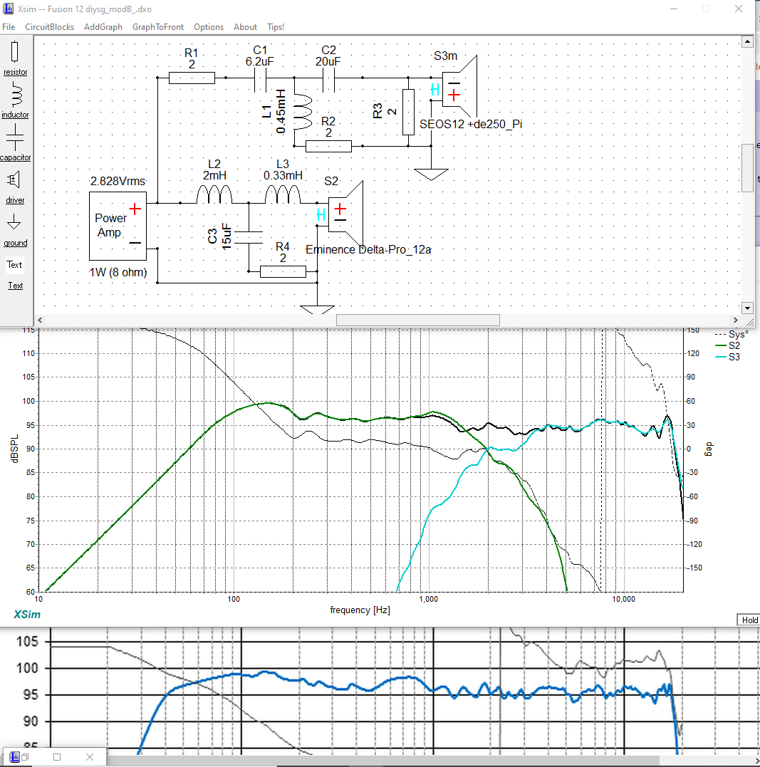

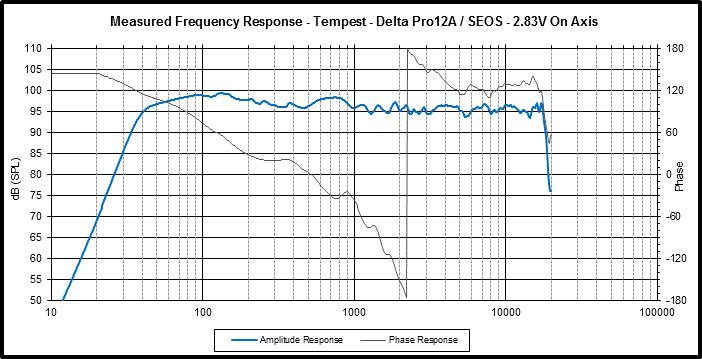

Here's the schematic as I understand it ( with FR ) using some available frds and zmas ( traced from available files ).
One can see that ( even with "borrowed" frd + zma files ) the response tracks quite well when compared to the official diysg response info ( seen at the bottom of my pic ).
PS, offset was set so that the horn drivers acoustic center is 3" behind the woofers.
Hi, I believe that the schematic for the hi pass
is mostly correct except there is no resister below the
.45mh inductor. Just put the 2 ohm resistor after
the 20uf capacitor in series. Also Jeff Bagby
ran positive polarity on the tweeter.

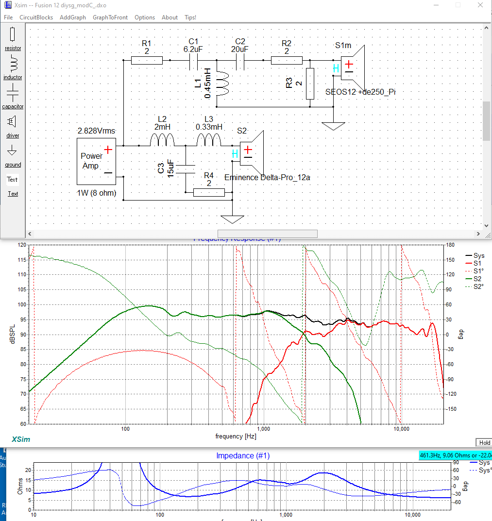

bathtub,
After staring much longer at the crossover board pic provided by Chuck, I must agree.
That makes the schematic look something like this;
This arrangement works very well as long as there's "little to no Acoustic Offset" between the woofer and horn-driver ( I had to guess at a typical number for a waveguide ).
This version also has better phase tracking ( something JB definitely worked at optimizing ).
