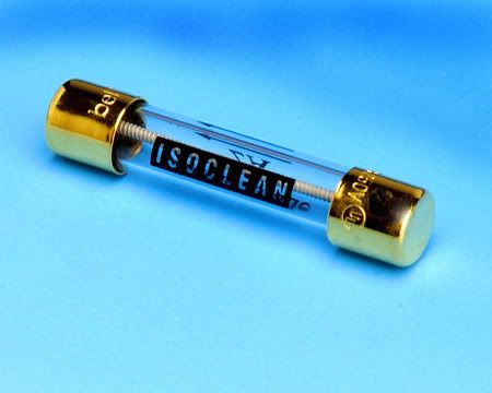

So I'm putting my preamp into its chasis today and I get to the fuse holders for the wall current. I'm hooking up 12ga from the wall and fairly large wire to the transformer and than there are the fuses. I installed 2amp glass tube fuses. the wire in it is tiny......Is this something that is considered? Is there a certain type that is better than another?
Take the VA rating and divide it by your nominal mains voltage. Multiply by 1.33. That's your fuse rating. Use a slow-blow fuse. If the fuse still blows on turn-on, install a soft-start circuit.
So for, say a 200 VA transformer running on a 120 V system, the appropriate fuse would be: (200/120)*1.33 = 2.22 A. So use a 2 A or 2.5 A fuse (standard values).

Thanks for the replies. I use a soft start...no blown fuses. I was more thinking about the bottleneck of the tiny wire in the fuse. Slo-blo fuses look to have a longer length of tiny wire coiled up in them. Thanks again...Evan
The real point is that a fuse is a very primitive, flawed version of the ideal current overload breaker - the one that has no series resistance or inductance but which trips out once a very specific envelope of time and current has been exceeded.

Under fault conditions you only want heat to occur in the fuse element. The idea is that the fuse in the plug should protect the cable.
Remember that a fuse does not blow at the current shown on it. This can be up to 1.5 times the rated current. Remember fuses have a voltage clearance as well as current this is why HRC links have sand in them to quench the arc!

Cables on mains should be double insulated, have correct colours. If the fuse is rated to close to running current it will mechanically fail due to mechanical stress. This happens when the fuse element heats and cools-expanding and contracting the element due the heating effect, then breaks. Just some trivia🙂
Mains inrush current sometimes called magnetisation current of the primary winding will cause fuse failure if the correct types are not used.
