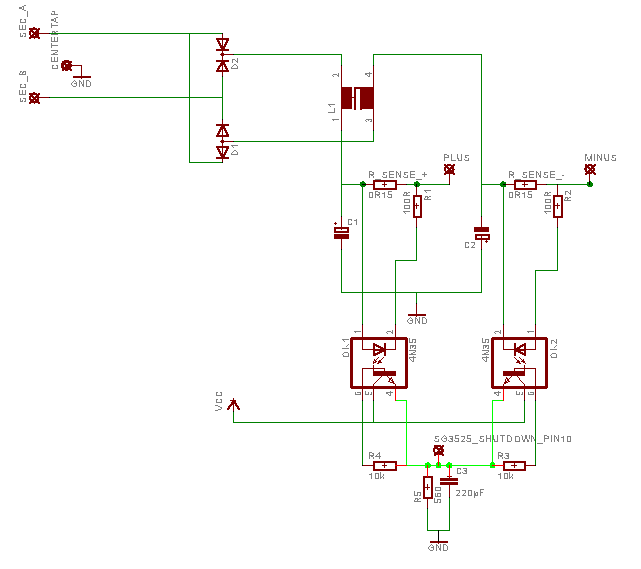

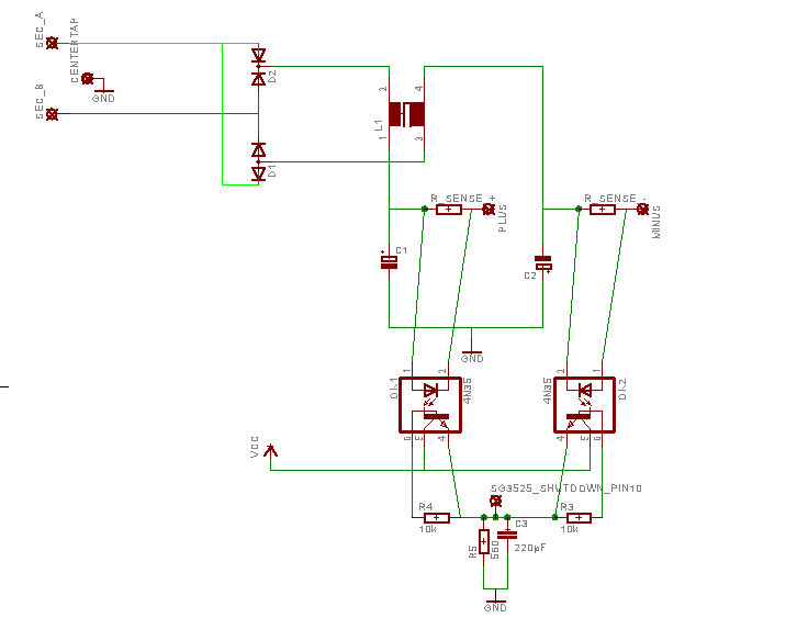

>My last attempt to avoid overcurrent situation was a transformer to sense primary current, but which no good result.
Which the way most easy to implement the protection in the secondary one of a symmetrical source (protection for both rails)?
controler is SG3525 that acept pulse-by-pulse shutdown.
A current sense resistor (or shunt) or a hall effect current sensor can be used for DC current measurement. Current Sense transformers can't really be used with DC. If you need to monitor both outputs independantly you would need to use seperate current sensors with separate comparators to monitor current loads. The outputs from the comparators could be OR'ed together to trigger a shutdown in a overload condition. ie IF A is overloaded OR B is overloaded than shutdown. You might need to slew the input to address startup current demand or short term current spikes during operation that could trigger false overload conditions. This could probably be addressed with low pass filters.
Hi
Don't place them before C, then R nd C will form RC low pass filter, but won't be good for ripple. And you need anywhere form 1 to 2 v drop on that resistor to open opto, when it will open you can burn it, since it has no current limit (resistor) for diode...

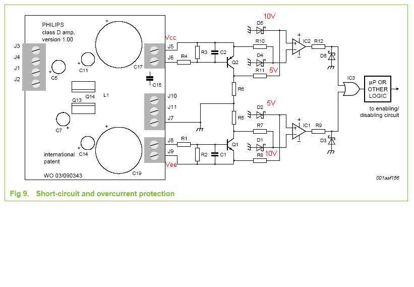

Another question:
Fuses at outputs would serve of protection?
10A at +- cables
I imagine that fuses at output open before output caps discharge suficiently and current at primary increases very.
10A at +- cables
Hi
Don't worry about primary current as it can be few times bigger then normal + you will hopefully have fuse there too. Output fuse protect output device in case there is something wrong, like short circuit at output of amp, if amp doesn't have any overcurrent protection. I wouldn't go without those fuses too.
eltonseemann said:Hi Luka,
correction:
If unless the current sensor resistor has a significant resistance (bad) , I don't think there will be enough voltage drop to turn on the Opticoupler LED. A typical current sense resistor has a voltage drop measured in millivolts. You probably need some sort of amplifier to boost the voltage. A small signal NPN transistor could probably work.
Yes, with the opto I will need ~1.2V to detect overcurrent
for 8A limit I will need Rs = 0R15
this will dissipate even 9,6 watt at 8A DC or 3,4% of power
this is the worst case... 1.2V is 3.4% of 35V rail.
for 4A load, loss are 1,7% or 2,4W
for 2A loss are 0,8% or 0,6W
BC547 VBe(on) is ~660mV, little more than the half, but of the same order of magnitude
