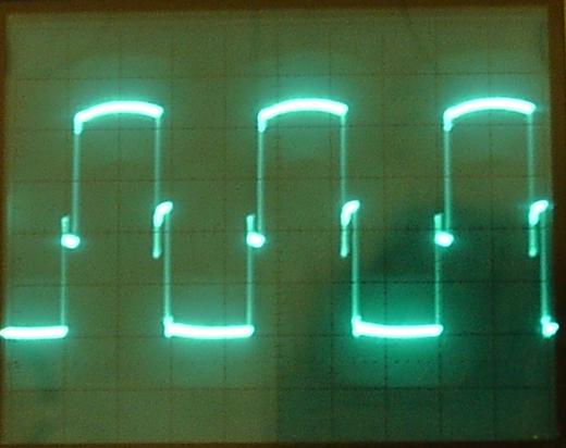

Well I thought to start of with a basic smps I would make one that could take 12(13.8)v and make +-15V @100mA. I get the required voltage at no load drawing 107mA from my psu and the output device start to get warm. So I did a bit of poking with the scope and get this as an output (see picture 1). Now if I put a snubber on the primary of the transformer I get (see picture 2) and the supply draw over 200mA of current and the output devices get very hot. 🙁

The first one looks quite ugly. The other a bit better, but switching devices should not get hot without a load in such a circuit.

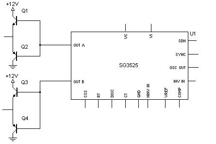

How have you wired those additional transistors?
Could you post a picture of your transformer and tell how it was wound?
Here's the switching transistors, the emitters go to the legs of the transformer.

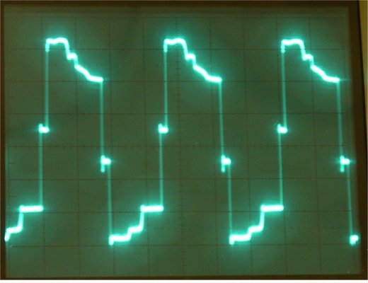

Well I tried putting the 100 Ohm resistor in the primary but it didn't change anything 🙁 . The file contains the pictures of the waveform, input 1 and output one are one channel and input 2 and output 2 are another. main output is the secondary and just for you Mr. Eva I took a picture of the transformer

Well, it looks like the magnetizing inductance of the transformer is in the low side and is playing games with the 1V deadband introduced by both your buffers and the buffers inside the IC. There are a total of four deadbands, that's why the output looks so full of stairs.
Also, the transformer is not saturating as the 100 ohm resistor would have changed things a lot otherwise, so remove that resistor. However, I recommend placing a non-polar 1uF capacitor in series with the primary winding just to be sure that saturation is not possible.
Try to place a load in the secondary side, either a single resistor directly across transformer terminals, or one resistor across each rectified ouput. Try to draw something like 50mA or +-25mA respectively. The waveforms should look much better with load as the interaction between magnetizing inductance and buffer voltage deadbands should be tamed.
Also, I recommend driving the transformer directly from the IC if your output current requirements are not too high. That would produce cleaner and higher output as two of the deadbands would be removed. According to the datasheet, the IC should be capable of providing 150mA reliably (something like +-50mA translated to the output).

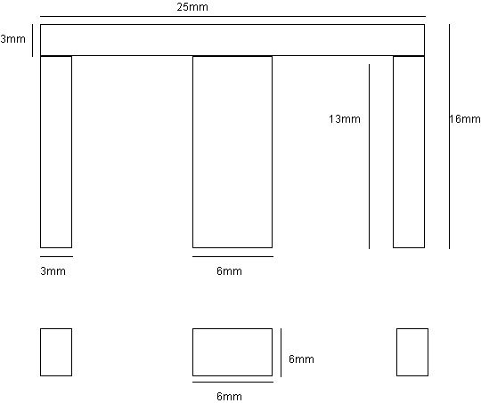

You have to determine how many turns are needed to drive the transformer at your voltage and frequency without saturating it. If you could tell us the cross-sectional area of the center leg of the core, we can made an estimation.

Then cross-sectional area is S=6*6=36mm^2=0.000036m^2
Peak flux for your full bridge symmetrical converter would be:
B=V*(0.25/F)/(N*S)
Solving for N:
N=V*(0.25/F)/(B*S)
Taking worst case values...
V=15V (assuming an automotive application)
F=54Khz (you are using a 108Khz clock, aren't you?)
B=100mT (reasonable level for most core materials)
N=16*(0.25/54000)/(0.1*0.000036)=19.3 turns
So your 20 turn figure for the primary was right (as long as you use a 108Khz oscillator).
