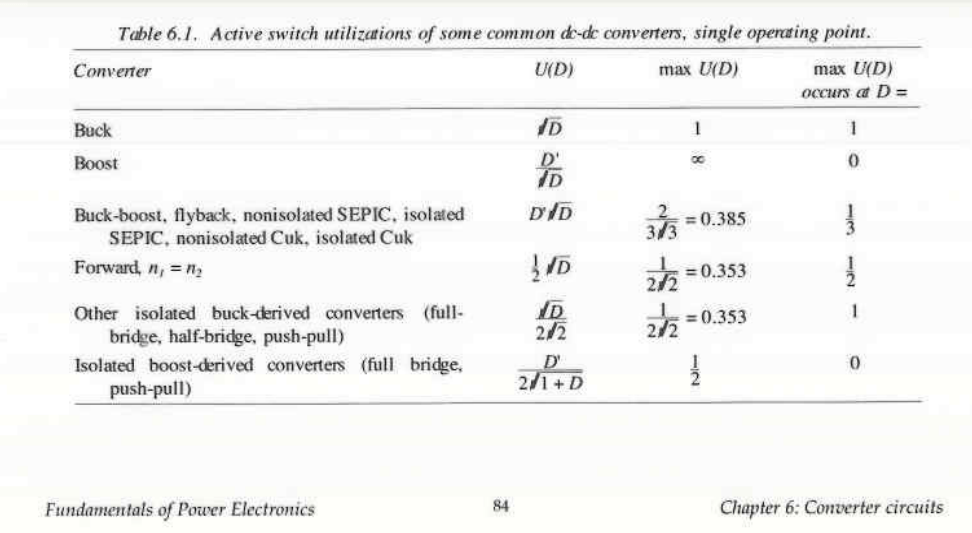

I have had a project for an offline switch-mode power supply for a multi-channel power amplifier in mind for a while
While I wait for my business to ease up so I can work on it properly, I have time to think it over, in particular how to make it electronically quiet.
Cuk converters are often discussed as potentially a less noisy option but not without problems, R. Half Plane Zero(es) for a start.
I don't think this is a major issue for an audio amp, transients are fairly slow compared to the switch frequency and the Power Supply Rejection Ratio at audio frequencies should minimise the problems.
But one issue is how much the circuit stresses the (transistor) switches, best expressed as the required switch capacity Vstress * Istress compared to the output power Vout * Iout.
Call this the utilisation, denoted U, typically a function of the duty cycle U(D).
I found a bit of discussion of this in "Fundamentals of Power Electronics" by Erickson, available on the Uni. of Colorado website.
But it seems to have a few mistakes, some of them probably just typos, others I'm not sure.
I have included a short extract, anyone know which edition this is from? Edit: Looks like it's the 2nd Edition
And if there is an Errata list, or if it's different in the later editions? Edit: Looks like it is different in 3rd edition. Not sure if just moved or edited and corrected.
The isolated Cuk looks fine for utilisation of the switch, actually a fraction better than the more common (isolated) Full B. or Half B. if the table is correct...

A resonant LLC FB is one of the more obvious options but has it's own trade-offs.
It pumps around reactive power so that the stress on the transistors is worse for a specified output power, yes?
Do not try Cuk. It's...very peculiar...
Cuk is "peculiar" is kind of an uninformative statement.
It looks easy to do a Zero Volt Switched CUK to reduce the switch loses and EMI.
It would have the benefit that the switch transistor is low side so no driver ICs to worry about.
And only one switch transistor so potentially simpler and more reliable.
It looks so nice that I am a little suspicious that it's not more common, hence the thread here.
But I'd like to analyse it from solid fundamentals like power out versus power switched rather than just because it's called a bad name.

To return to the reason why I started this thread, can you or anyone else explain the apparent errors in Erickson?

You are correct, form factor of a 50/50 PWM is equal to 1.
However, as mentioned, conduction losses of newer devices like trench Si and SiC fets
are a small part of a total ones, thus small increase of conduction losses yields significant decrease of a switch ones.
That's said ZVS gives twofold gain:
1. Total losses are less, despite the "poorer" form factor of a current/voltage etc.
2. Harmonic content of a) voltage across the switch b) current in rectifier (sync switch) is better.
You may have no diode recovery losses as well. Lower noise, easier filtering and so on and so forth.

I think there is no problem to have a quasi resonant Cuk converter with ZVS switch-on.
A resonant circuit like the LLC buck can also have ZCS switch off and trade lower switch-off losses with worse form factor.
My suspicion is that at lower frequencies the trade-off may not favour the LLC, simulation will tell.
An LLC Cuk seems possible, is attractive intuitively.
Dr Cuk himself has done work on this and there's a bit of published analysis that I need to look at and think over.
The fact that it isn't commonly used may be a clue that there's problems, or perhaps just that the world is slow to catch up.

So your typical solution is a boost PFC before the LLC (HB or FB), then transformer and secondary rectification.
1 PFC boost transistor+ 1 PFC controller +1 boost rectifier diode.
Then the buck LLC section.
2 or 4 LLC transistors, half are hi-side so 1 or 2 hi-side drivers + 1 LLC controller + 2 or 4 secondary rectifier diodes.
Cuk can do boost and buck so has
1 switch transistor + 1 controller + 1 secondary rectifier diode.
Even the simplest LLC option (Half B. with centre tapped secondary) has 3x more transistors, 3x more diodes, 2x the controllers and has 2 hi-side drivers that Cuk doesn't need.
The transformers will be practically the same, as will most of the other stuff.
Cuk liked KISS too, that was kind of his point.
The other point is that all the extra transistors and ICs and controllers and diodes eat power and waste efficiency.

I had a closer look at this and noticed that the author discusses how to select the main capacitor value to exploit resonance, just as I proposed.
Nice, thanks!
It looks like a PDF of a presentation, a bit hard to work it out without the spoken explanation but a clue to the correct direction.
You have any more information or ideas on this?
