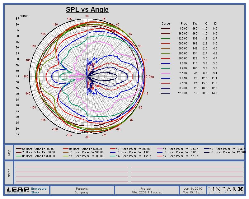

Here this might help you visualize what happens. Here is a software generated polar response on a 12" woofer.

Thanks Robh3606. I guess what I'm really trying to understand is the dynamics of the wavefronts... and how they pertain to baffle design and baffle treatment.
Think of pressure waves being launched from every point on the diaphragm. If the diaphragm is larger, the distance from each point to your ear can vary by more than if the diaphram is smaller. When the wave from one "point" arrives so late that it has delayed by half a wavelength (pressure forward becomes pressure backward) relative to the pressure wave from another point, the opposite pressures from the two points cancel and no net pressure is left. At lower frequencies it takes a larger size (and difference in travel distances) for this kind of thing to happen. (this is a rather simplistic view, but I think contains the essence). WHen you are directly on-axis, the distance to every point is "most equal"
For the baffle, look at it slightly differently. Imagine a pressure wave going across the baffle. It can't go into the baffle, since that isn't compressible, so it rides out across the surface. Until it reaches the edge, where suddenly it is able to be relieved by going around the edge. This is equivalent to a pressure wave of inverse polarity being launched at the position of that baffle edge. The pressure there is reduced, which is the same as suddenly adding an inverse pressure to a non-inverse pressure. So that negative pressure wave propagates toward the listener as if it were another source. And of course, the distance from the driver to the edge will have different effects (launch an equivalent wave of different size and phase shift) depending on the frequencies of the wave being discussed.
One of the things I'd like to know (or preferrably understand😱) is whether the baffle receives some of these higher frequencies so that diffraction treatment is necessary. I suspected that the beaming meant there was no sound going sideways like that but from what you're saying, I'd guess there is?
I think you're saying that these point sources radiate omnidirectionally and the lobing is all about cancellations.

That app helped me to "see" what was happening. It does look like the points are omnidirectional and the beaming has to do with cancellation.
(Just thinking aloud) looking at Robh3606 plot it looks like anything above 4K doesn't have any energy at 180 degrees and anything below 640Hz is fully omni.

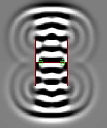

Don Hills, is it possible to use this wave simulator to show a horizontal cross section (looking down) on an 'H' frame?
Yes. Like this:

Note that the simulator only has monopole sources (point source or plane source). In order to simulate both sides of a speaker cone, you need two plane sources close together with a wall between them corresponding to the width of the cone. The sources have to be 180 degrees out of phase (the "Phase Difference" slider is all the way to the right).

Hmm, educational. The H frame seems to work well at low frequencies but at higher ones it suffers first from reflections off the inner walls, then diffraction off the tips.
OK, so maybe that was obvious. Seeing it really changes a person's mind. My first reaction was to want to burn them. I think I'll be damping the inner edges from now on. I think this may explain something about the sound.
Thanks all, I'm starting to get the hang of this.
In loudspeaker design you need to look at EVERYTHING with the relevant wavelength in mind. Almost nobody would use a H frame above the quarter wavelength of the front and back cavity. That means: At the upper frequency limit the cavity would inclose a quarter wavelength.Hmm, educational. The H frame seems to work well at low frequencies but at higher ones it suffers first from reflections off the inner walls, then diffraction off the tips.
... I think I'll be damping the inner edges from now on. I think this may explain something about the sound.
With the presettings of Rob his model will inclose 2 1/2 wavelength (that's 10 quarter wavelength). You need to draw the frequency slider far to the left before you get a realistic impression. No need to think about damping inner edges.
