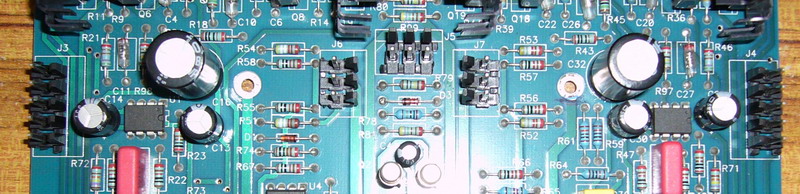

There are 2 opamps per channel on the driver board in my McCormack DNA0.5 amp. The one on the left is AD712 and the one on the right is NE5532. I've tried to go through the PCB trace but it look quite complicate. Don't know if these opamps function as DC-servo or not ???
If it does, will I get any improvement changing over from NE5532 to OPA2134 or OPA627 or it just a waste of money ?

One op-amp, the 712 from memory, operates as a DC servo, the other is the error amp for the regulator for the driver stage.
I wouldn't change these willy nilly if I were you. The servo amp will need to have good DC parameters for a start and should be fet input. BTW it is a dual op amp.

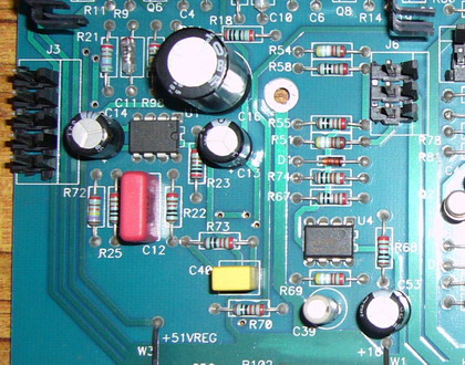

Close Rob, but not quite.
The AD712s (U1 and U2) are used as DC servos. They control the output DC offset to better than 1mV worst case and are difficult, but not impossible to improve on. The particular circuit topology used means that the opamp has less effect on the sound than is usually the case with DC servos.
Then there are two NE5532s. The LM833 opamp was also used in some versions.
The first (U3) is used to monitor the supply rails and senses if any of the supply rail fuses have blown. The second (U4) uses the first half of the dual opamp to sense any excess ouput DC offset while the second half sums the two error signals (blown fuse and/or excess output dc offset) and turns on a two relays if a fault condition occurs.
The relays mute the inputs and so ,hopefully, everything including yr speakers are protected ...
The supply rail monitor is isolated from the rail by 100k resistors so its hard to see that opamp effecting the rail. The dc offset monitor is isolated from the by resistors taht are 20x bigger than the one in the actual dc servo, so again, it is hard to see that having much sonic impact

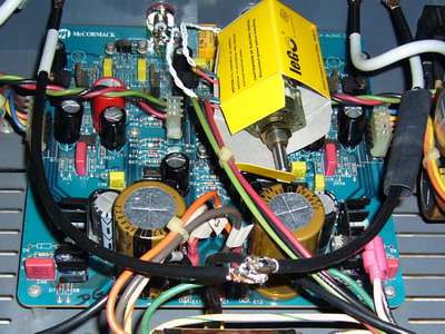

Here is existing condition of my driver board, noting morethan changing caps and mount the 10k attenuator directly between RCA & Driver board, what else I can do to make it sing better ?
Is is worth changing a rainbow cable that connect between driver & output board to a better one ?

I would leave the monitoring opamps alone. Those are U3/4. You could look for an improvement over the AD712 but I think your money is better spent elsewhere for there reasons outlined above.

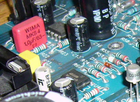

First, there will be a capacitor that corresponds to C13 on the other channel. Sorry, I forgot that.
The schematic shows just C13, but labels it as 0.1 to 10uF. So what you are seeing may well be a film cap of 0.1uF in parallel with a 10uF electrolytic. This would seem a reasonable compromise although the actual values are too far apart to prevent parallel resonances problems. These would only be obvious if you went looking with a network analyser.
Typically, you should parallel capacitor values that are separated by less than a factor of 3. This is not what is usually recommended in these DIY circles, but works best in my experience with the modern world with its EM fields.

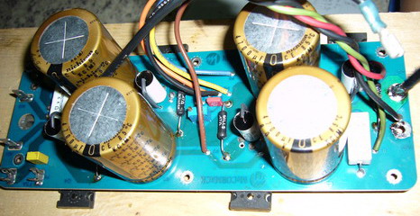

My apologies. The biasing network is on the output board - those are the two boards bolted to the heatsinks. So the cap in question is C13 on both these boards. The C13 that you are looking at is on the input/driver board and is the power supply decoupling cap for the negative rail of the DC servo.
Thanks very much Alan.
Sorry for confusing you, it doesn't have any mark on the pcb for a small cap. only for a large eletrolytic decoupling cap C1,C3,C5 and C7. But I believe the red wima cap on the middle of the board should be the one you talk about.
