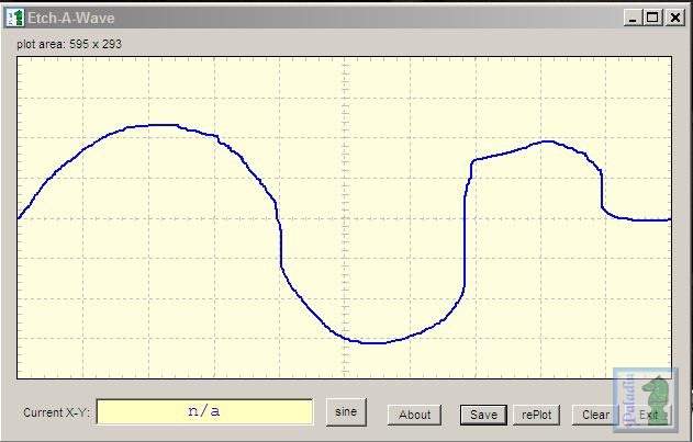

The PCGU1000 can also function as an arbitrary wave generator, in fact quite arbitrary--here is an Etch-A-Wave application I created for a client:

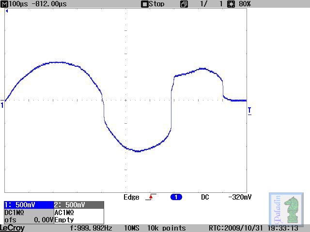

Here is the created wave, as reproduced by the PCGU1000:
Waveforms can also be captured from other instruments capable of exporting CSV of other usable data files, converted to the PCGU1000 wave library format, and then reproduced at any desired frequency by the PCGU'.

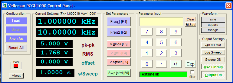

If you get one you may like to use the alternate front-end I developed, based in part upon my late departed WaveTek 1288's front panel:
