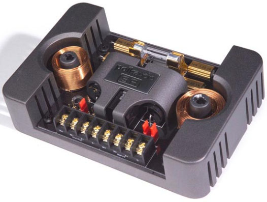

Anyway, I want to correct a problem with the crossover design and it is that the air core copper inductors will release from the circuit board (ie the bonding agent, whatever it is, fails after time).
So, as a frequent DIY home auto mechanic also, I was wondering if applying a bead of clear RTV where the copper inductor meets the circuit board would be OK? Most certainly, the RTV can handle the temperatures, heh (-75F to 400F). And, it will bond securely (I use the stuff for tons of difficult to "stick together" substances).
Lookup Permatex product #80050. The link is: Sealants : Permatex® Clear RTV Silicone Adhesive Sealant.
Let me know what you experts think. I attached a photo of what the xover looks like. Each xover has two air core inductors that I would like to fully lock down.

I use a small amount of (two pack) epoxy resin (glue) to hold them in place, with great success.

Make sure you use a neutral cure RTV. Some of the more commonly used versions have a highly acidic cure, ie they give off acid fumes in the curing process. You will find this very corrosive to copper. Need to find the ones specifically intended for electronics assembly.

If you were building from scratch, I'd say "cable ties, threaded through holes in the board under the coils." For the ones you pictured, I'd use neutral cure RTV or hot-melt glue.
That one is of the acetic variety, it is not suitable. You should use a neutral one (alkoxy or methoxy)Lookup Permatex product #80050. The link is: Sealants : Permatex® Clear RTV Silicone Adhesive Sealant.

I think what he implies is that the inductor coils are copper, but enamel coated for insulation resistance. This prevents the turns from coming in electrical contact with each other. So although it might look like you are gluing copper to the board, you are actually gluing the enamel coating which thinly covers the copper.

if you goop your crossover coils with the stuff your considering you may end up with shorted or partially shorted turns in these inductors the corrosive nature of the rtv as it cures also leaves behind resistive crap.your x-over will work but probably not at the right frequency.
i'd do a visual inspection of the solder joints on the board
with a tweeter cutting out i'd check capacitors

i might be making an assumption but are you trying to glue the coil to resolve a problem like cutting out or popping audio? as a service tech i've seen many an easy repair made impossible with the liberal application of all kinds of stuff epoxy, silicone,crazy glue...
you may want to explore more serviceable solutions like cable ties to hold the coils to the board...
in as far as glue guns the high temp industrial grad glues are safe(as in they won't hurt your enameled wire coils)but watch out for the tip it does get hot enough to damage enameled wire!(personal experience!!)
