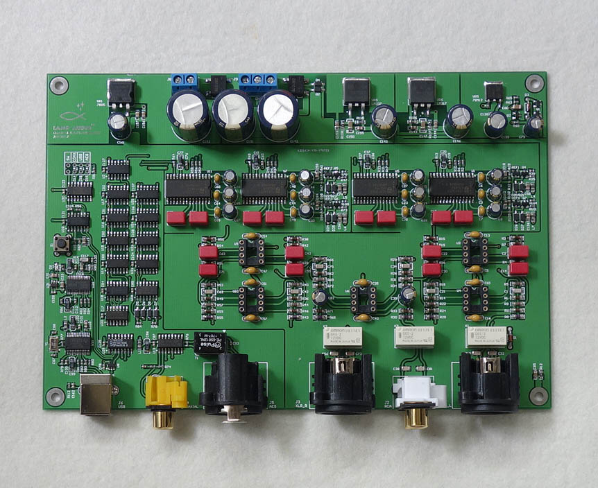

A friend dropped off a DIY DAC based on stuffed PCB he purchased off of eBay, see attached picture. Unfortunately the DAC has developed a defect, one channel (left) drops out and distorts quite badly, which is why he asked me to repair it.
I looked it over, checked voltages etc. swapped out the opamps just to be sure, but the defect persists.
Currently I’m looking for a schematic, as without that it will take me hours to draw it up from the PCB. So if anyone has more info I’d appreciate hearing from you, thanks!

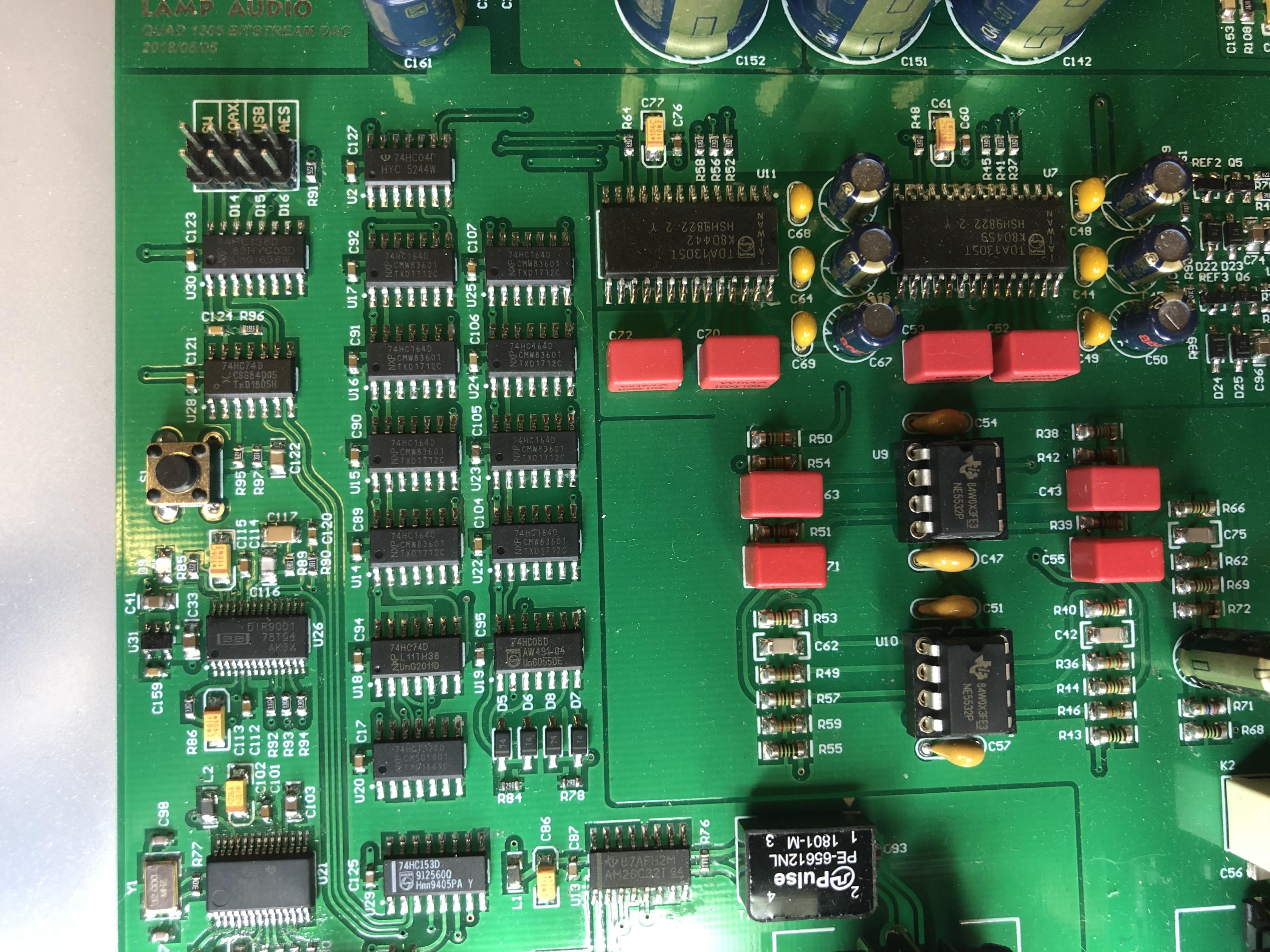

I'm intrigued by the array of 12 SOIC14 chips on the left hand side - is it a FIFO array or some such?
The rest of the circuit is easy to follow from the layout surely? 4 DACs and filters in the main section, 2 DACs or ADCs on the TOSLINK-S/PDIF section bottom left. You don't need a schematic, just the pinouts for the important chips so you can follow the signal path.
