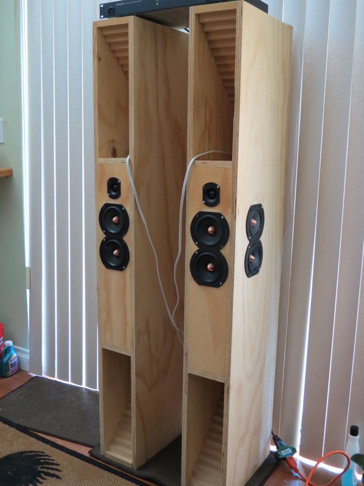

I'm awaiting my greenish lumber to stop shrinking before making sawdust for this experiment.
I'll be making a stereo pair of fllorstanders, with about 1.6ft3 per Alpair 12PW.
These will be mounted in push pull to on each side of the cabinet, about centred about 55" off the floor.
The outboard magnet will be closest to each sidewall, to somewhat limit high frequency early reflections. The other 12PW will be conventionally mounted.
On the narrow forward baffle will be an isoplanar tweeter, crossed first order around 3000 Hz, shallow slope.
The hope is an asymmetrical near omnidirectional playback, for an immersive soundfield, without a treble that does much more than localize the bipolar off axis sound at the listening position.
I can run with active crossovers for this, but hope to get by with only passive filtering on the tweeter. Active or passive, I'll be using individual amp channels to each driver or driver grouping. (One RT2II, 2 Alpair 12PW per speaker)
I've experimented in the past with extending the lower limit with transmission lines, so the internal height of the cabinet will be the same as the resonat frequency quarterwave or the MarkAudio pairs, but will leave the opening sealed for starters. I've also chosen a cabinet volume easily port tuned for the resonant frequency of 38 hertz, but would prefer sealed.
Anyone seen anything similar I could refer to? They are tall, but take up much less real estate than my current dipole/horn hybrid sub augmented rig.
I'm hoping for accurate, but not ground penetrating bass in my apartment, along with some of the spaciousness I currently get with the oversized system.

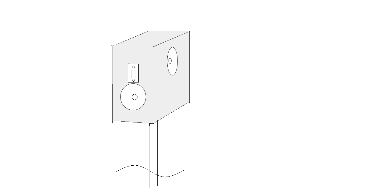

Is this kinda like what you had in mind? I really think active cross-overs effectively erase all those phasing issues...a real problem child..
The side-firing driver can be dialed in according to 'sound-stage' preferences.

I'd also view the extra woofers from the point of view of baffle step. Have them compensate, and prefer that it happens below that frequency where the drivers start to become more directional on their own than the baffle.
However, if used nonchalantly it can be worse.I really think active cross-overs effectively erase all those phasing issues...
