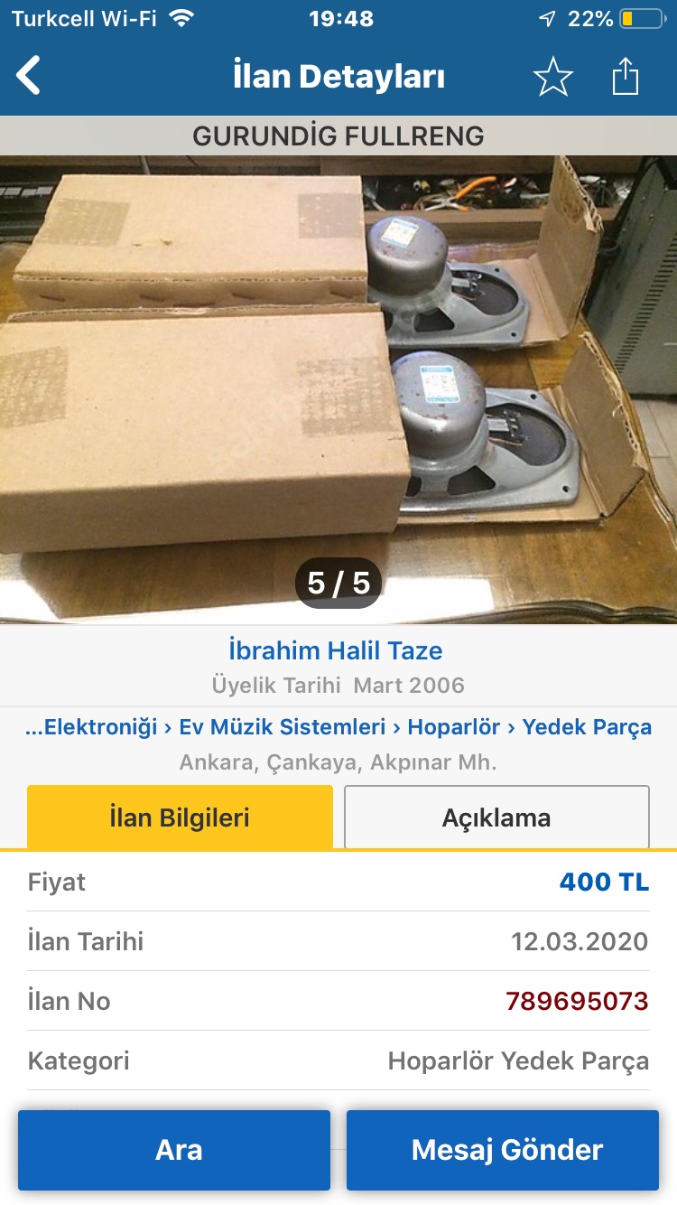

the project which l want to make ,doesnt accept 32ohm fullrange driver so l decided to built anew cabin for these 32 ohm grundig drivers,
is it possible to use these cabins with a normal solide state amp8 ohm

Nothing, as long as they form an appropriate load for the amplifier concerned.
32 ohm drivers are manufactured to facilitate series-parallel wiring in multiple driver systems such as pro audio line array and column array applications.

He certainly can, if he can accept a drop in power.
I note vintageyear says his solid state amplifier is rated into 8 ohm. Since power is inversely proportional to impedance, a 32 ohm load will receive only 25% of the power that an 8 ohm load would.
Even less power will be available at bass and high frequencies where the impedance will rise substantially above the nominal 32 ohms.
However, provided vintageyear's amplifier has a sufficient reserve of power, it is OK, and quite safe, to run a single 32 ohm driver on each stereo channel.
