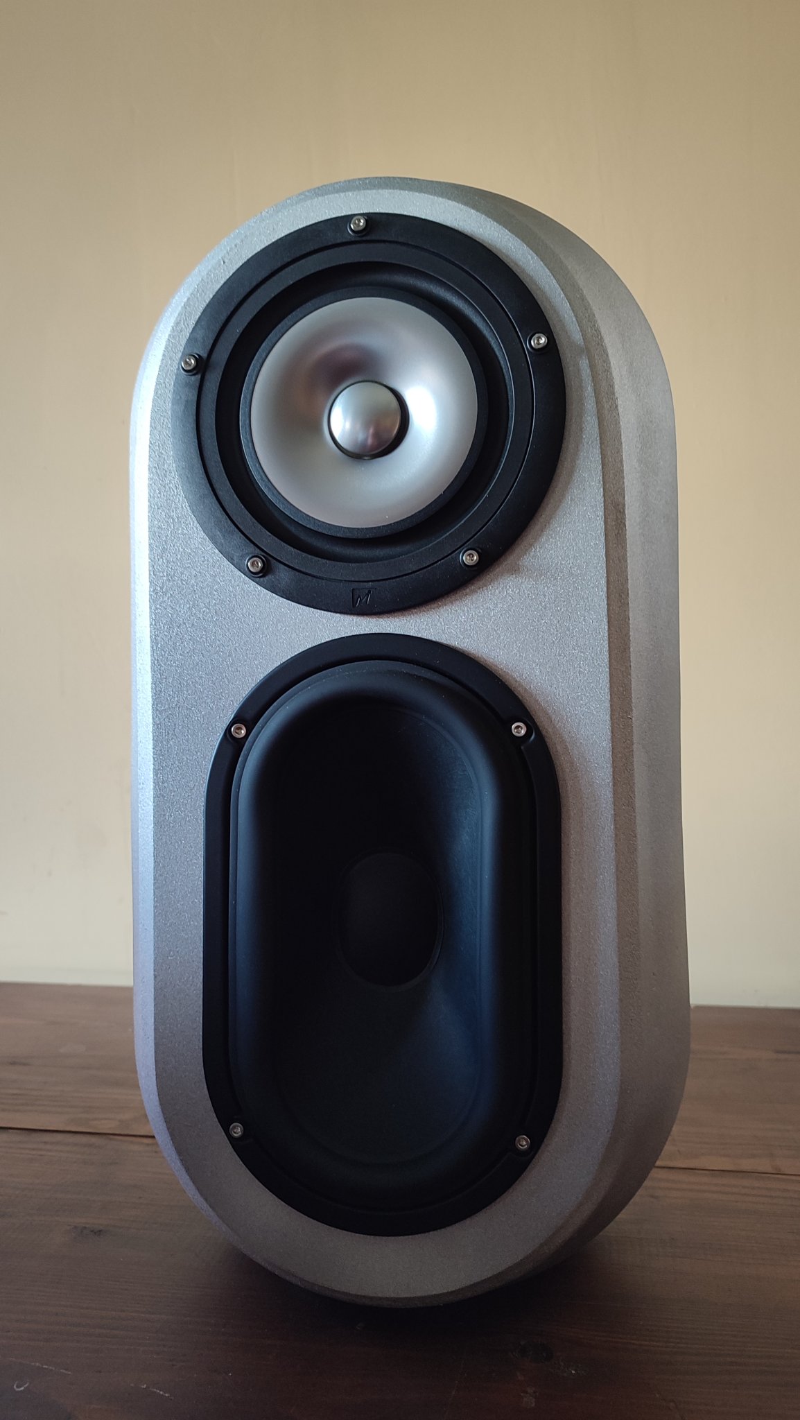

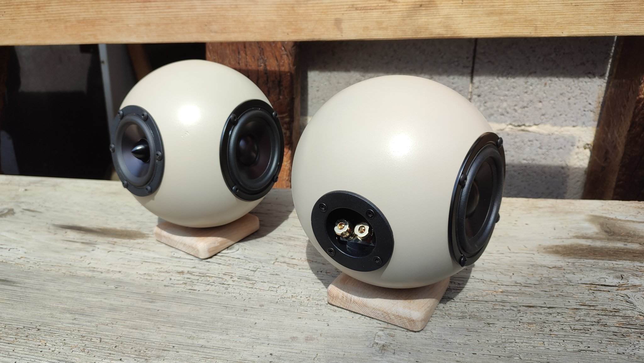

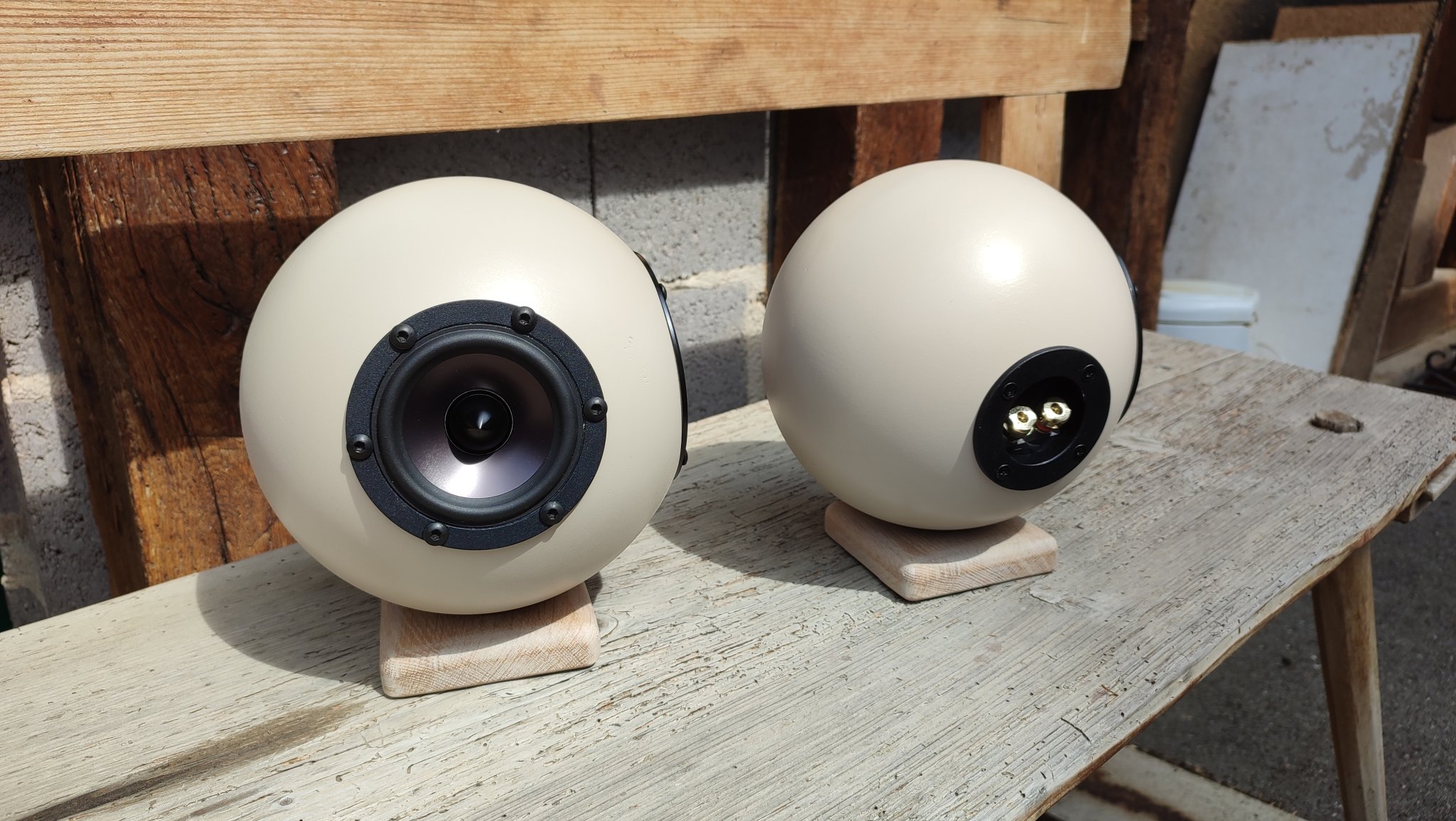

Hello, I'm wondering, because I didn't saw much of this kind of speaker here. I mean compact speakers with a fullrange and a passive radiator. Is this something completelly off the charts ? Something not effective at all ?
Here are the two projects I made around this idea.
-Spherical enclosure made of blanda bowls (2.4L inside) ;
-Dayton Audio RS100-4 fullrange driver direct wired and no filter;
-Dayton Audio DSA115 Passive radiator.

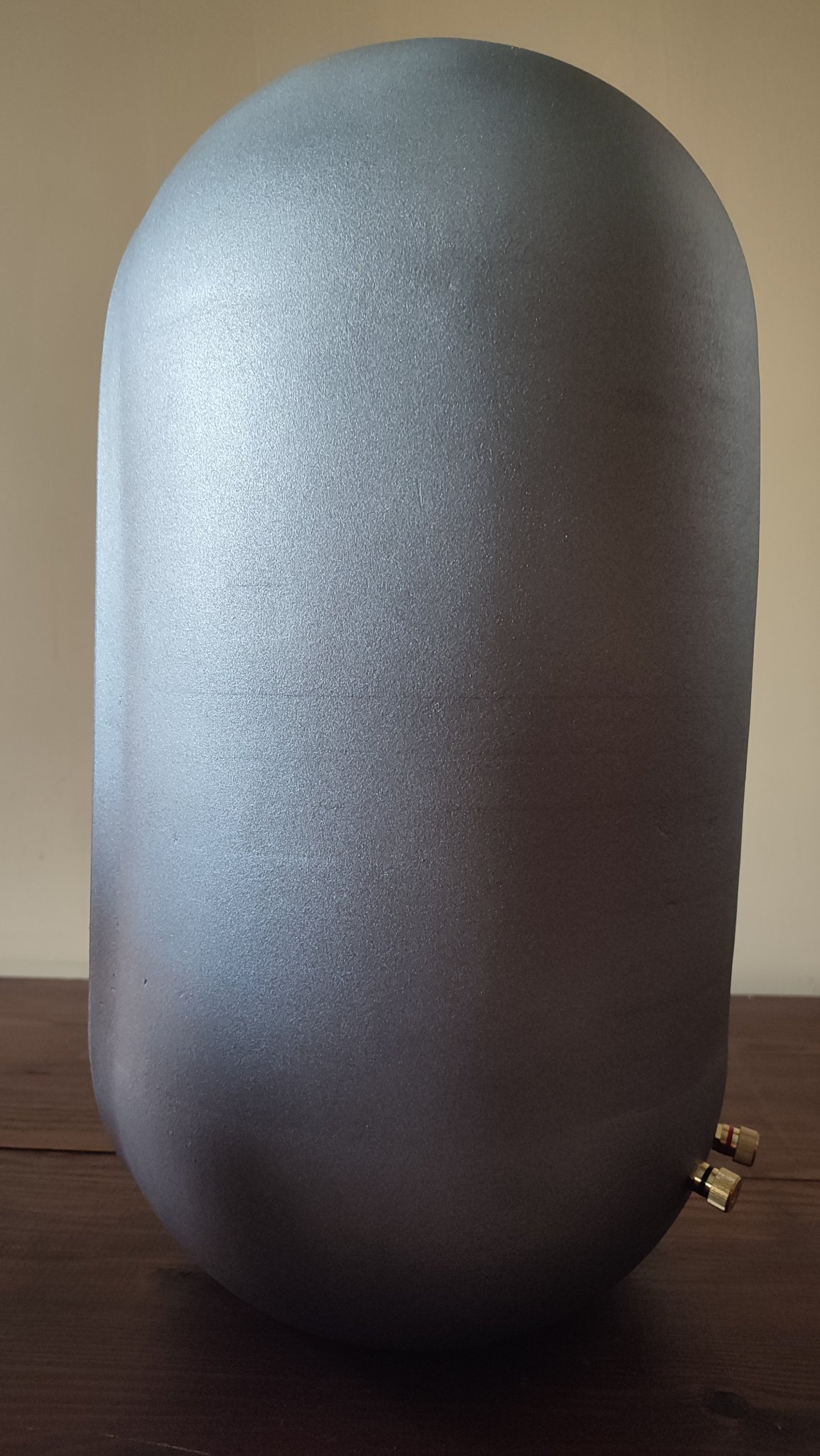

-Pill shaped enclosure made of blanda bowls and layers of MDF (8.6L inside);
-Markaudio Alpair 11MS fullrange driver, direct wired and no filter;
-SB Acoustics SB15SFCR-00 5'' x 8'' passive radiator.

The pill shaped speakers are some of the most original (styled) speakers I've seen, well cool.
A PR is just a vent substitute (with an additional suspension resonance).
Usually used with a small box and a vent that would otherwise be too long. That would not be the case with the pill shaped one — as cracked case says, interesting shape.
Here the 9 litre CGR for the A11ms, you can see the vent is not overlong.
https://frugal-phile.com/boxlib/P10free/CGR-dMK11-180820.pdf

Thank you Dave, the exemple of enclosure sent is more compact than I thought. It has a 105mm port, on which frequency it is tuned ?
I tried with 41.3Hz and the calculator gave me a result of 42cm long and 5.7cm diameter port. Which was too long for me.

Hello and thanks @mayhem13, it sounds good to my ears, but I don't have the measurement tools and I'm struggling for building the second one to have a pair.
I can compare it to a similar speaker I made with the Dayton Audio PS180-8, the DA speaker is clearer on the high frequencies and the sensivity is higher.
