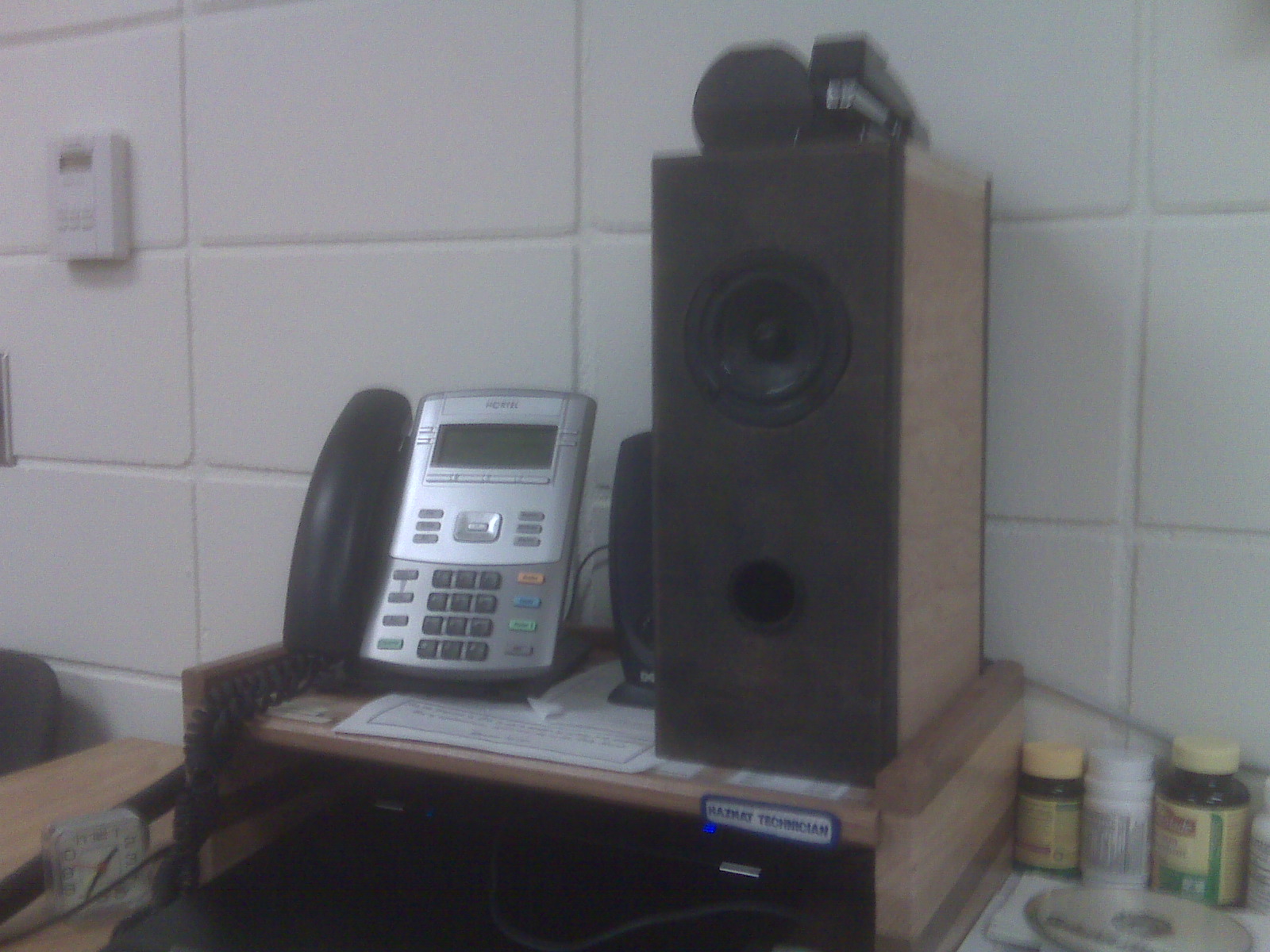

why not do away with the small stuff and go for a fonken build? i have mine currently being used in a nearfield config where they are sitting on my desk at school. nearfield they are rather beamy but if you can place them well and just move them around to taste you can get an amazing sweet spot with mind blowing accuracy. i have the speakers on stands which are standing on spikes and the bass is more palpable. earlier it was draining into the desk and just making that shake which is cool when im writing stuff or working at the desk but not so much if i am just sitting back and listening to the music. great pair of speakers.
ive heard the ufonkens on one occasion and while the midrange was excellent, the bass was necessarily absent. then again, depends on what you are trying to get out of your speakers.
