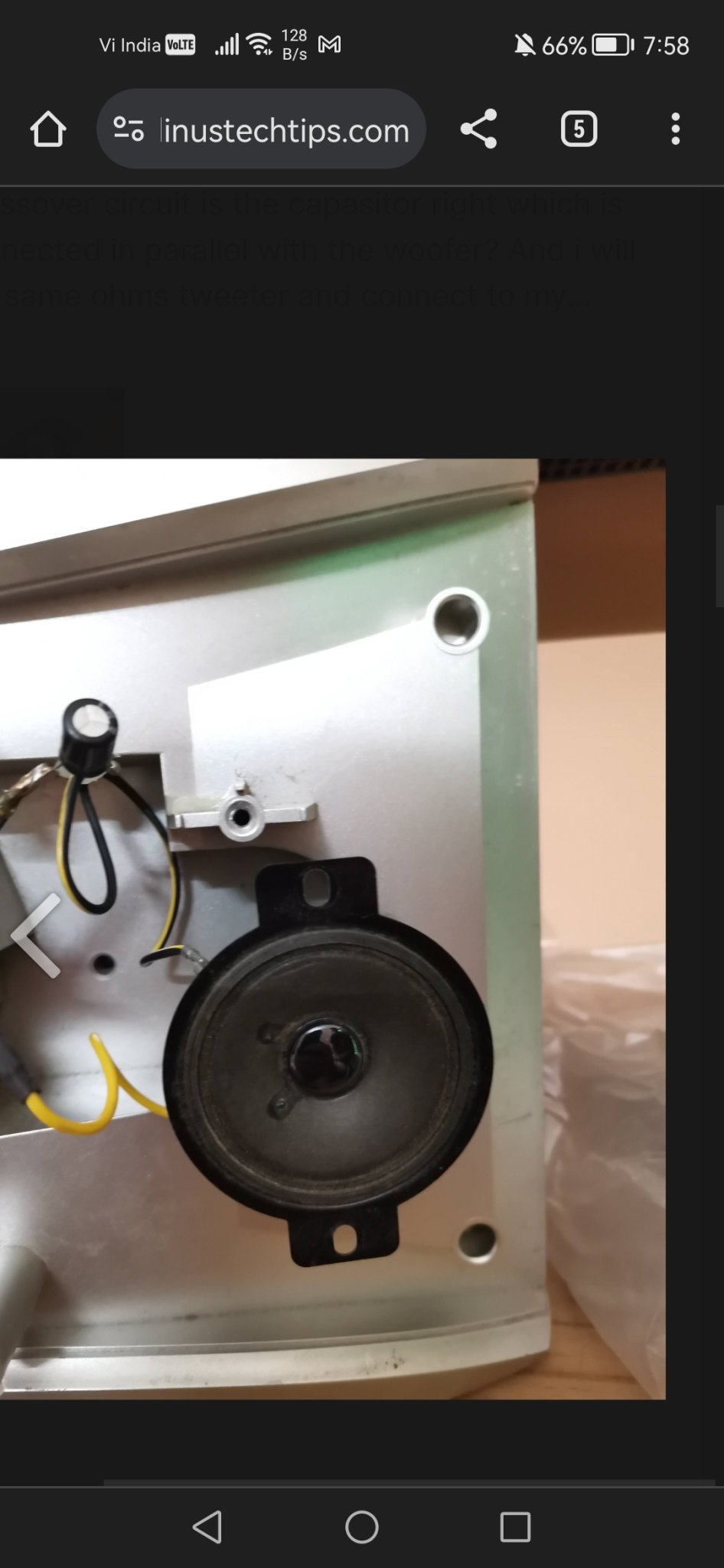

My Kenwood speakers 2 way tweeter has inline capasitor 3.3uf and twetter is connected to woofer in parallel and woofer is directly connected to amplifier do we need some capasitor or something as no crossover is in it when on full volume it distorts some times

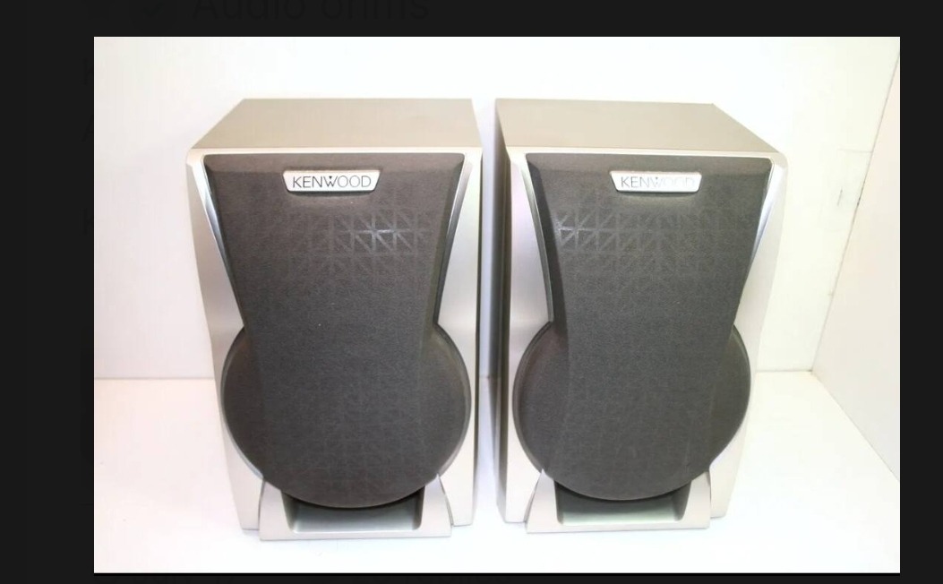

Pics!! Which Kenwood speaker (s)? From the '70s? '80s?'90s? How big Is the woofer? I suspect it's a 5" woofer and 2"(paper cone) tweeter or even piezo 😉

Woofer is 5.25 inch and tweeter is 2 inch and as mentioned before it's two way system tweeter working great but issue with woofer

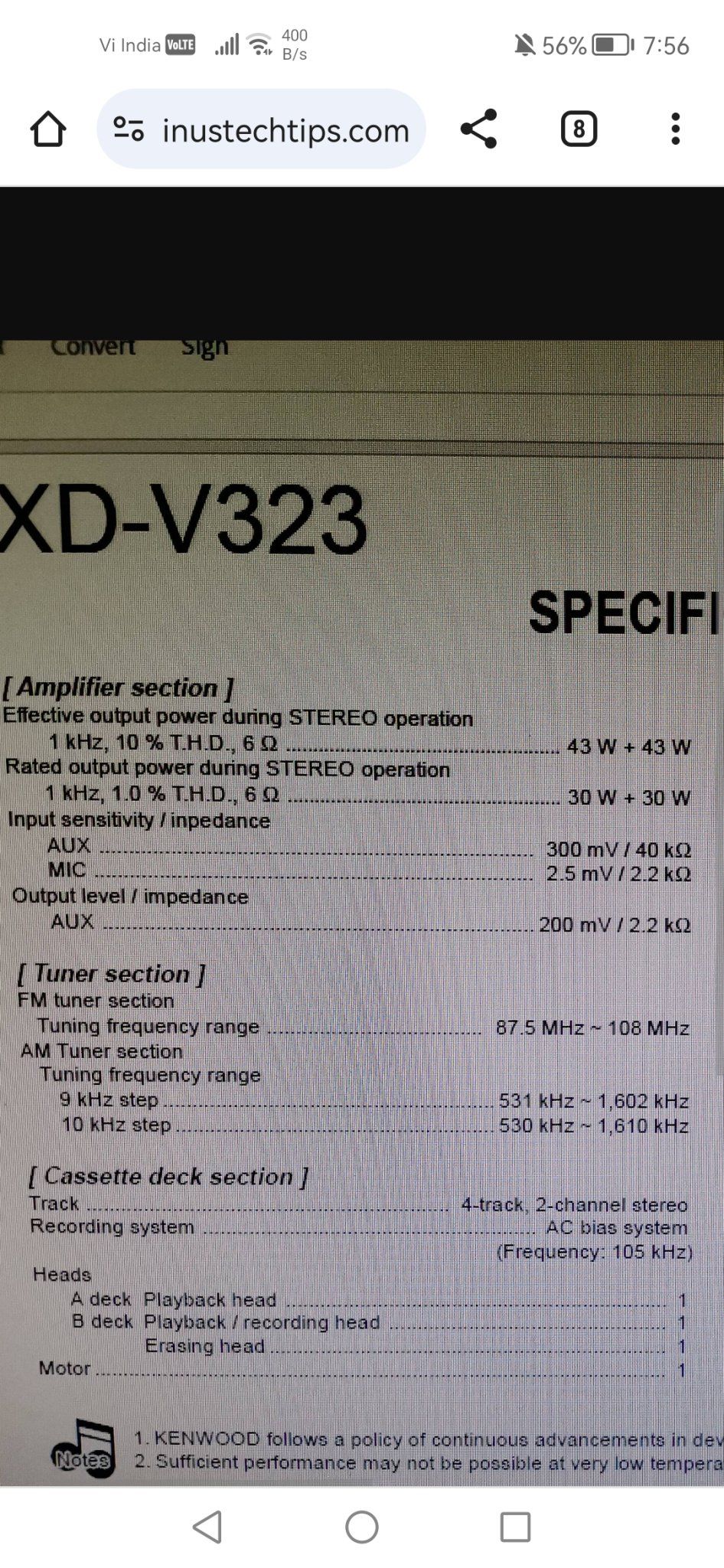

Below attached pic of speakers and amplifier specs(orginal)
Also attached tweeter pic with crossover but I have changed it to filim capasitor same value 3.3uf 100v as old one was leaking
Also i am not using same amplifier I bought nobsound ns-20g amplifier
