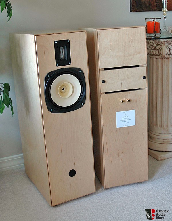

I am thinking to start a speaker build. My inspiration is the Tonian TL-D1. Here is the link, and I've attached a few pics that I found online.
Tonian Acoustic
The reviews have been outstanding, and I am tempted to just buy them for $2000+, but my budget is half that.
Review:
Tonian Labs TL-D1 - speakers - [English]
Having been bitten by the DIY bug, I think I can build something similar.
1) Does anyone have any ideas what drivers and ribbon are used here?
Driver maybe a Fostex FE206E? Ribbon- no idea. Any substitution recommendations?
2) Is the cabinet as simple as it seems? Would you think there is something fancy inside, or is it just an empty box as it looks? It doesn't like a folded horn or anything. I like the idea of thinner plywood, NOT ultra damped heavy MDF.
3) Just a cap on the tweeter, or something more fancy?
4) If someone can point me in the direction of a similar already proven design like this, by all means. Criteria: semi-open baffle, 95db+, similar size, no crossover on the main driver.
5) I don't have any analysis software. Is this something that can just be done "by ear." I've built some amps, and have a lot of electronics experience, but this would be my first foray into speakers.

Let's get away from Moray's detour into Klipsch-ville 😀 Those things have XOs in the telephone band.
1/ they used to use FE207e which are suited to a TL (the name suggests it is a TL). It is a lot more work to make a 206 work in something that isn't a horn. The new FF225wk is a likely substitute (check out Bob Brine's recent thread on this) Ribbon is likely a bigger Arum Cantus or Fountek.
2/ it's likely a TL of some sort, but your 4/ throws that out that whole idea.
3/ If from 4/ no crossover on the main driver then a cap or a cap + choke
4/ if you want an OB, you'll need a helper woofer and you are headed towards something like the Basszilla.
Something like godzilla's here but with an 8 + tweeter.

To my question #2, and to Dave's comment that the Tonian is likely a TL. (You're right, TL in the name gives it away) That is interesting. I think the term "semi open open baffle" in the product description was throwing me off. I am really not sure what that means. It would "semi open baffle" would preclude a transmission line, but in this case probably not.
Correct me if I am wrong, but folded horns would also fit into the TL category? In which case we come back to published designs like this?

From the Tonian picture, its not clear to me what is happening at the back of the speaker as far as the vent, and again the term "open baffle" is a bit vague. My knowledge of speakers is thus far rather thin, so I have a lot to learn for sure.

I've little time as I'm beavering away on a paper Royal Navy design policy in the late 19th century. FWIW though, the Tonian page has a near-dearth of information about their products on it; they seem more concerned with repeating the wire manufacturer Supra's marketing than describing their own speakers. However, their page does employ the phrase 'semi-open baffle.' Frankly, I suspect they're being a trifle creative with their definition: if you take a gander at the pictures linked to above, it would appear that the cabinet has a large rectangular hole in the rear baffle, which has been partially blanked off by a panel screwed across it, leaving a narrow slot above and below. The TNT review says the speakers come 'with a set of three port panels', so presumably this is what they are refering to, and these 'port panels' are of different sizes, which will allow the end user to tailor the box tuning somewhat.
If my conjecture is correct, then since the large rectangular hole in the rear baffle appears to be located behind the drive unit, and if it has a cross sectional area greater than the pistonic area of said driver, you will likely get a large amount of midrange radiation passing more or less directly out of the cabinet. Presumably this is what is being referred to by 'semi open baffle.' However, as soon as this hole becomes equal to, or less than, the pistonic area of the drive unit, any dipolar pattern that did exist will vanish and the cabinet will become a (slightly unusual) bass reflex enclosure. The box may be open at the base too; I doubt it, but it wouldn't make much difference one way or the other to this particular question of radiation pattern.

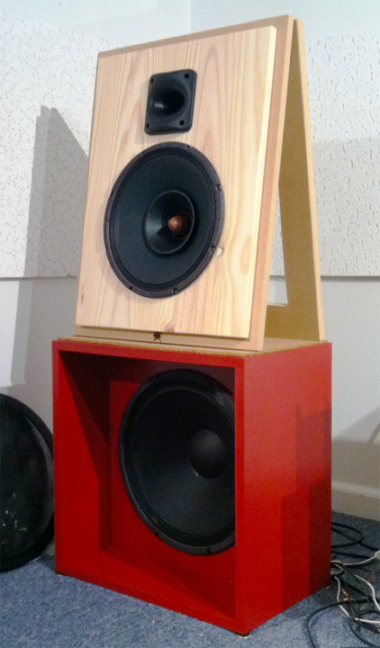

Very nice looking little system Dave I bet they sound good. What are you using in the H-frame? Those might be a good consideration for the fellow who started this thread. More detrails on those would be welcom. By the way a Klipsch K79 tweeter is flat from 2KHz out to 20 KHz and is a very good sounding tweeter which is very efficient (90Hx40V). Best regards Moray James.

It's godzillas OB... probably an Alpha 15, the FE is a 12LTA.

Yes, alpha 15 in h frame. beta 12lta and inexpensive compression tweeter. Just a cap on the tweeter and the h frames are fed by a sub amp. the 12lta runs full out (and sounds better after cutting out the dustcap... and better still with a phase plug).
Once it made the h frames and placed them into the room i really loved the bass. i think you can put lots of things on top of them and why not since they provide a good stand. if you want to do open baffle just build something that gets to about 200hz and dial in the h frames. You can even put speakers that are not open baffle on them with great results. maybe the best sound i ever had in my room was BIBs + h frames... but the look of all those speakers spoiled things. the 12lta satisfy for now and sound really great but i have tb 1808, betsy's, some fostex, some other tb's... maybe i will buy alpairs, jordan's, feastrex, lowther... but there is a point of diminishing returns especially since i've really been enjoying this relatively inexpensive system.
