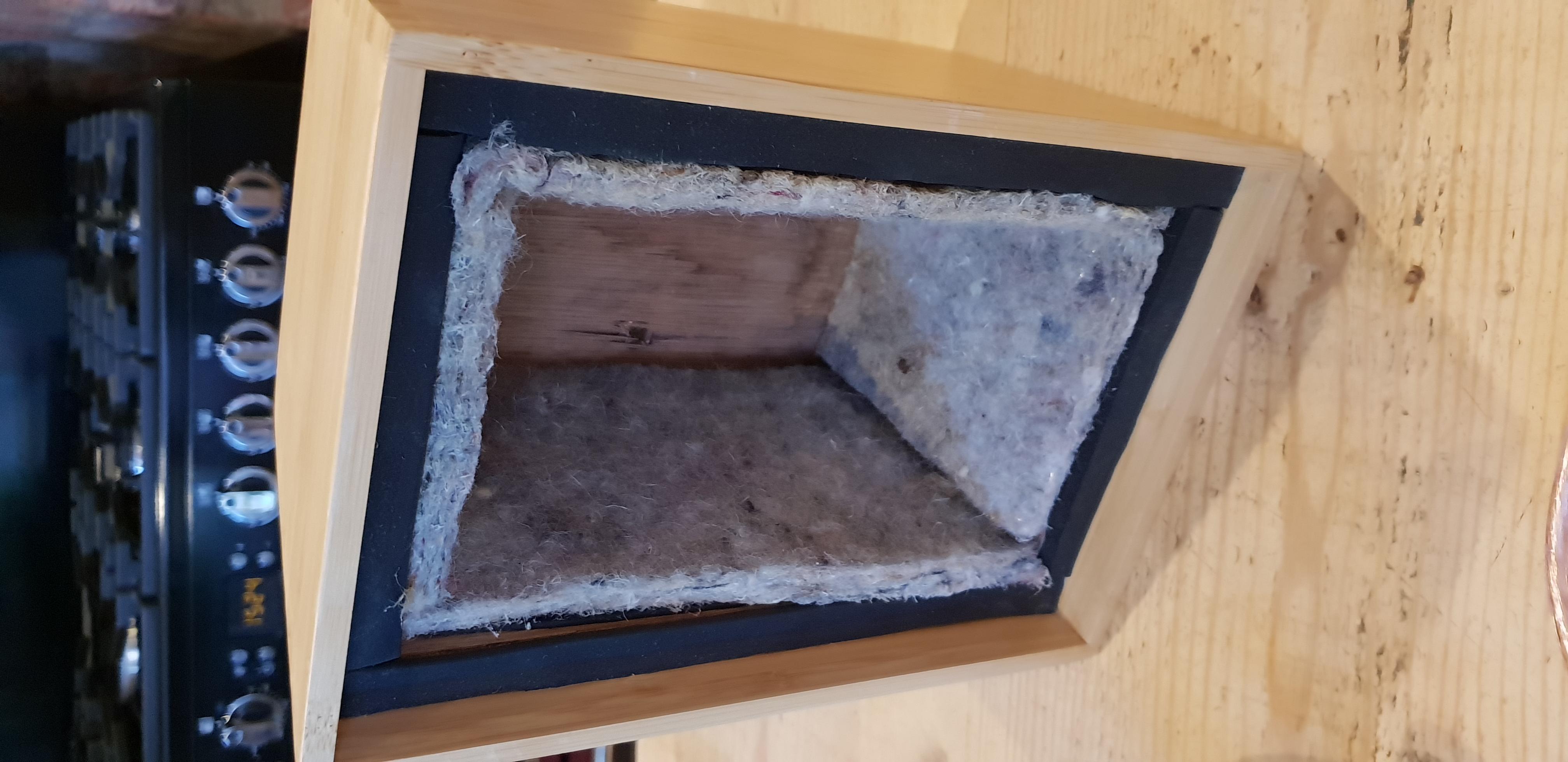

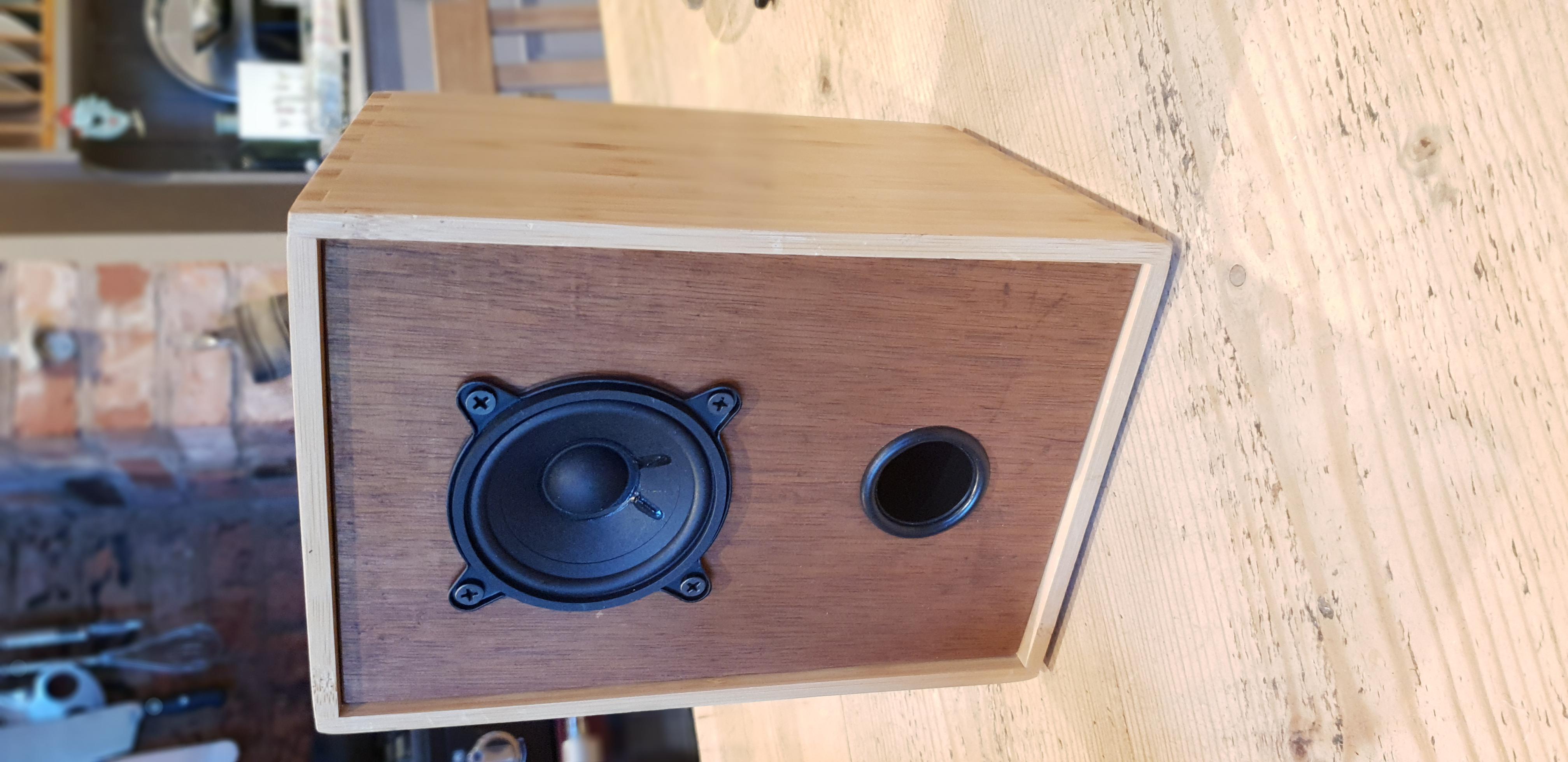

So as promise my BT outdoor speaker morphed into a stereo pair of small bookshelves, just to cut my teeth in speaker building. Based on an Ikea storage box and Faital Pro 3fe22. Approx 3.5 litre after adding a plywood lining to stiffen. 30mm port of 90mm length tuned to 85hz.
Only got them finished last night so limited listening so far. They are in my living room powered from denon avr and teamed with a rel sub.
Initial impressions are of an amazing soundstage. Way better than my Monitor Audio radius 90.
