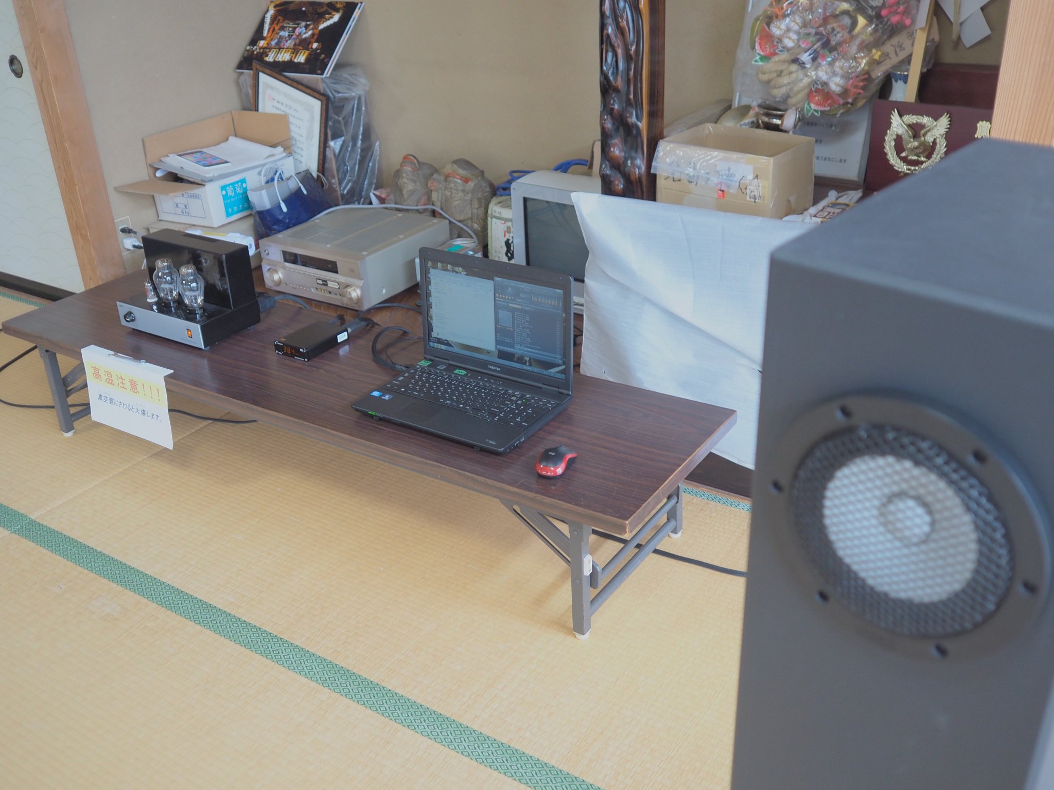

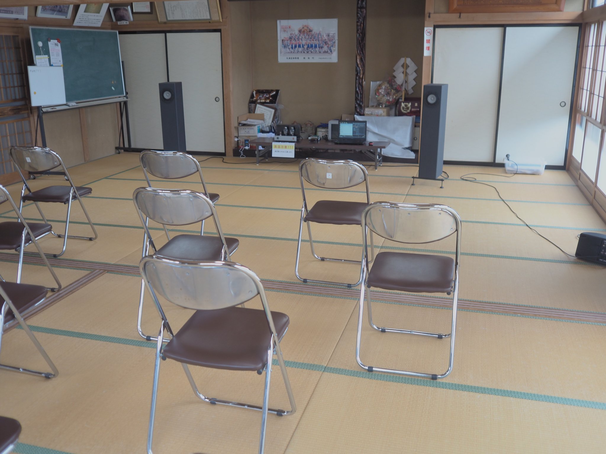

Your room is smaller than mine, quite a bit smaller if it has typical ceilings.
How loud do you need to play and what power amp(s)? And you probably have a budget? Size & cash.
My room needs a WAW to denerate bass loading you can feel, but i a happy with even some of my 4” boxes. The little ones (3”), sound really good but are bass shy.
So depending on the questions above, things are pretty wide open.
I will add the comment that the MA SuperPensil for the A12p was specifically designed for a larger room than yours in New Zealand.
dave
PS: I am sad to see an audio company die, but in the case of the ANs, none of the ones i heard were really good, one had potential, the rest were poor or worse (even after fixes does. And all too pricey. David Dicks boxes are a joke. I know BigUn likes his mono 15”, didn’t hear it. BigUn did put it into a boffle and not a factory box.
