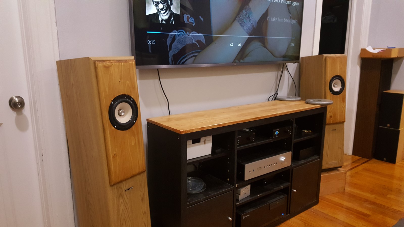

Tang Band W5-2143.
I finally installed a full-range driver. I selected the W5-2143 based upon reviews of superlative performance, impressive frequency response graphs, and some hopeful thinking that it would be work well in the Sony cabinet. Overall, I'd say project success (but leaving open the possibility of tweaking). I'll share more about the sound later...

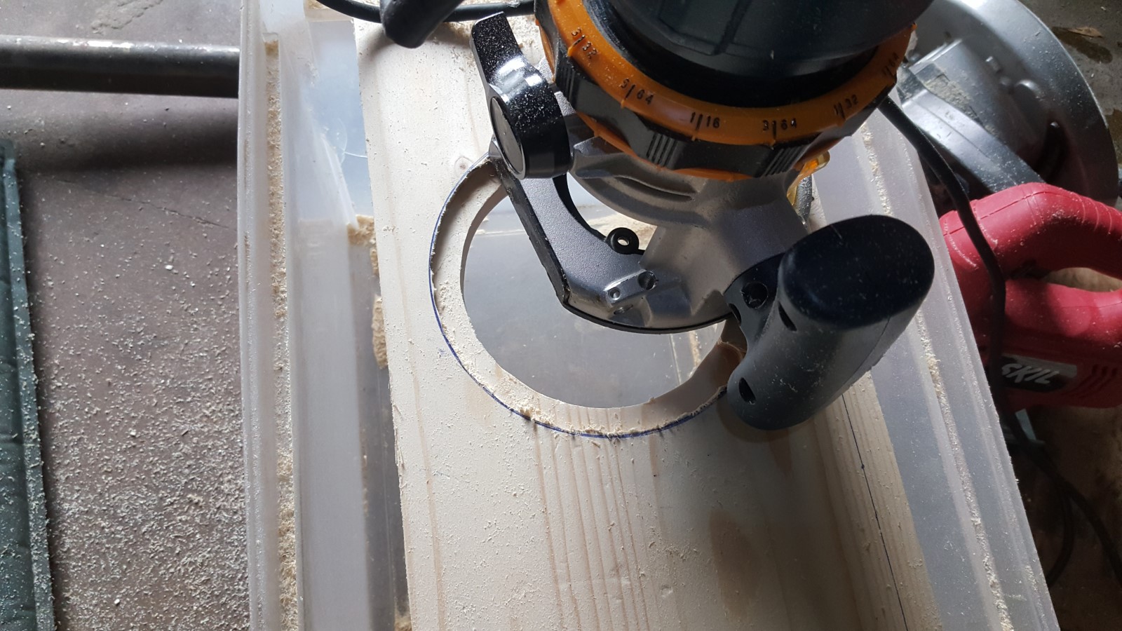

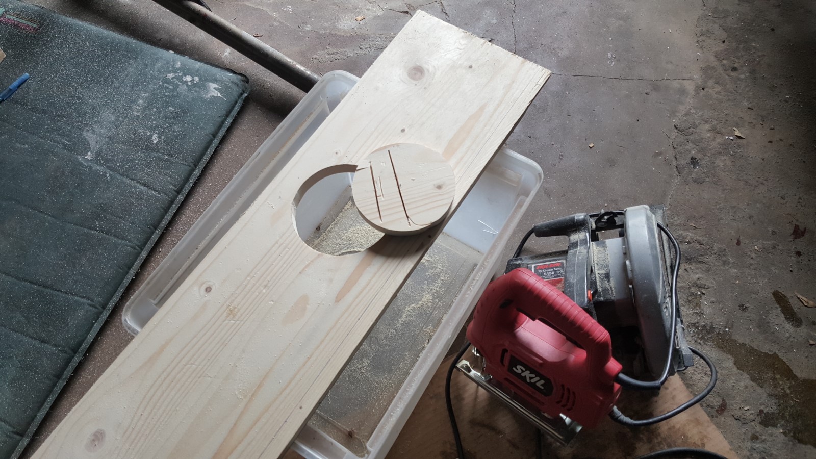

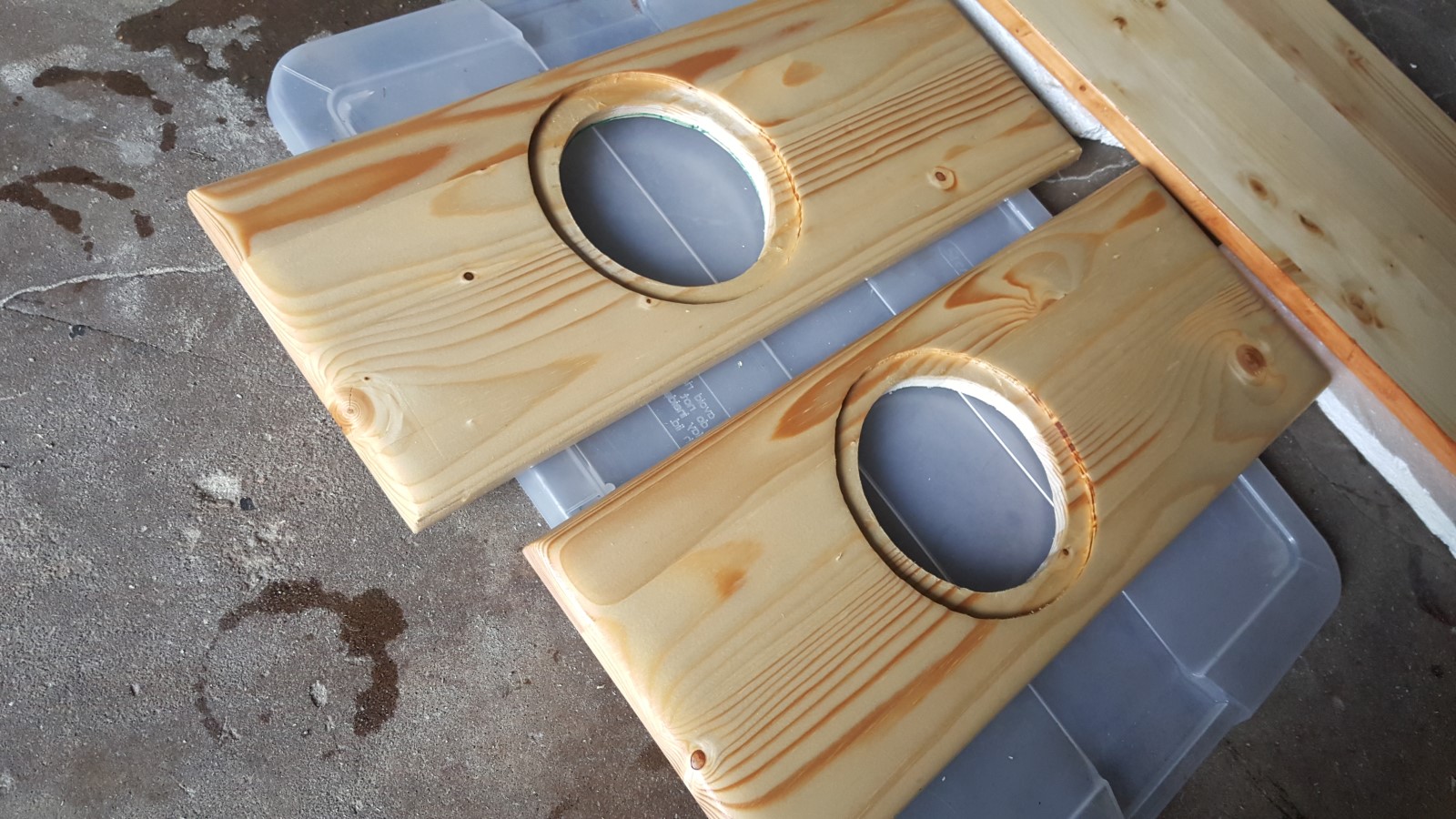

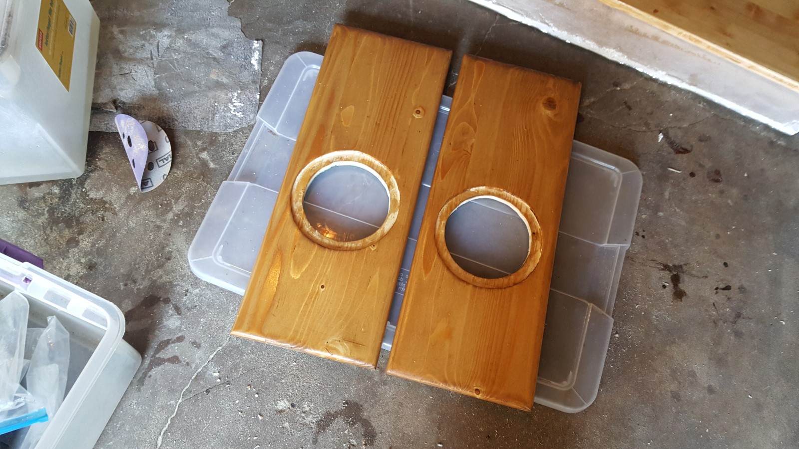

Building the Baffle
I had some easy to work with softwood in my garage - left over from another project. I decided that I'd create a single baffle to cover up all the old business of the original speaker.
I don't have professional workbench, but handheld jigsaw and router came in handy for cutting the holes for flush mounting and rounding out the edges.
Finally, I stained the baffle to match other furniture in the room (although they doesn't exactly match the cabinet - yet!)

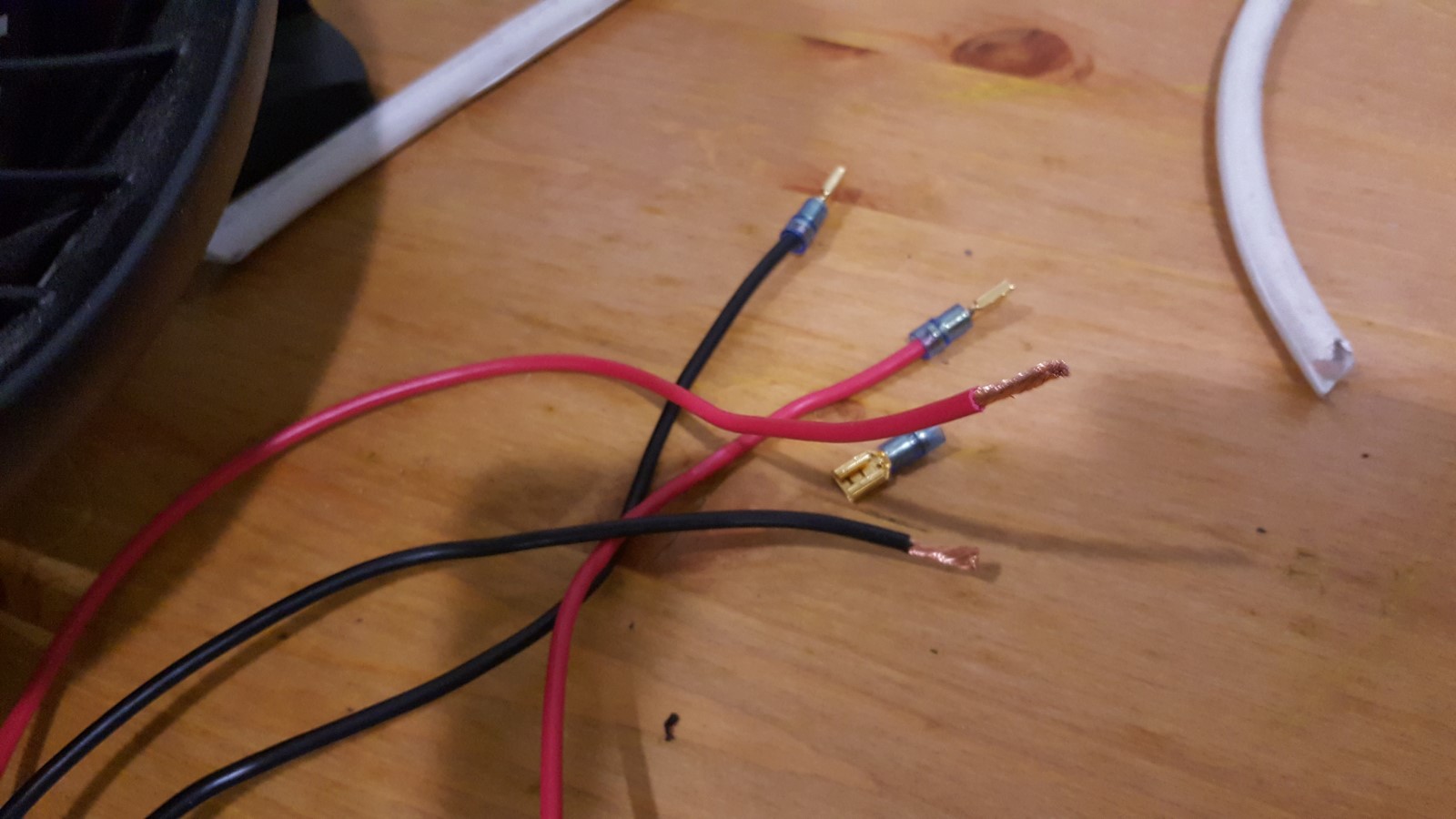

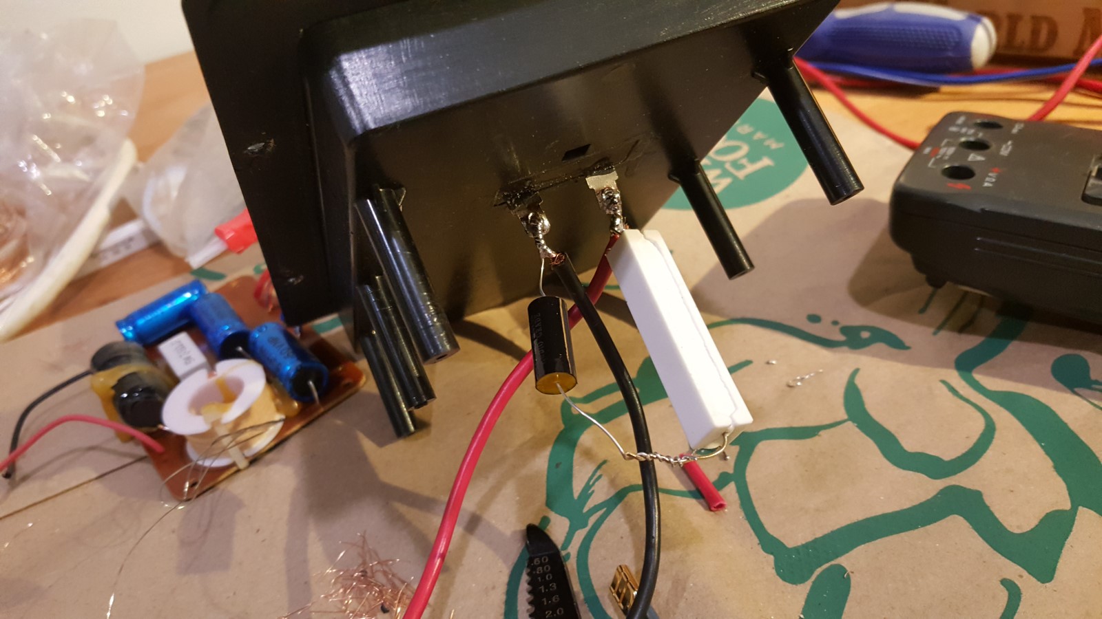

"NOT Crossover"

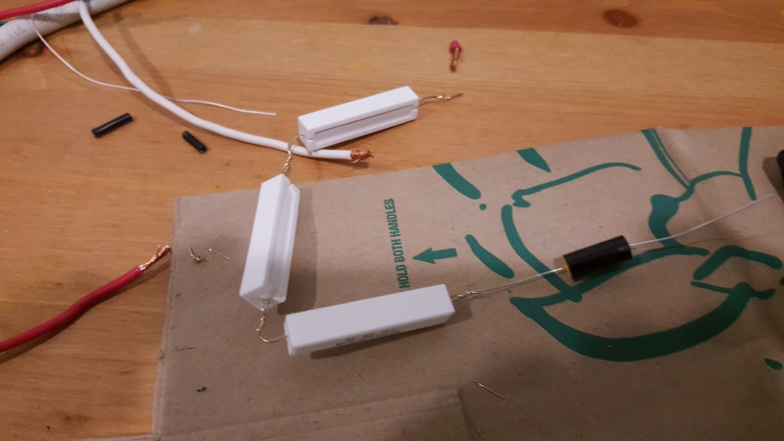

Per recommendations to add a Zobel filter (for purposes of stabilizing the amplifier load at high frequencies - and better overall performance), I add a capacitor of 0.33 uf capacitor and an 8 ohm resistor
(The recommendation was actually for a 7.8 ohm resistor; leads broke off when I started stringing resistor together...so I just went with the 8 ohm - it's only a 2.5% difference so not sure if this really matters much)
I use the original terminal cups. The original crossover was relative easy to remove and soldered in the Zobel filter and speaker leads.

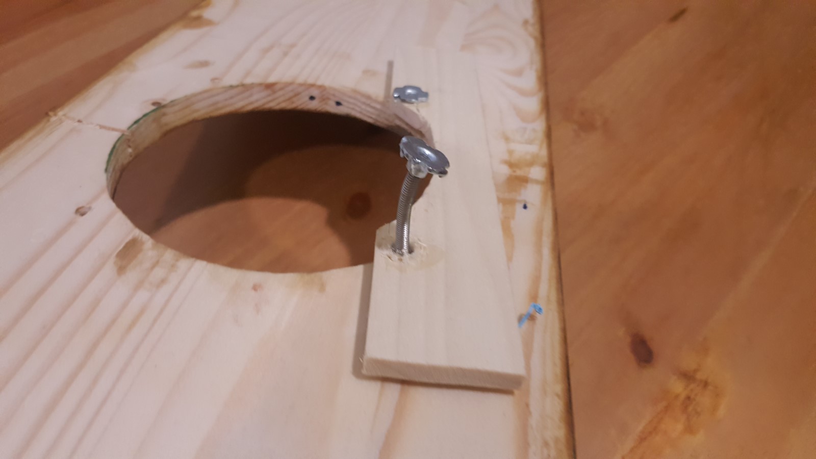

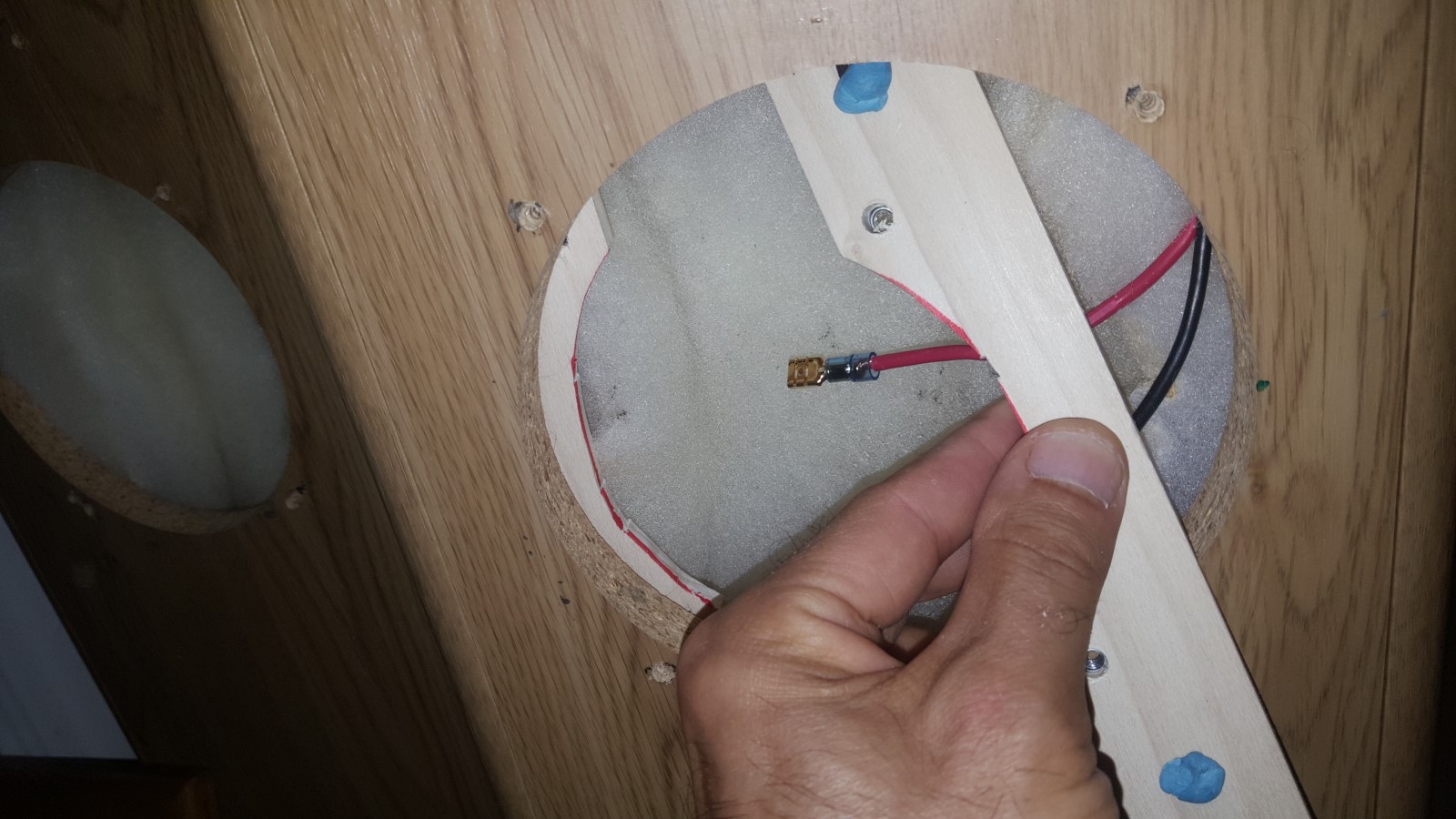

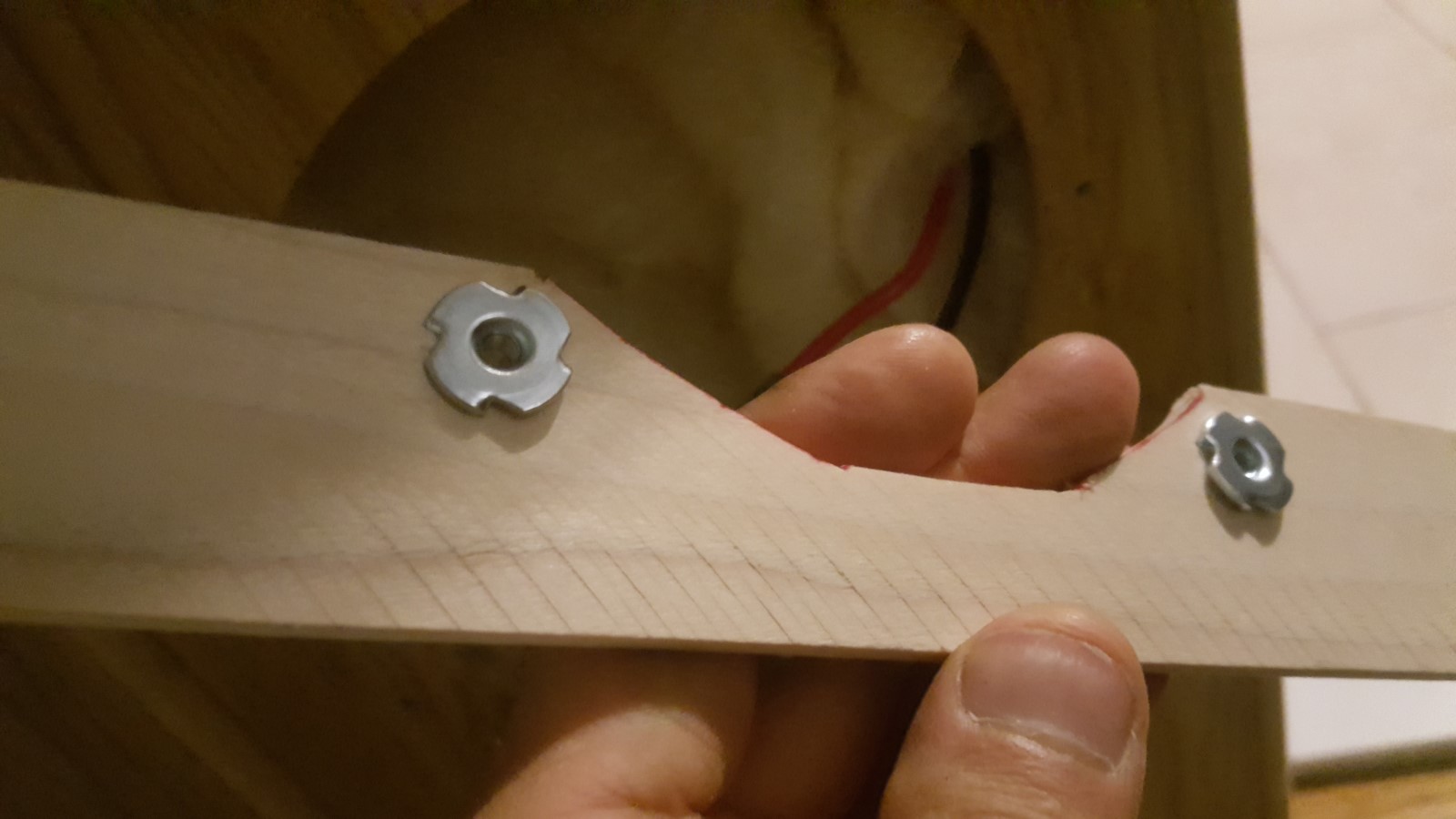

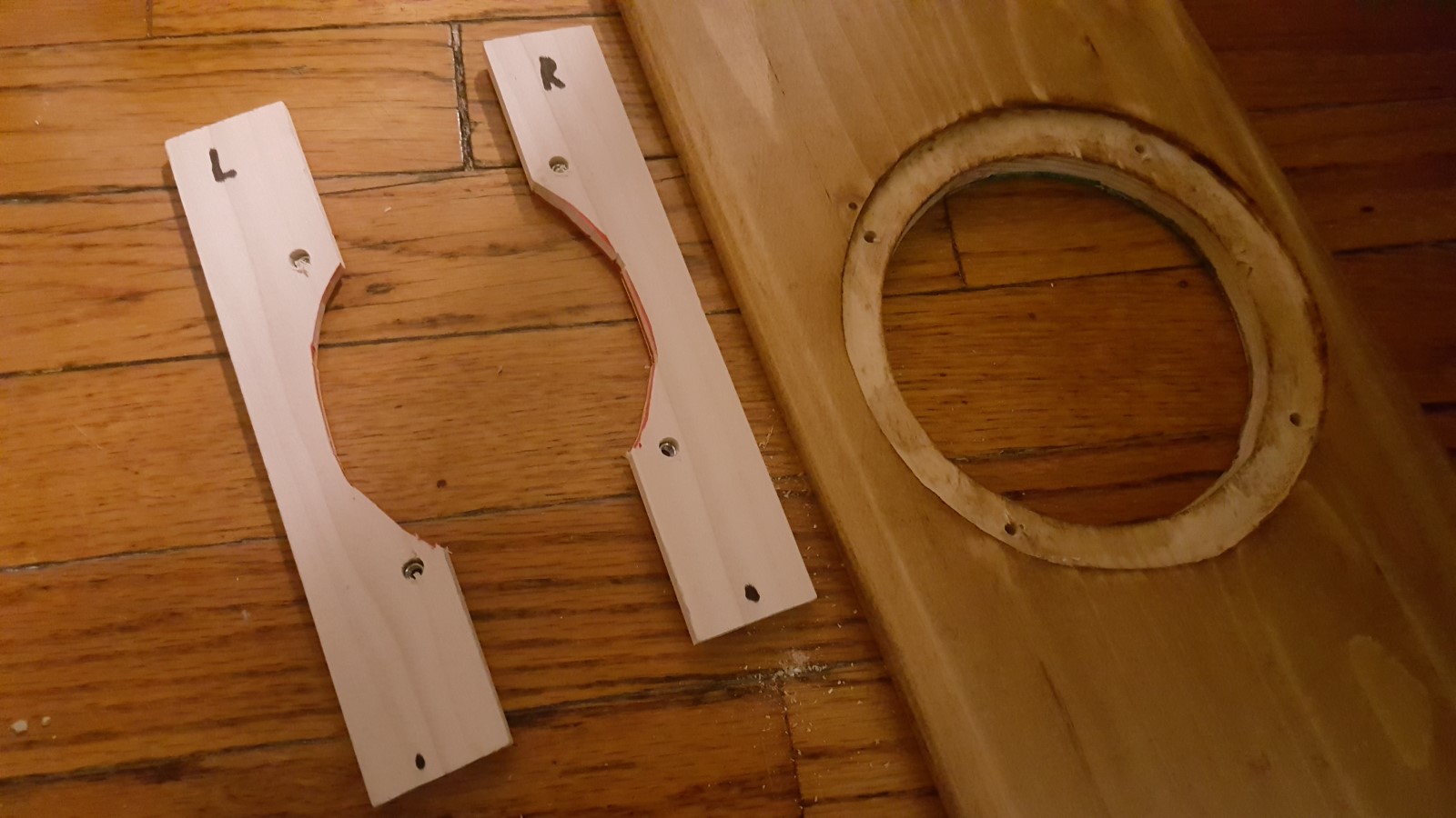

Mounting the Baffle
Attaching the new baffle to the cabinet *in a non-destructive way* turned out to be a pain.
*I created mounting wedges to place inside the cabinet with the idea of mounting the new baffle to these wedges using the same holes as the driver (instead of drilling new holes elsewhere in the baffle)
* I also used blue tack - both to hold the baffle and also to complete seal it to the cabinet.
*The initial attempt at using threaded inserted failed miserably due to cross-threading binding. (could be faulty hardware - not really sure)
I then just went to plain old #8 wood screws/sheetmetal screws attached to wood (after I re-inforced the wedges)

Nicely done!
FWIW, in comparing the W6-2144 I 'chose' originally Vs this one, an easy way to compare is by doing a simple vented alignment [Vb = 20*Vas*Qts^3.3] or ~142.9 L Vs ~23.5 L, so assuming published specs are reasonably accurate the cab is ~6x too large, i.e. severely under damped, i.e. [mid] bass [much] more rolled off in comparison.
GM
GM

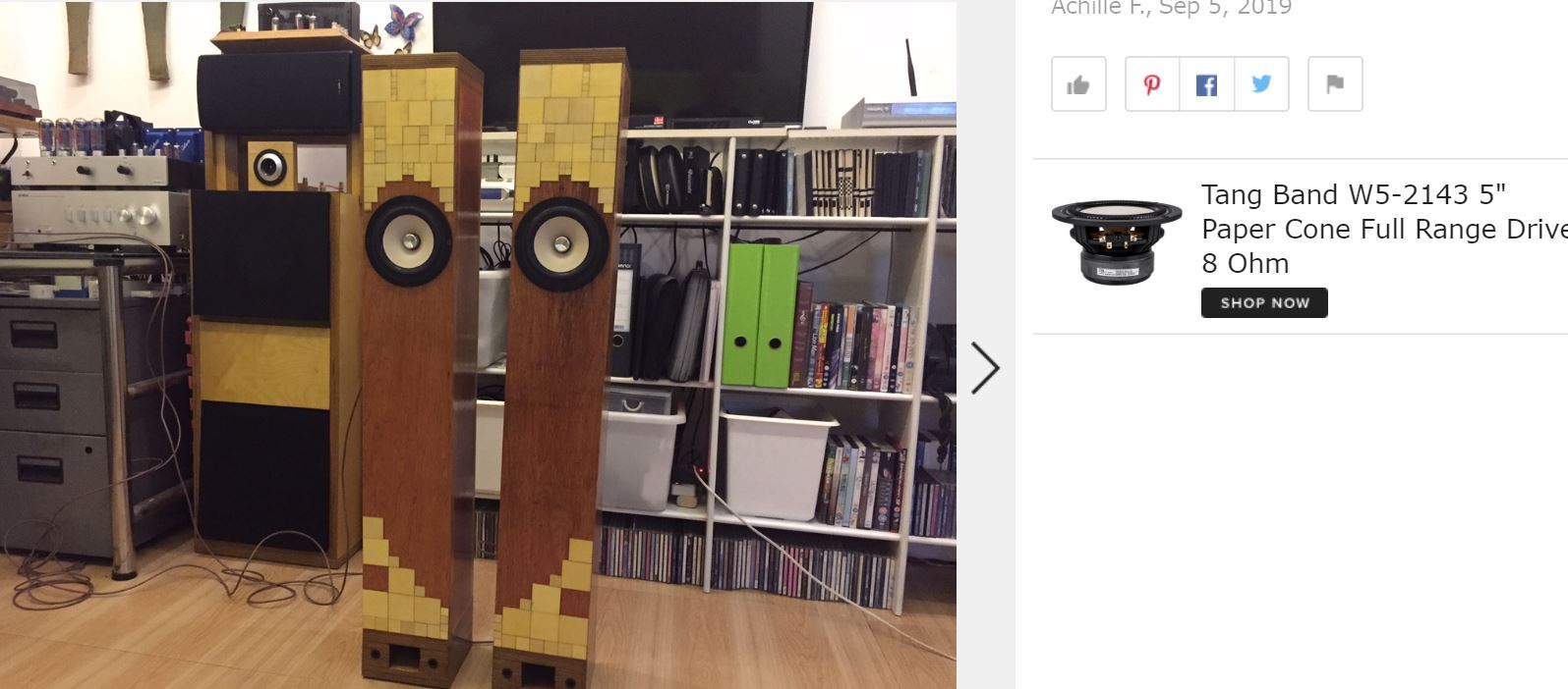

From what I’ve read the W5-2143s are great FR drivers and very versatile too. They seem to excel in open baffles and sealed enclosures – but will need help with the lower octaves. I would keep the drivers and toss the old enclosures. Since this is diy and you are at the FR section I would suggest going true FR with these drivers in a simple MLTL enclosure like the TABAQ – then you will have satisfying bass too. If you don’t want to cut your own wood and have access to CNC help, then it is just assembling a flat pack.
Examples of TABAQ builds:
