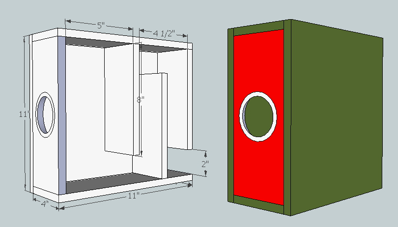

I don't know about any builders in OK, but there are a few of us who might consider constructing a box for you. If you can find a box/speaker you're interested in, let us know. We can take a look and see if one of us will build it for you.
I've attached a few for some ideas.
Mike

mikje's right hand sketch is more or less the same topology as the Woden labyrinth series. I've built a few of those for Fostex and Mark Audio drivers, and maybe even for the Fountek FE85 or FR88, I loose track.
Anyways, the labyrinth/TL works quite well - much better control and deeper extension to my ears than a single or double BR for the same driver-albeit at the price of a deeper enclosure dimension - all likely trumped by an uncompromised floor standing MLTL- but those can be a bit unwieldy for desktop
- just don't ask me for measurements of acoustic performance.
