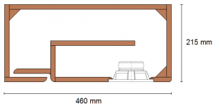

That sounds a lot like an MLTL i built a couple of years ago:
I have these in my office and listen to them almost every day. Nice, full sound, not fatiguing.
Front is 17 cm wide, center of driver is 30 cm from bottom:
I'd go for the Pluvia in a folded MLTL.

@onni - the objective is to keep all emitting elements away from the desktop and the rear wall to avoid peaks & nulls from reflections; I figured TL terminus and driver toward top of front baffle was optimal, but as I read through the design literature, I may find that there are other compromises to consider. Your lower drawing looks like it does exactly that.
