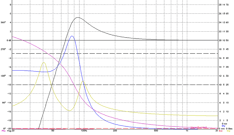

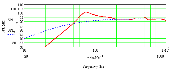

Yes. John just brought out his AN10 & AN12 for measure TSP. Here is the modeled response using measured parameters of the AN2.8 cab with AN10 with 6" port (2 3" ports have a less dramatic bump). I sent John home with a length of 6" PVC pipe. I suggested extending the port to 10 1/2".
dave

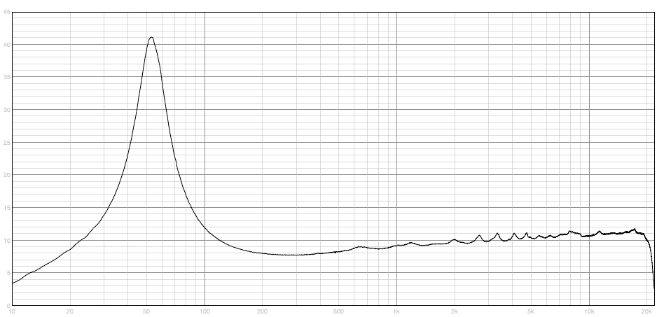

planet10 said:The impedance curves were revealing... that ripple train has to be quite audible... they could explain the need i felt for a tweeter... it could well be that the top end is there but very confused.

Ha! That coincides almost exactly what I've been predicting for the past year or so, with a ruddy great peak at Fb. I don't have the exact dimensions for the 2.8 box, but this is what MathCAD predicts, with the dimensions fudged from the site, a 6in vent, & the claimed driver specs...

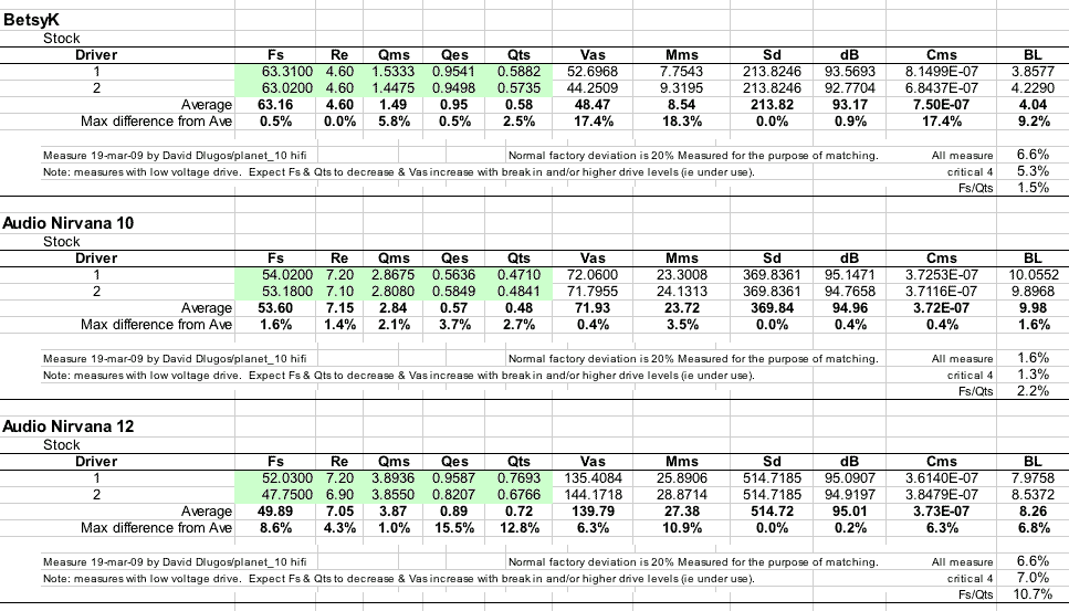

Here is what we measured today....
dave
Thanks Dave. 🙂
Hmm. Well, that's just resoundingly confirmed my dark suspicions about the manufacturer's claimed driver parameters.

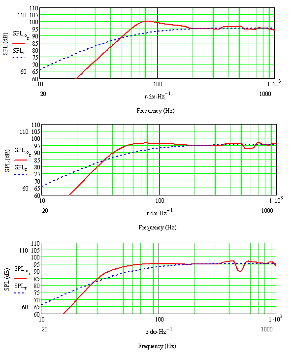

FWIW, again, fudging the cabinet dimensions (they'll be close enough), 3 FR plots for a 6in diameter vent: top = 0.75in long, middle 6in long, lower 10.25in long. The 6in diameter vent is a bit OTT IMO; certainly at anything less than a 6in length. Ferret owners best exercise extreme caution... 😀

Those modelled curves don't look much like the ones I saw on Dave's screen yesterday. The problems with the shorter vent tubes were more dramatic in Dave's models.
It looks like different software can make a big difference, so best to leave the final judgment to real ears!

VictoriaGuy said:Those modelled curves don't look much like the ones I saw on Dave's screen yesterday. The problems with the shorter vent tubes were more dramatic in Dave's models.
The last curve is very close to what i generated. My 3/4" curve looked to have a bigger bump, i'll have to do an overlay to see if it is just a graph scale artifact.
dave
Edit -you beat me to it Dave. Had a bit of a problem, halfway through writing my post, with a lump of Aberdeen Angus steak getting caught in my throat. 😱 Not recommended, I assure you.
I dunno -the short-vent graph I did above are pretty similar to the one Dave posted above, with a ~ +5 - 6db lift at Fb. I was feeling charitable & damped the box quite heavily, plus, as I mentioned, I don't know the exact dimensions of the cab itself, so I fudged it slightly. ~close enough to give a good idea of the general trend though.
