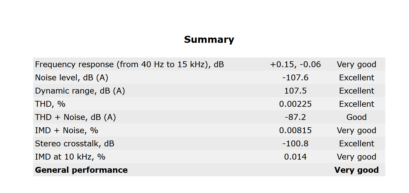

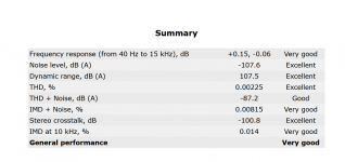

I am listening to a class D amplifier with a digital input with a real measured dynamic range of 107.5dB in a residential area and I do not hear any noise from speakers more than 20cm away from the speaker.
I think the concept not about hearing the noise floor or not. With this concept, you attain an analog like volume control without touching the input signal. This is what I find interesting.
