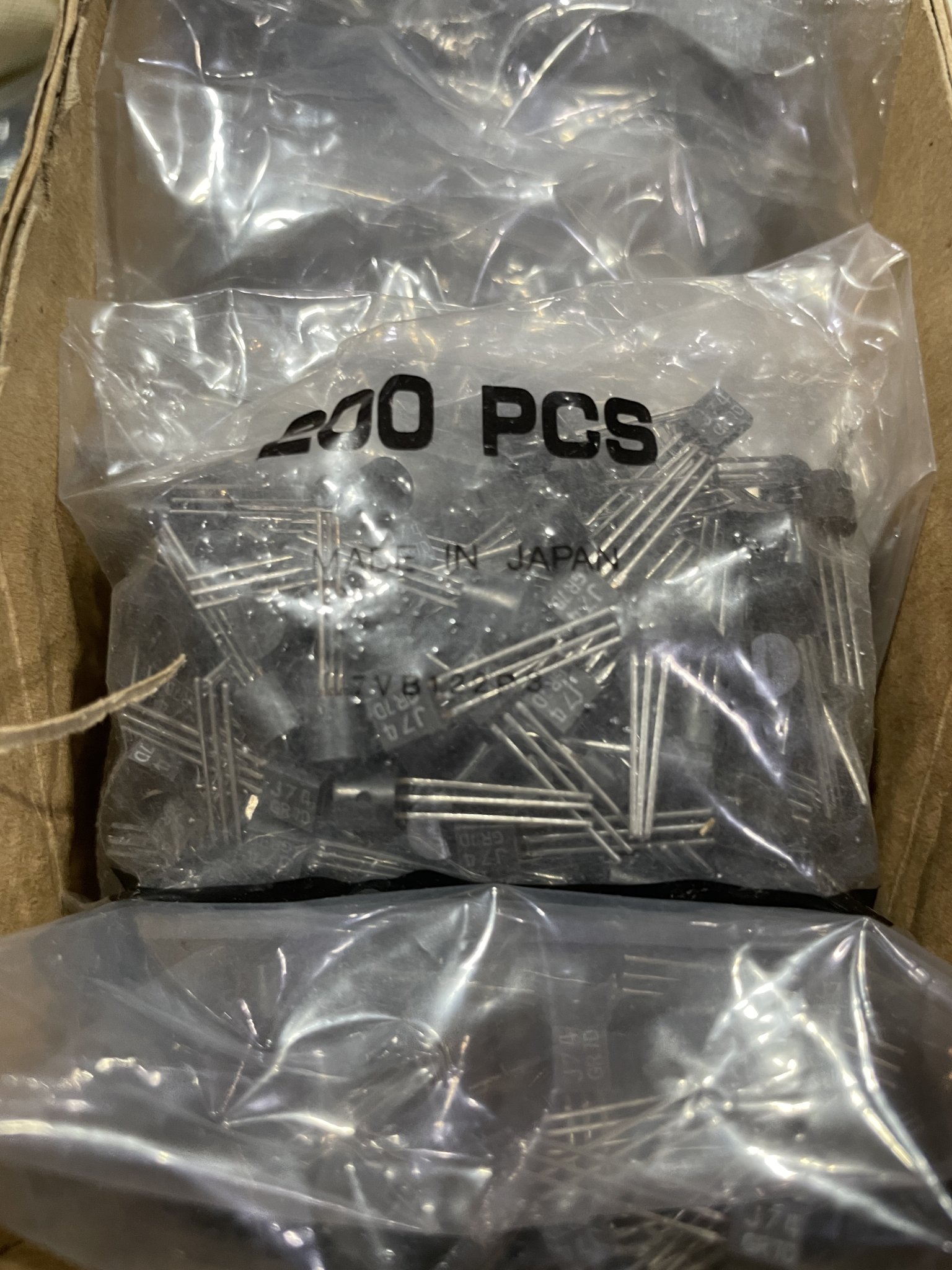

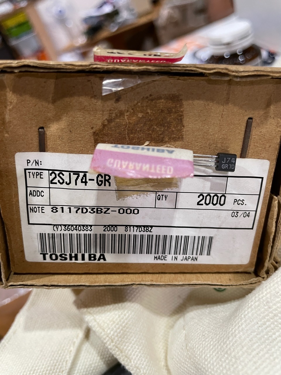

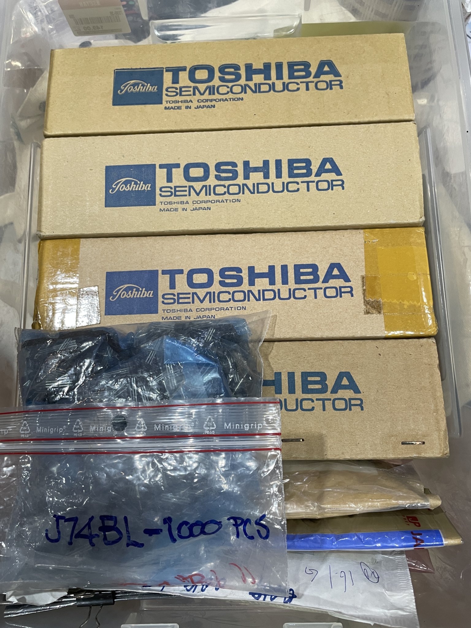

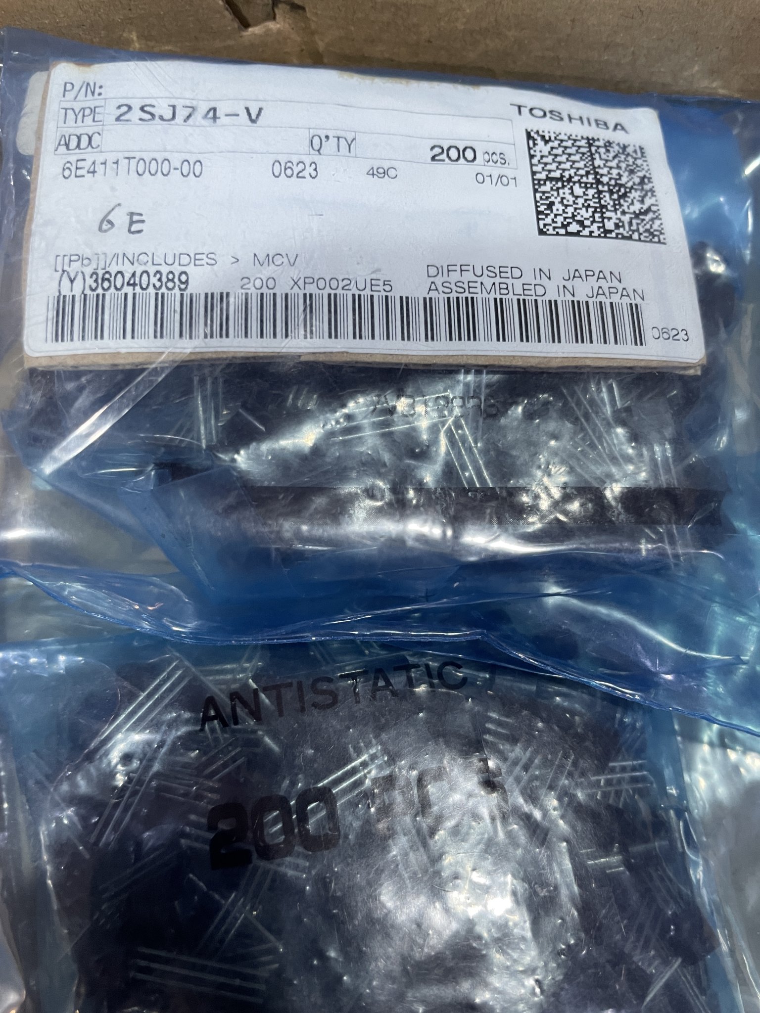

I doubt about your “genuine “ J74.
I have a near full box of J74GR also with silk-screen lettering. Check out how the “7” looks.
You’d better do some more research.
View attachment 1178559View attachment 1178560View attachment 1178561View attachment 1178562

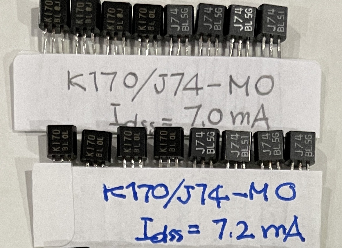

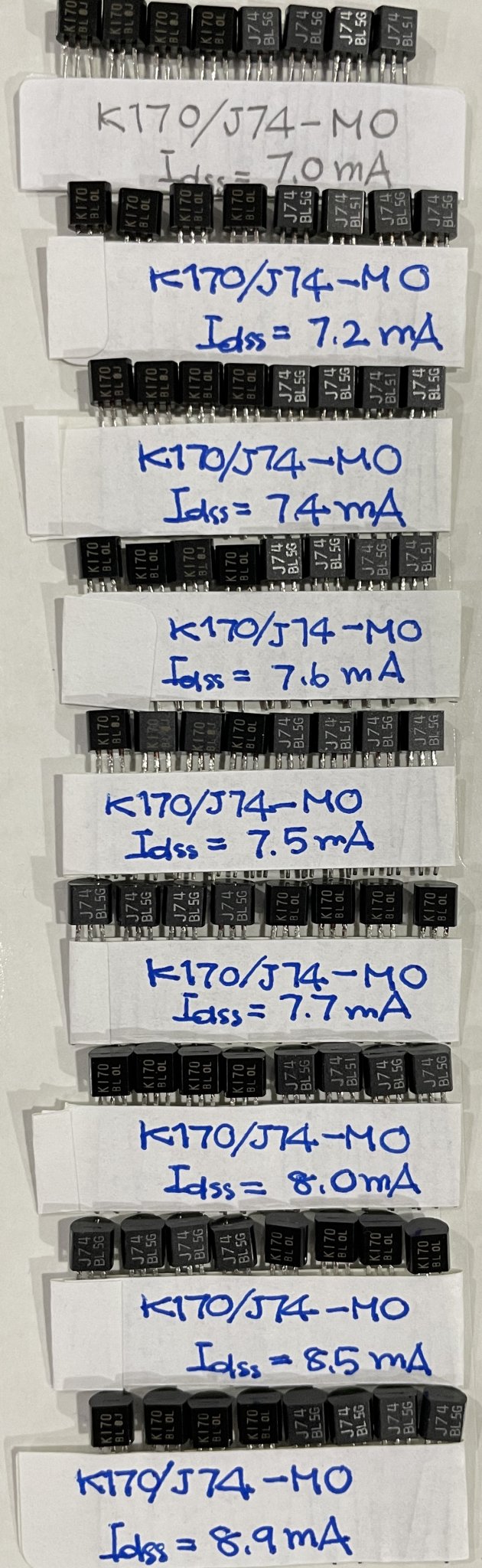

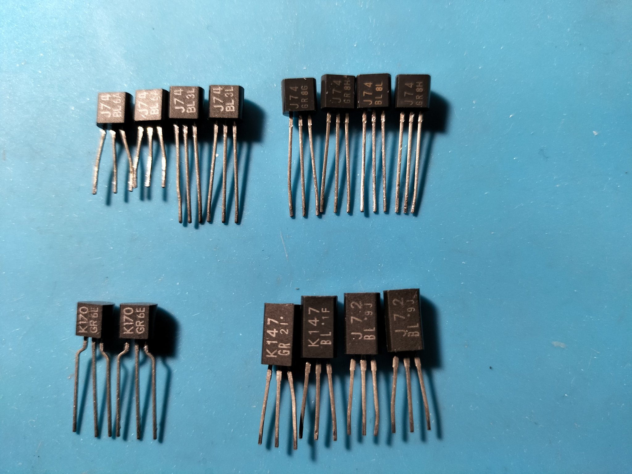

I've been a DIY hobbyist for 50 years since my school days and all of these JFETs I have were acquired when they were still in production. At that time, there were no fakes on the market as they are now, and there was no e-Bay or Ali.
Here are some pics of what I own. These are all genuine Toshiba products. (Confirmed by measuring gm and noise)
4 on top left.The old print production has a straight 7 character.
4 on the top right.
The new laser-engraved production has the letter 7 curved.
2 on the bottom left K170 from the old print on is also a straight line.
4 on lower right the printing of K147 /J72 produced at that time are also straight.
I stumbled across this thread today and am the first member to know prakit, so I have no affiliation with him.
All I can guarantee is that some of the J74 characters printed by genuine Toshiba are straight, and I do not guarantee the authenticity of what prakit sells.(probably real, I think)
