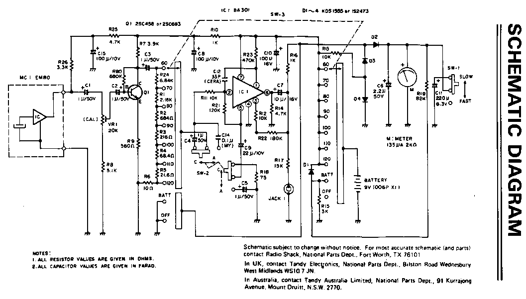

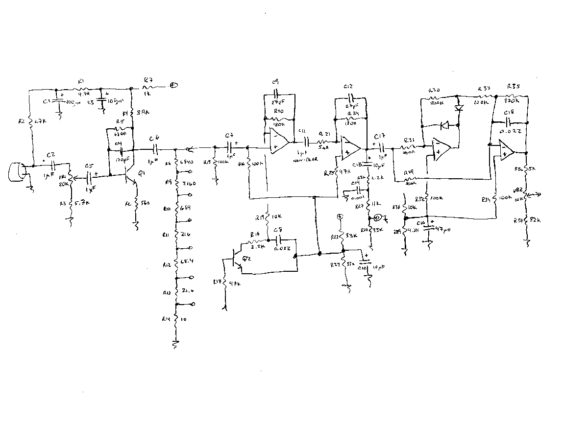

Does any one have the shcematic to this meter that they can post?
I used to be able to find it on the net but aparently the file has been pulled.
The chip went out in mine and I am thinking about retrofiting A bifet opamp in it.
I know I could order a new chip but that would cost money, and, if I could I would just buy a new meter. jer

Hello
Here is the 33-2050 and 33-2055 models schematics.
Bye
Gaetan
THANK YOU Gaetan!!! This is tough stuff to find!!! It appears that, as on the old analog meters, that the newer digital ones just need the coupling and power supply caps upped to reasonable values. It is hard to believe that 1 uF coupling caps would be specified in anything audio that is to be used for audio in the area below 100 Hz.
