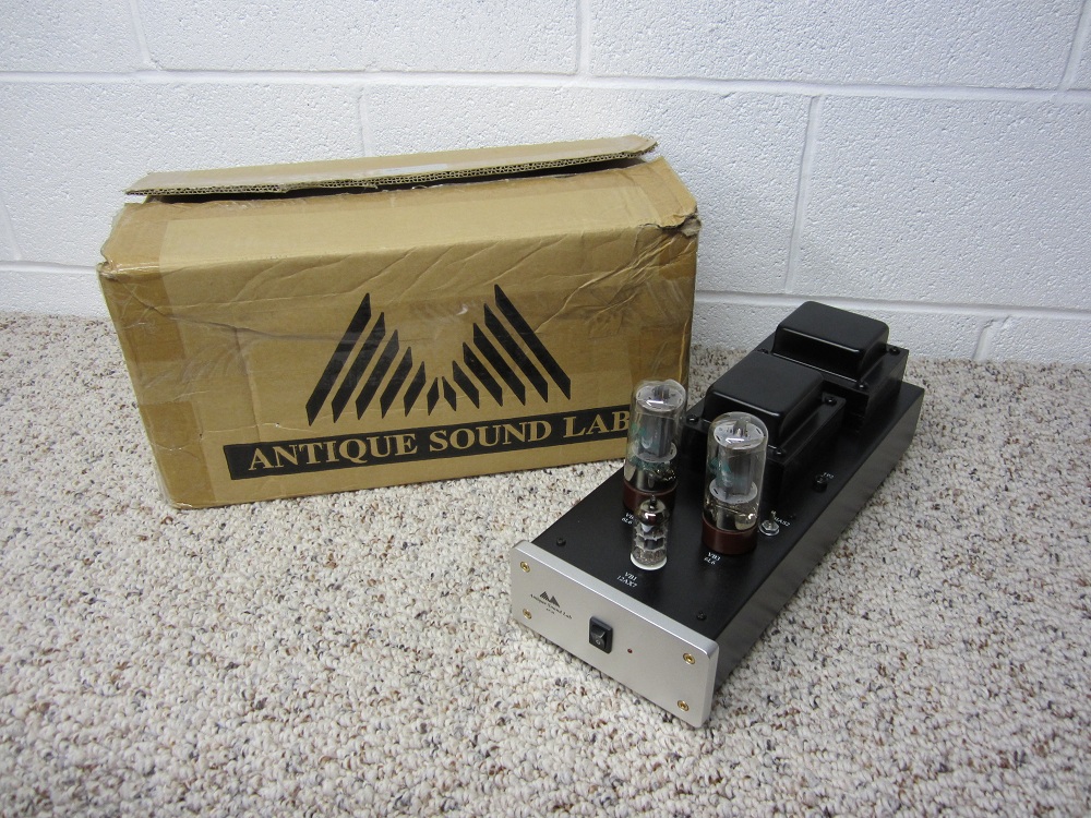

FS: ASL Monoblocks for Parts
Pass DIY Apprentice
Joined 2001
These don't work. They are for parts only. Tubes included. I don't know anything else about them.
Pair
$50 + Shipping (USA Only, Paypal Only)

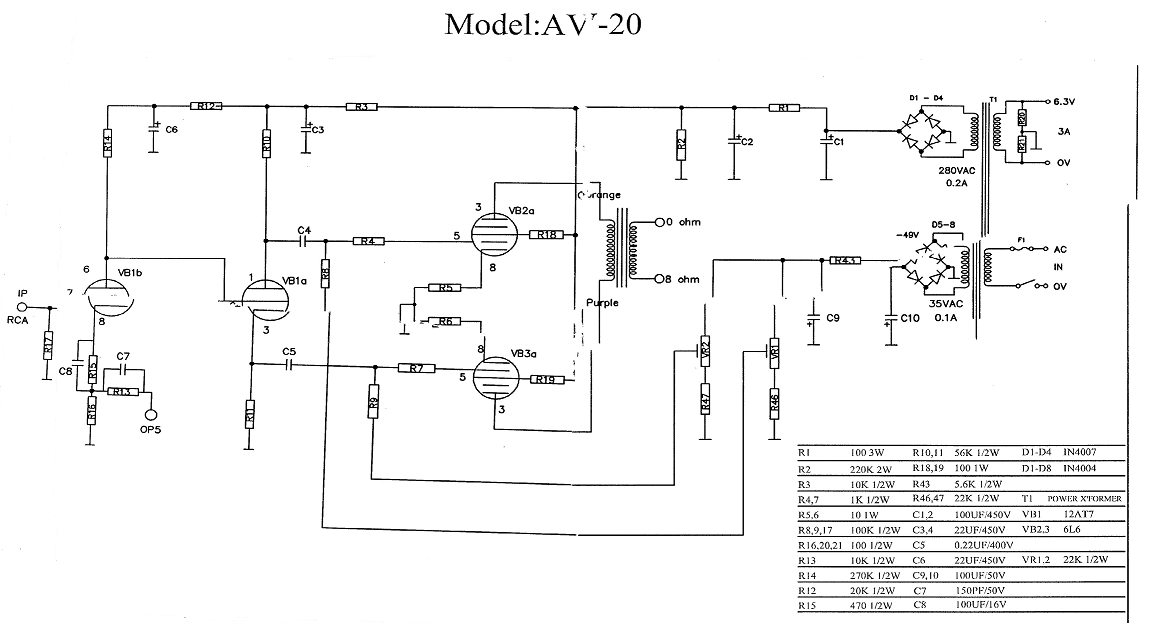

I received an electronic doc with the schematic and biasing instructions. I 'photoshop'd' to make 2 docs and, hopefully, better image quality.
Short version on biasing....330mV.
Geary

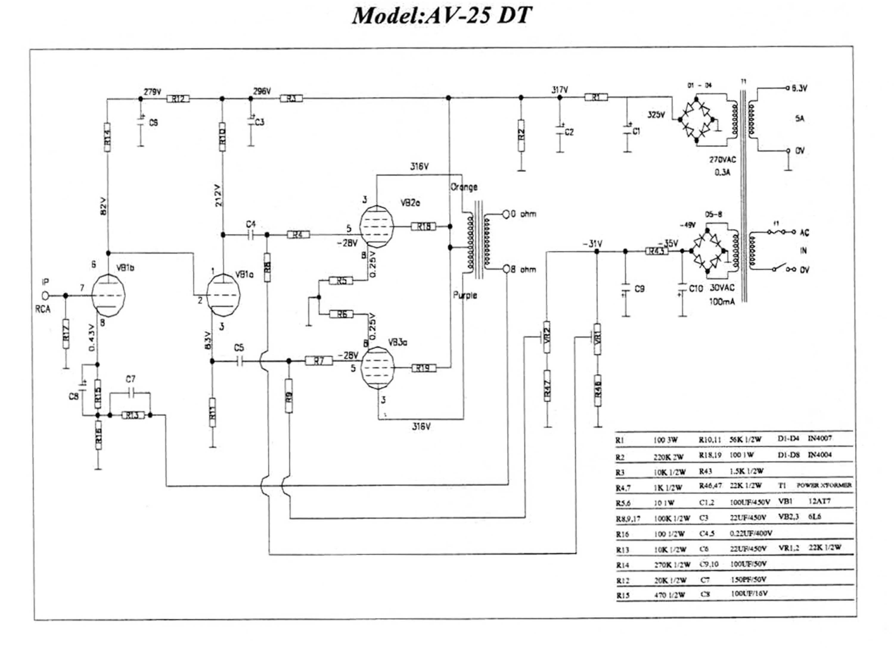

I want to point out that the schematic that I received from the distributor is for the AV25. Apparently the only difference between the AV20 and the AV25 is the power transformer. The voltages for the B+ are likely higher to get the higher wattage. The only component value difference I could find was R43 in the negative bias PS. AV20 = 5.6k AV25 = 1.5k.
