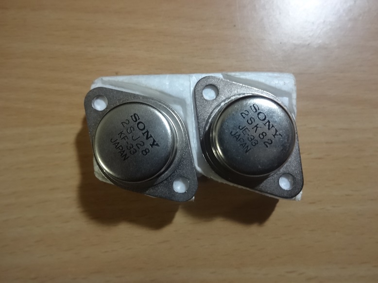

2sk82/2sj28 grade JE33 and KF33 85 USD/pair

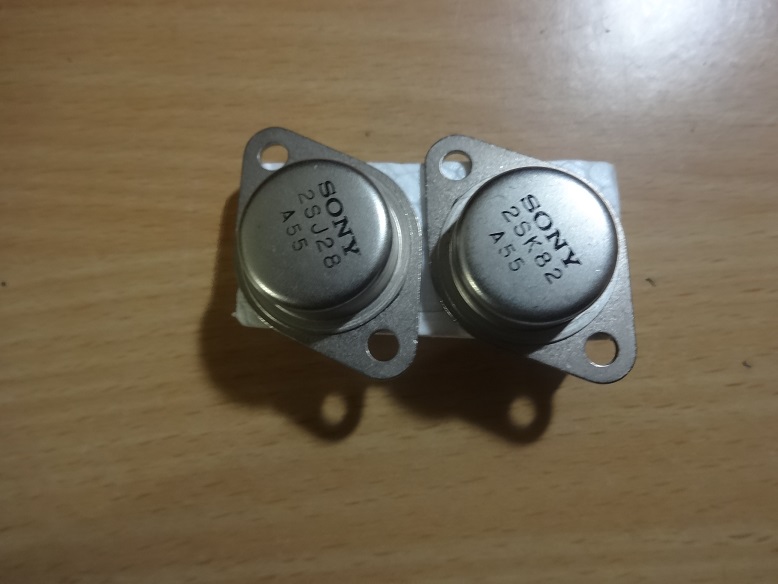

2sk82/2sj28 both grade A55. Very very rare one.May be first batch and single die version. but not 100% sure about it. 110 USD/pair

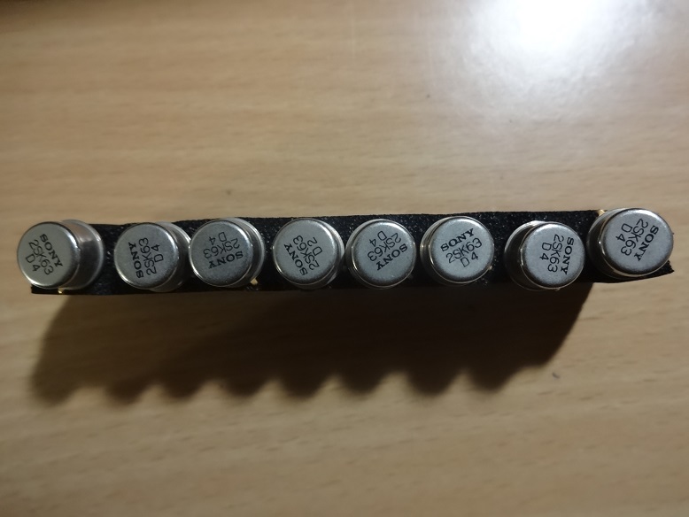

small power 2sk63 Vfet 25 USD.

Why the A55 is more expensive than the KF33?

A 55 is the first generation of 2sk82/2sj28 Vfets. Originally designed for analog application.Rank is 55. they are single die devices as per my knowledge. Later versions are optimized for switching amplifier application like Sony TA-N 88. Rank is 33 and are dual die version.
2sk63 don't have any complementary devices as per my knowledge. 2sk63 and 2sk79 are same product in different packages. one is in metal can and other one in plastic moulded.

The 63 is 220mw while the 79 is higher by two or three. I got from you two pairs of matched 79 some time ago.

No, K63 is 470mW while K79 is 750mW. Possibly due to difference in junction to ambient thermal resistance: 200 vs 126 C/W.
Check out their datasheets: AMPLIMOS one stage amplifiers amplificatori audio monostadio

Power rating difference may be due to thermal resistance of different packing.

The K63 possibly only has the base side of the die contact the metal base. For the K79, the base of the die sit on the source pin (metal), and the top contact with the epoxy. So while the epoxy conduct heat less than efficient than metal, the K79 manages to outdone K63 in heat transfer efficiency despite less metal is used.
