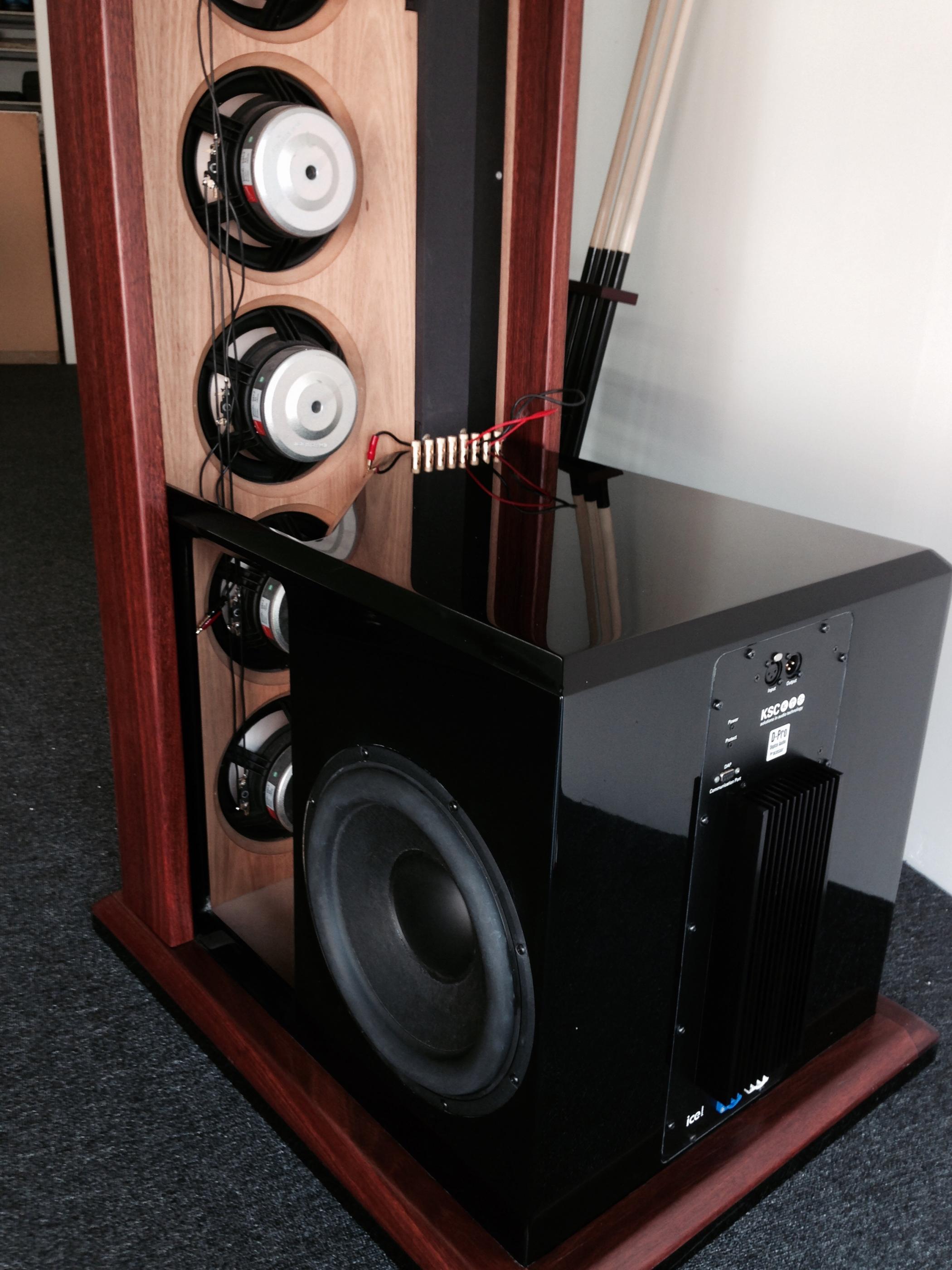

These are self powered with DSP by Digmoda DDC552.
1 x 1200mm 96dbm/2.83v Neo ribbon (from Ambience speakers top speaker)
8 x custom made HiVi M8a-2. Not M8a with a spelling error, I had these custom made by HiVi for me only with copper shorting rings installed to reduce the odd order harmonics. Only 20 ever made. I still have 4 new in box.
2 x Peerless 830500 12" subs in 80L sealed enclosure.
These speakers were made to play clear and loud. They do, and shake the house while doing it, but they are FAR too big for my house or any house I will have in the near term.
Subs are painted in 2 pac Black, panels are in 32mm mdf laminated in oak. Edges are solid Jarrah.
A few things could still be done to improve them, and one ribbon needs a new ribbon.
