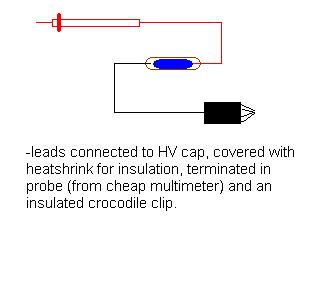

Here's the amp before mods
...and after
looks quite messy - used all sorts of colors for grounding wire, etc... The white things near the preamp are ceramic coated wirewound PS filtering resistors. I noticed I've cut out the input cable, but it's only a shielded wire going from pin 7 to the isolated input jack
...and after

I have find the following simple tool useful to diagnose many tube amp problems. You can use it to short out preamp tube grids, to diagnose how far down the signal chain a particular noise is originating. (make a list with pen and paper) Then you have less circuit to investigate. If shorting out the early preamp grids does nothing then it is probably a ground issue.
