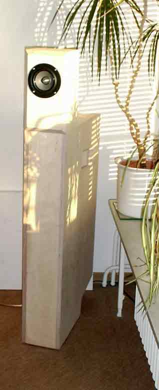

Thanks guys for this first feedback...
Obviously, the Sachiko as well as the Hiro seem to big for my room. I just measured around some more... the maximum listening position would be 3 meters from the speakers (going further back I would end up in the kitchen 😀)
The Maximum footprint for each cabinet shouldn't exceed (30 (width x 60 depth) cm wenn placed directly in fornt of the wall (an estimated depth of 40cm would result in an 20cm space to the backwalls. A couple of centimeters more or less are no obstacle.
Maybe I should explain why I wrote "espacially for metal". I'm still very happy with the Needles - I really like their tonality, also while playing metal (I do NOT listen very loud at all). What I wanted to achieve with the new speakers is: more "in your face" (more dynamic) but still a quite linear reproduction from 60 hz upwards. I little dominance of the mids is no problem at all for me, since I like that. I know all horns go well louder than the Needles, but I think I'll never listen to them louder than 90db. So max volume and frequencies below 60hz are not important to me.
With that additional information given - any further suggestions from you?

I just took a closer look at the suggested Brynn. Kind of like that speaker, too... the only thing I worry about is the height of the speaker itself... it's about 62cm, with spikes/stands 65mx... thats about 25-30cm lower than my ears at listening position.
Must I be worried about Sweetspot or "listening off-the axis" problems?

Brynn limits you to finding some FE127e (i still have FE127eN available), but coming up with similar for EL70 & CHR70 based on Mar-Kel, and Mar-Ken is something Scott & i have touched on.
We had no issues with the height of Brynn (i have a set here), but some tilt-back pretty much cures any issues.

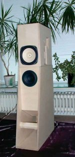

About the Lotus V2: is the side speaker supposed to be "looking" in between the speakers or to the outside? Doesn't that effect the "stage" in a bad way - because that's my experience with any drivers applied to the sides of any cabinet?
Similar configurations have been used either way (i.e facing out or in) - Cal Weldon could relate his experience with Calhouns (CSS FR/WR125).
