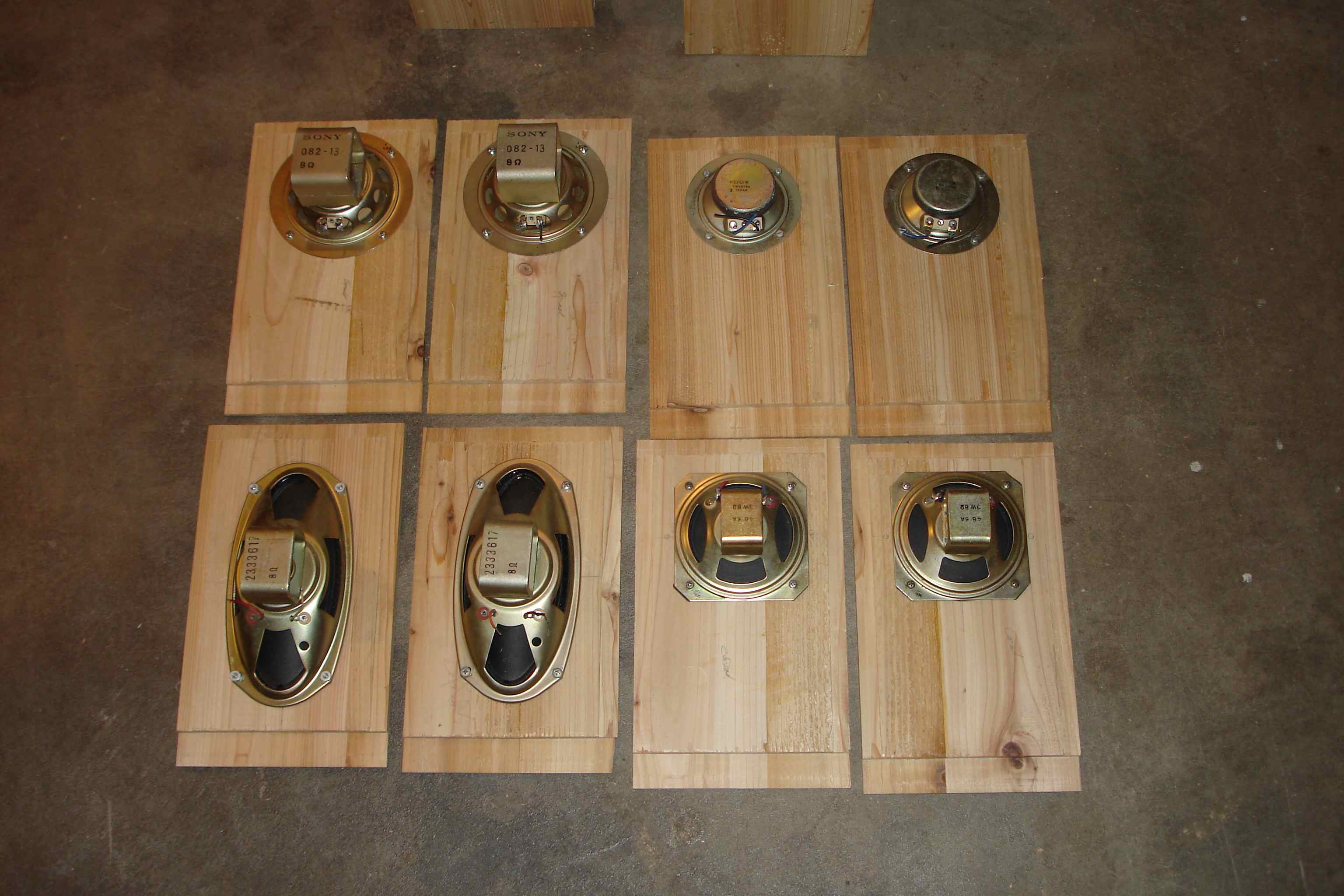

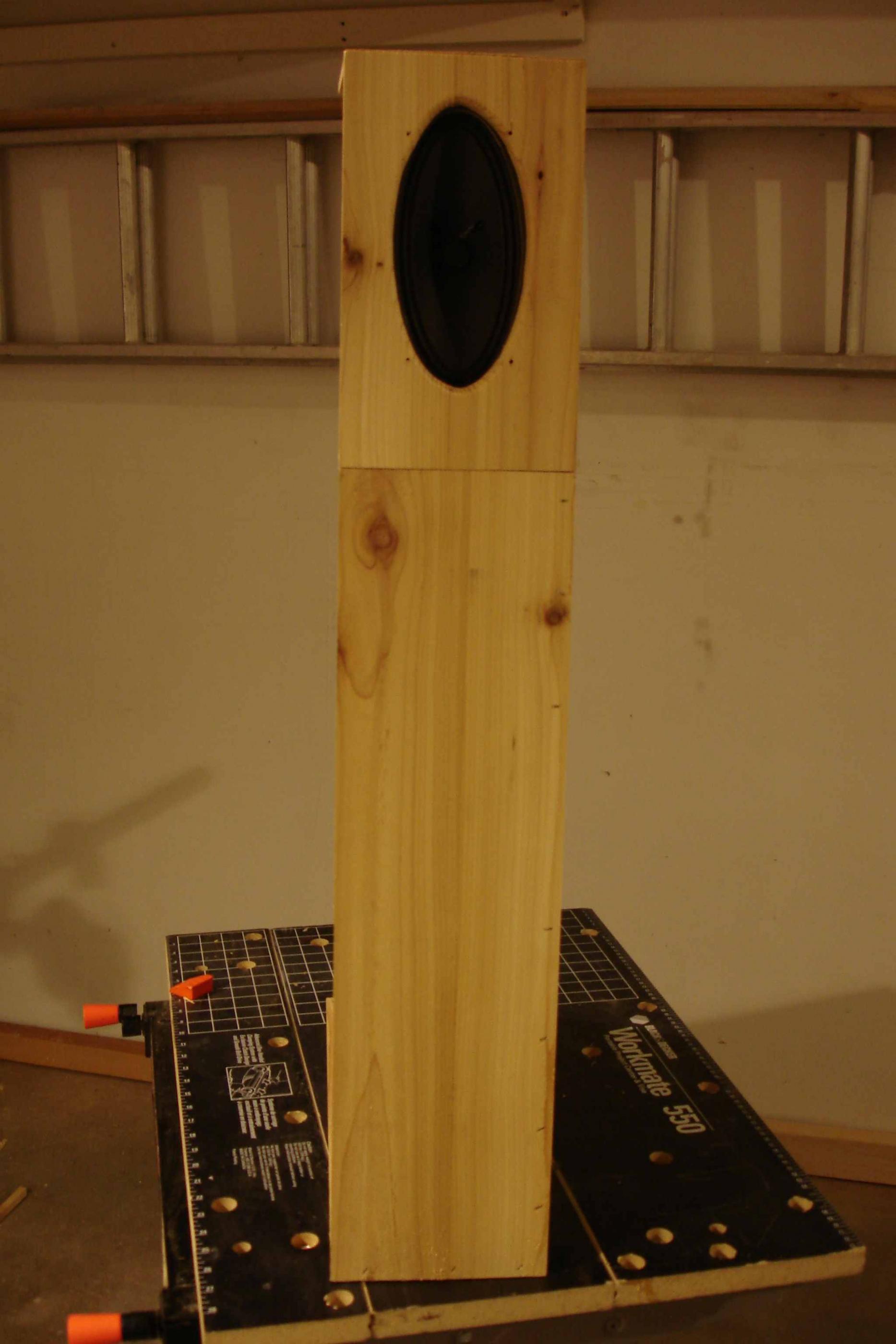

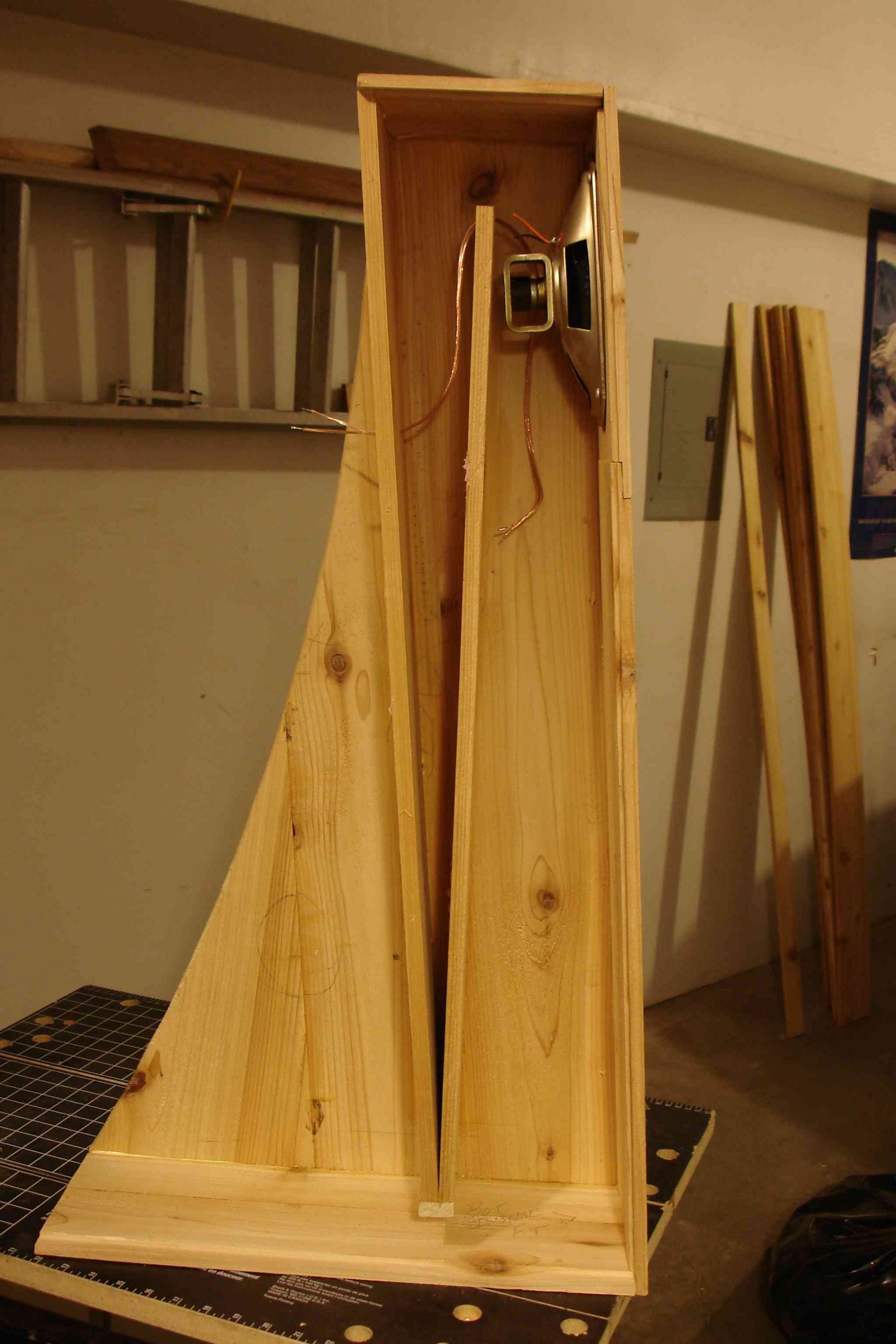

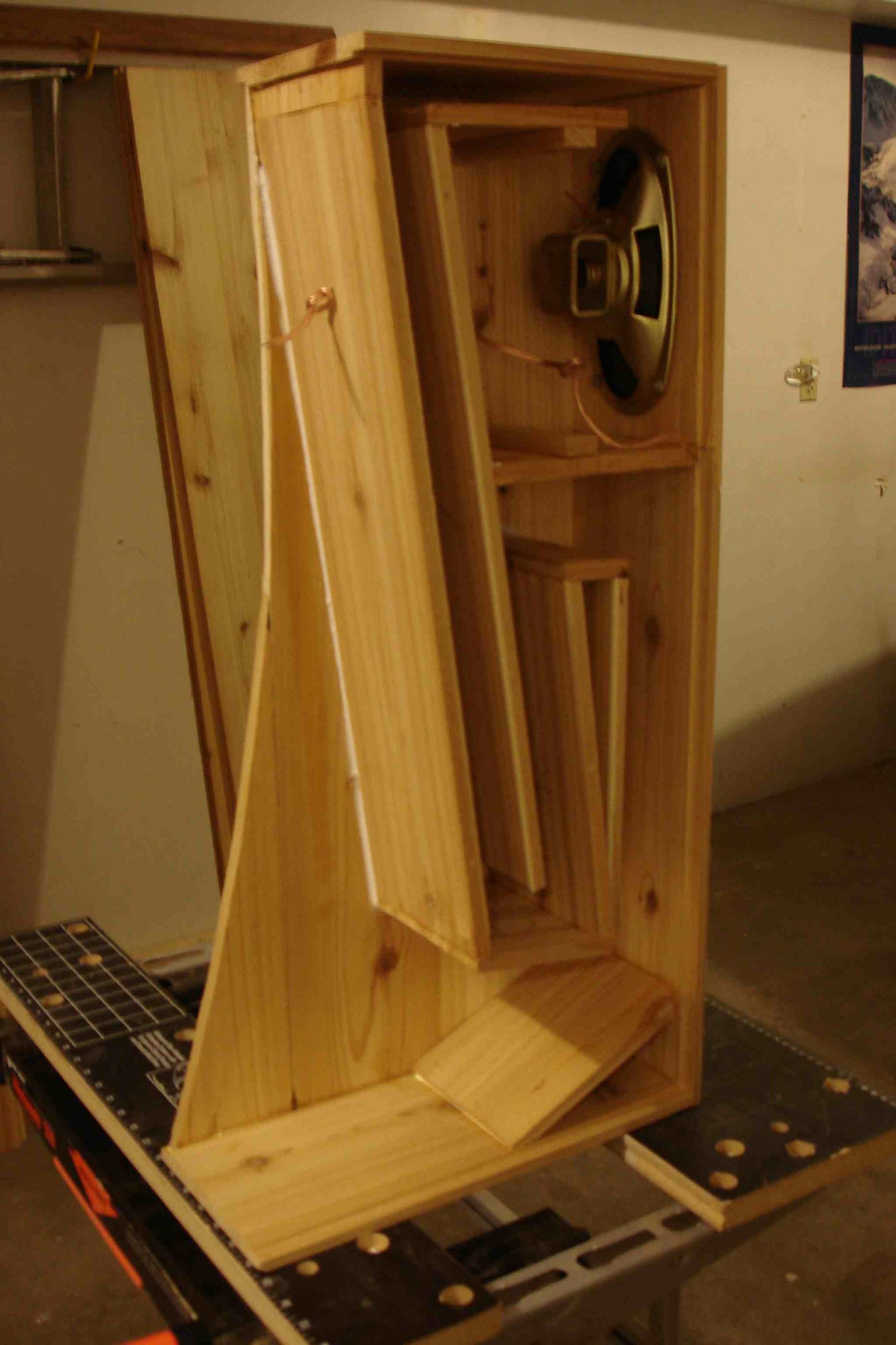

Going to build my first horn but not sure of which one so I build a couple of test mules i.e. FH1 and FH3 to see which one I liked better. Made them with removable speaker panels so I could test a few speakers. Used cedar fence boards milled to 1/2 inch thickness (not a good wood as to active, need something more dead; will likely use engineered wood flooring for the 'real' horns). Horns were glued and stapled except for the removable test panels. Speakers:
- Holey Corals 2.5 dia cone; Sony 082-13 8 ohm
- Oval 3x6.5 23333617 8 ohm from Conn tube organ
- 3.75 Round 4G 6A 3W 8 ohm
- 2.75 Tweeter Webcore Japan.
Tested by running sine wave frequency sweep with various upper and lower limits. Then tested with music. No hard measurement (ears only) but did have it set up so that I could A-B back and forth to easily compare.
Soon eliminated the tweeter (no low range) and the 3.75 round (had peaks and valleys).
Comparison of the horns using identical speakers. Both quite good and both significantly better than some older 2 way speakers. Both a bit better than a Boss system (except for the sub). Below 100 hz the volume of the sweep tone dropped severely which leads me to think a sub is required. Tested side by side in the middle of a carpeted room. Details between the 2 horns using identical speakers and identical speaker mounting.
- FH1 - more blended sound, rich,
- FH3 - sharp, crisp, sweep tone was smoother (chose)
- Coral - a bit less bass, good clear mid and highs
- Oval - bit better bass and good mids and highs (chose)
No fine tuning done with stuffing, and obviously the removable panel was not a tight seal.

Your bass will be limited by the middle of the room test and by drivers that are unlikely to have Fs <100 Hz. Try them in the corners.
