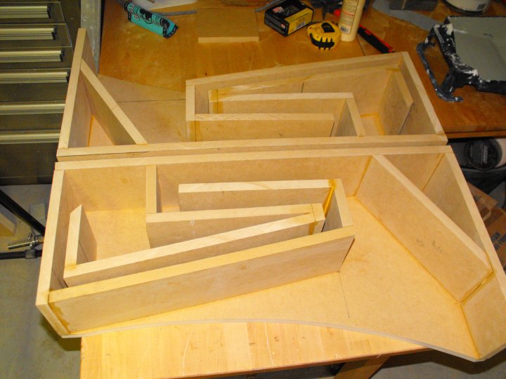

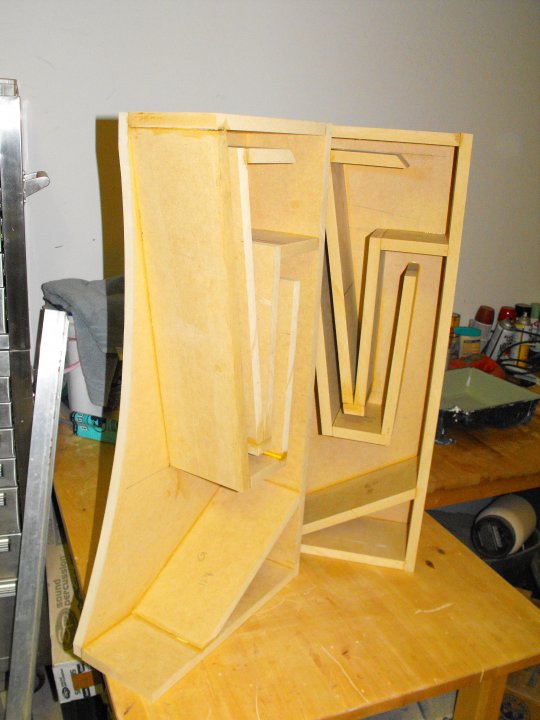

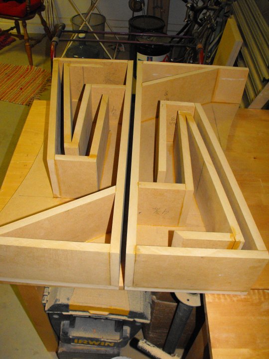

Two days in and I've got some good pics of my build on a pair of frugalhorns, I love the design but had to do a few mods to accomidate a pair of Infinity kappa 6.5 inch two ways... Here are the pics!
You no doubt had to make them wider, dimensional changes to accomodate 3/4" material, and you have the max possible Air cavity... anything else?

haha, you have an eye for details, love it, can't slip anything past you. It was actually quite a task, I had the extra 3/4" MDF left over from the 8' sub horn so I wanted to use it up. I tried to stay true to the original internal area measurements, because I have yet to successfully operate or even really understand HORNRESP, and to be quite honest I was ridiculously anxious to build them. It took nearly 4hours of recalculating and adjusting and had to redesign the plans completely, almost an inch taller and an inch wider, if I had to do it over again I would just go out and buy a sheet of 1/2". Saved money but wasted alot of time.
I have yet to build the supra baffles or deflectors, but by the end of Tuesday I will most likely be able to test them completed.
