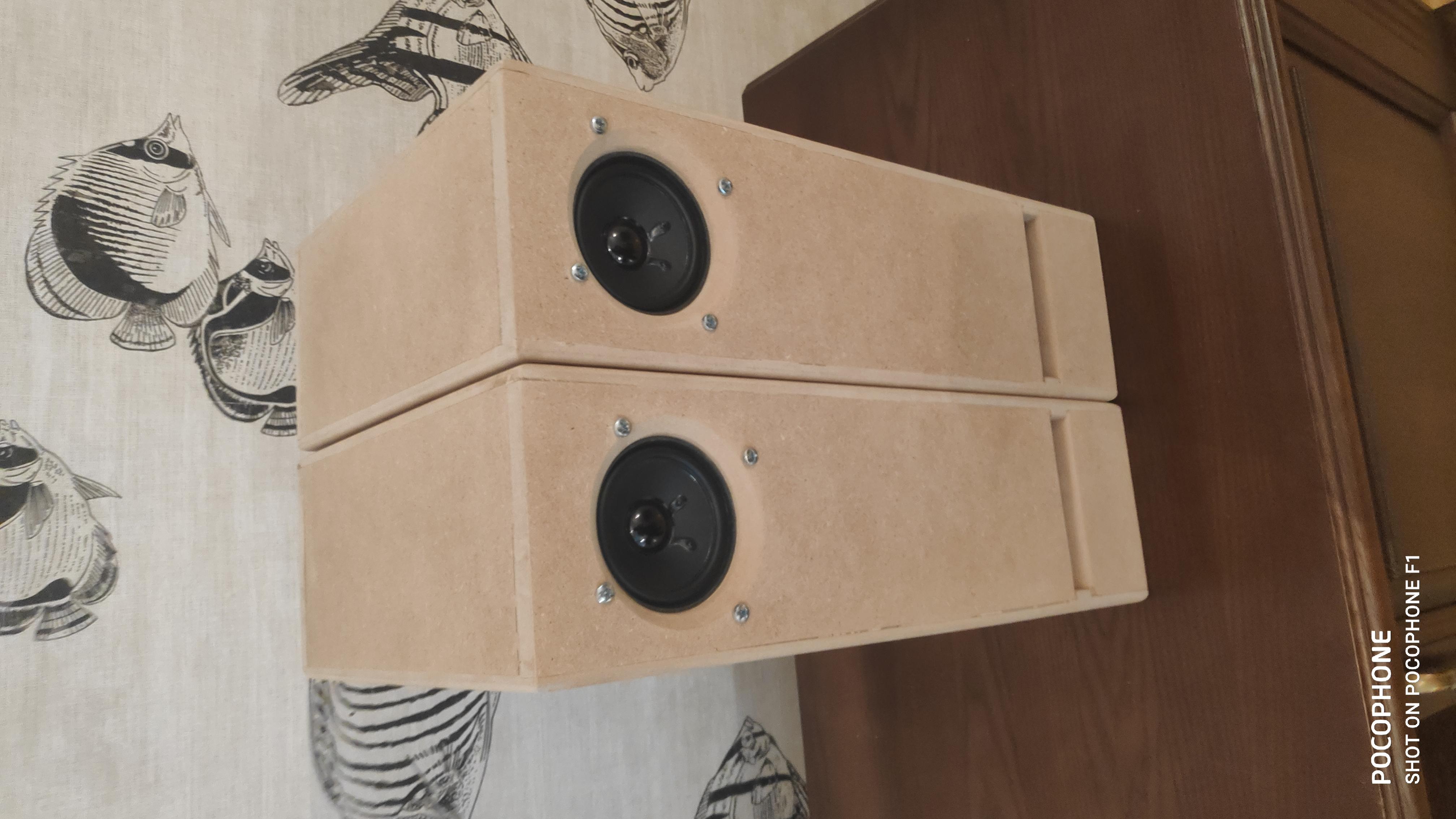

I own Visaton FRS8M in a MLTL enclosure (12,5 cm x 27 cm x 43 cm). As the comment #2, I agree that they don't have "real low frequencies/bass". However, if they are placed in the corner, you can "perceive low frequencies/bass" to some degree. In my 18m^2 room they are not that bad, but I'm not sure if I can recommend them in this exact setup.
And now to the "day dreaming" part. In my case I own H-class amplifier, which is not a good choice for powering these speakers. With an amplifier that is oriented toward more quality of sound, you might even get more "perceived low frequencies/bass".
