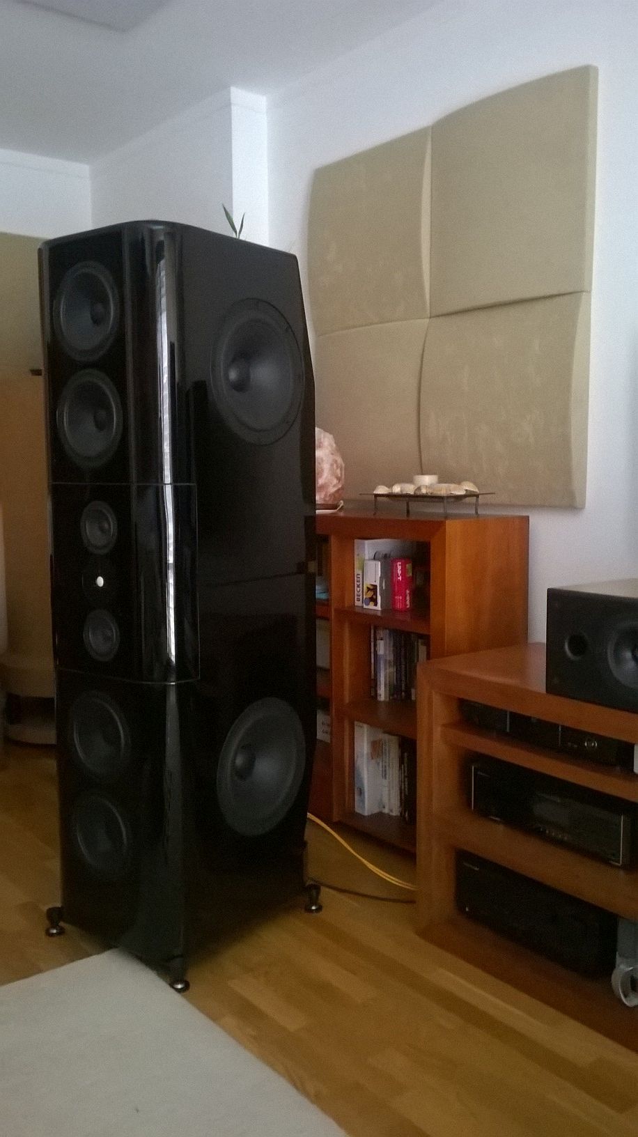

I just looked at my bank account and appararently I'm lacking a few hundred thousand dollars for the Göbels Majestic.. Oh well 🙂
[Edit - although nice the above speakers are not the design goal]

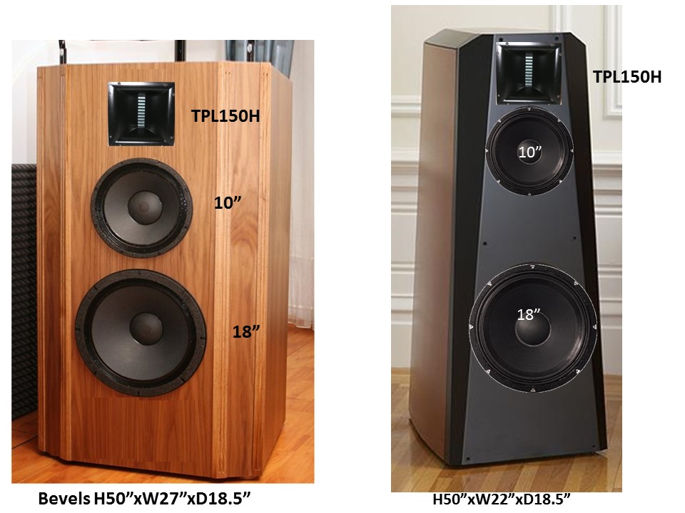

Considering your 4m x 5m size living room, to mimic the sound of the Göbels Majestic I would use three similarly constructed drivers in a T-M-W with crossovers around 1800Hz and 180Hz:
-Beyma TPL-150H pleated diaphragm tweeter with horn $450
-Faital 10PR320 10" midrange $350
-BMS 18N862 18" woofer 95db/watt $900
Göbels Majestic Drivers
2 pcs. Göbel® High End proprietary long-throw Bass chassis (18 inch)
2 pcs. Göbel® High End proprietary midrange chassis (8 inch)
1 pcs. significantly improved AMT tweeter with massive aluminum wave guide

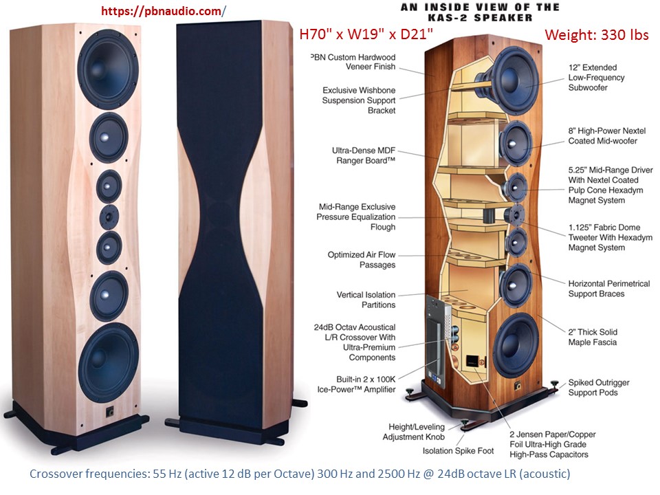

PBN Audio builds tall, symentric 4-way SWMTMWS speaker arrays in the "Duntech" style. Note the edge bevels around the MTM drivers to reduce edge distortion. PBN shorter 3-way WMTMW arrays use complex translam construction process.
PBN Audio

@LineSource - Thanks for the PBN inspiration. I see the beveled edge. I'm thinking how that affects the diffraction and what it helps for. Does the fluid depth difference of the bevel create a more evenly distributed spread of sound waves from diffraction (or how you say it)?

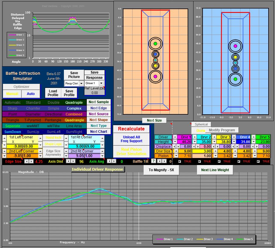

Attached baffle diffraction simulations.
1) 0.5" edge rounding/bevels
2) 4" edge rounding/bevels, similar to PBN MTM bevels
3) Designs with good solutions for baffle edge distortion
