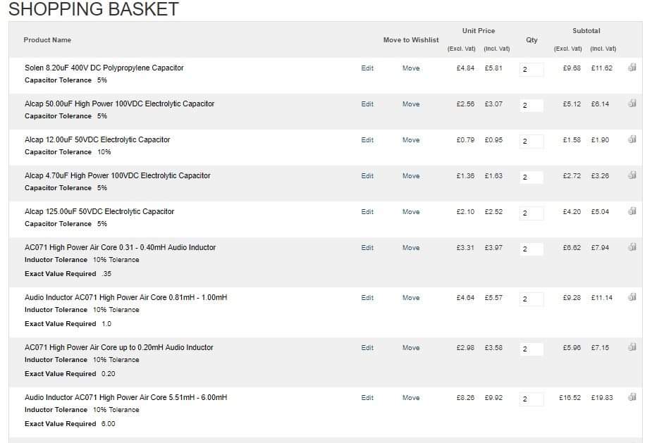

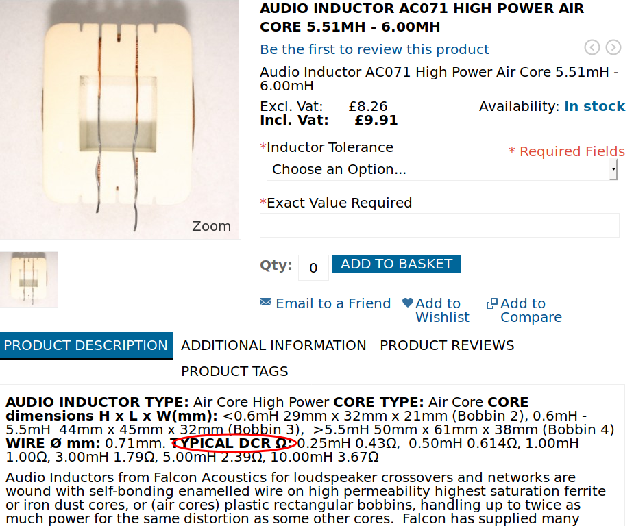

While I've got you, do you guys mind casting an expert eye over my crossover components? My main concerns are:
Is the 0.71mm cable suitable for the inductors.

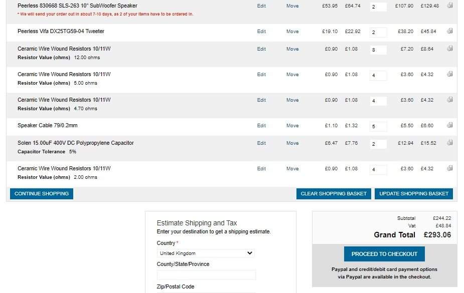

Is it a bad idea to run two parallel pairs of 2ohm resistors to make up a 4ohm resistor? I'm not entirely sure what the downsides are to it, but I'm struggling to find 4ohm resistors.

Edit: shopping list attached

The resistance of the larger inductor being over 2 ohms is likely to have a small but noticeable effect on the response. In addition this resistance will probably make the inductor warm when used for bass duty, possibly too warm.
That's OK, 2 in series will make 4 ohms. You should be able to find 3.9Is it a bad idea to run two parallel pairs of 2ohm resistors to make up a 4ohm resistor?
Your shopping list is missing the Peerless midranges.
Well spotted, Falcon don't sell them so I'm getting those elsewhere. I don't think it would sound very good without those.
I suspected as much. It might have to be a ferrite core as the lower resistance air core version is way out of my price range. Is the extra distortion likely to be noticeable?
Non-linear distortion, within reasonable limits, is not a significant problem. The issue goes beyond that where the chosen core isn't large enough for the duty it is chosen for. The core becomes significantly saturated in use and the effective inductance drops to what it would be without the core.

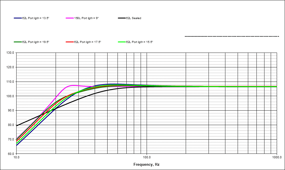

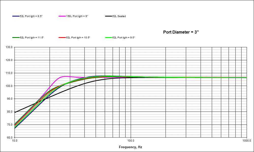

Attached below are response comparisons using different length ports. First pic is with the 4" diameter port and the next is with the 3". Curves are labeled so it should be self explanatory. The suggested "ideal" tuning with 150L is also included as well as the sealed response.
As you can see, the Tarkus is already hitting a response that is right in the middle or so between the sealed and "ideal" vented alignments. That should go a very long way to avoiding boominess when you take the room gain into account. Play around with the port lengths if you feel like it but I'm not sure if you are really going to hear that much of a difference.
Note that longer port lengths may need an elbow in the port which kind of makes it easier to remove just 1 section of the port and cut it to a different length.
And an iron core is indeed recommended for the 6mH inductor. Keep its resistance as low as possible though, down around 0.3ohm would be good.

Where did the suggested "ideal" volume of 150 liters come from ? That's over 2x the volume of the original Tarkus woofer enclosure.
That would also come from Unibox. The suggested alignment is in 150L tuned to 26Hz for an F3 of about 23Hz. Unibox calls this the "standard" design. See the graphs in post #12.
The alignment that Paul C has chosen in about 62L is an excellent example of why the standard design is not always the ideal choice. First the more gradual rolloff at frequencies down around 30Hz should result in a much better in-room response (which is not actually the case if the tuning frequency is up around 80Hz for eg - depending on room size of course) and second, it's going to result in a much more reasonably sized speaker for the average person.
Play around with the box modeling yourself - you should get the jist.
