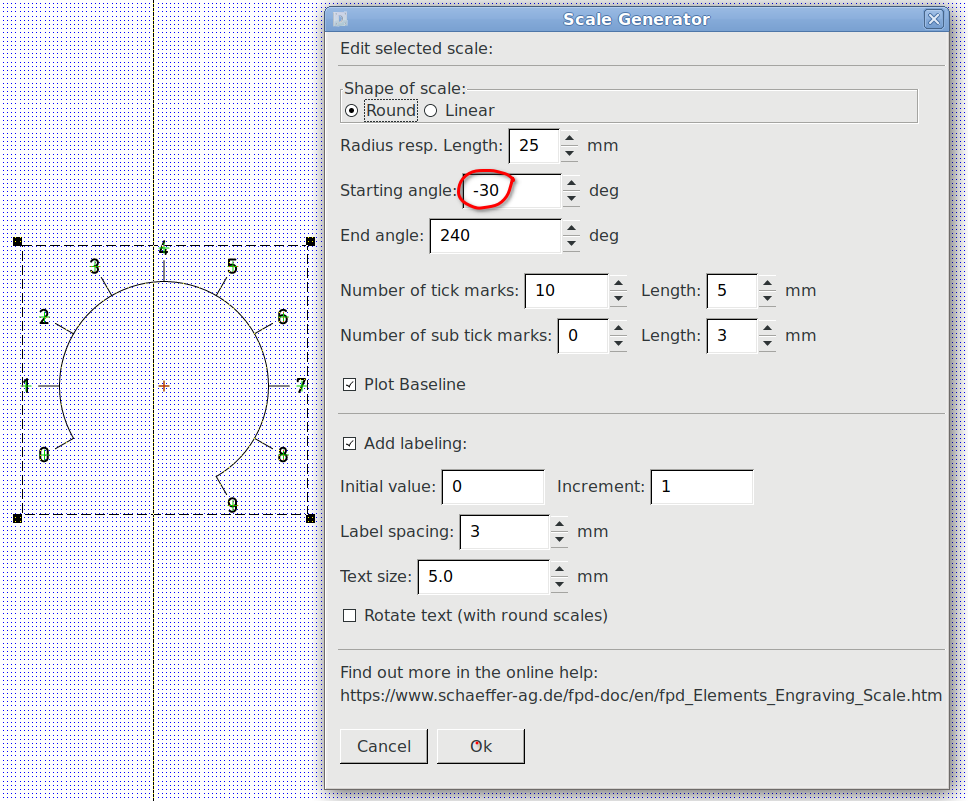

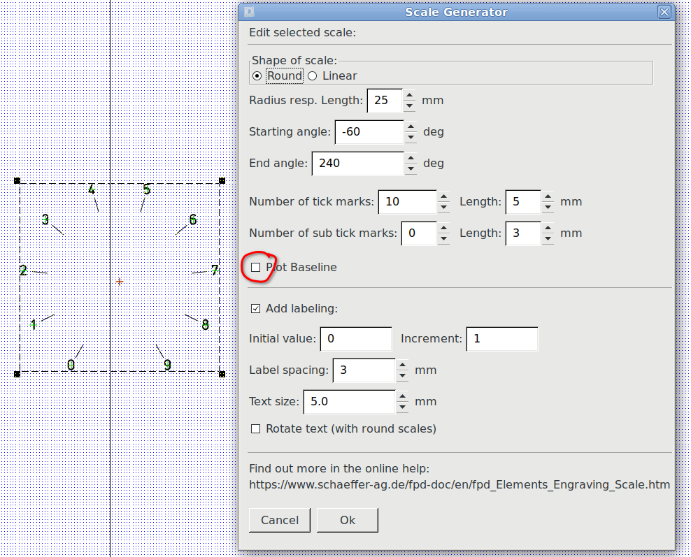

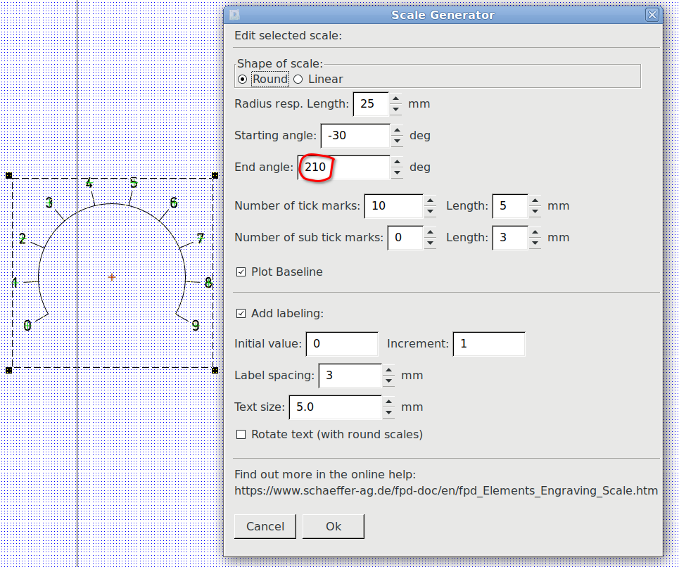

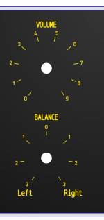

How about some samples? Perhaps that will help.
First picture is the one I designed for my front panel using the European version of that Designer.
Then a few sample to give you some feeling which parameters to fiddle to get things done.

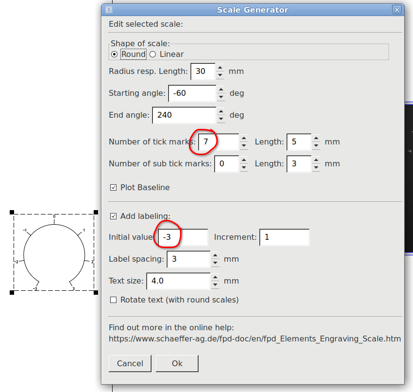

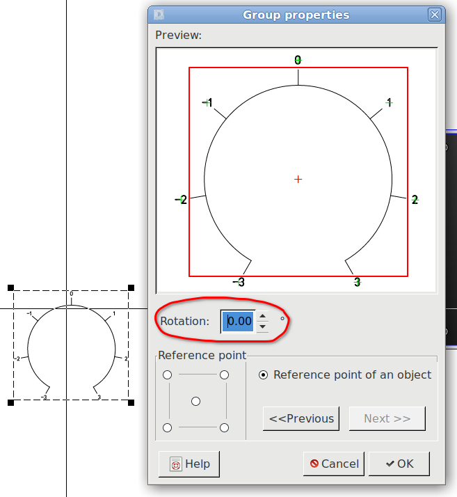

Thanks Joe, that's just what I want and I understand these parameters OK, but how do you place a Zero at the top of a scale with 1 to 5 on each side & -1 to -5 on the other side, similar to your balance control.
I cannot see how to set these in the scale generator.
Something like this ?
You can also, after you have made something do a little nudging by double clicking on it and then you have the possibility to do some rotation.
Hope this will be of some help.

Joe, I'm still struggling, but thanks to you, the scales do look good !

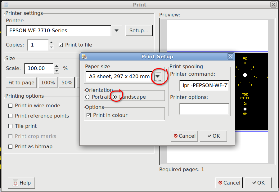

I tried printing a scale out, directly from Designer after moving the scale upwards from the grey box.
The scale prints & looks fine, but there is no centre dot & the page position in Designer does not correspond to the page print position which is very awkward.
Also, how do you remove the grey area for printing ?
Any suggestions ?

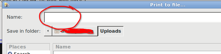

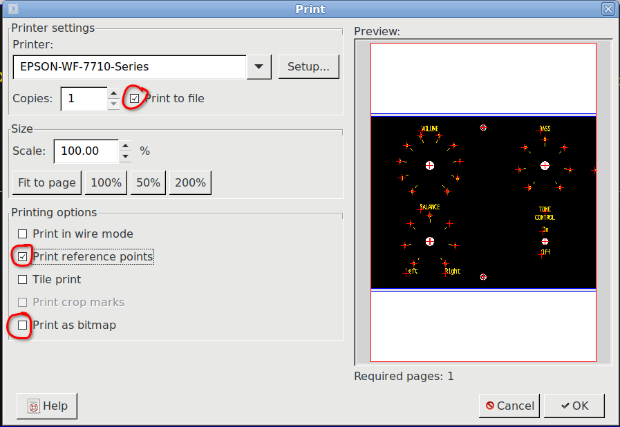

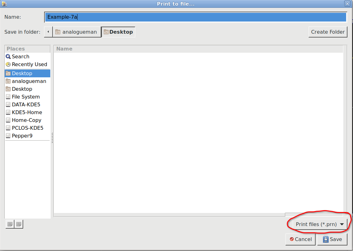

You can tic "print referent points" and "print to file", save it somewhere and then use a document viewer to open and print that .prn file. I am using Atril Document Viewer ( I have a Linux O.S.).
Do not know what you mean with "grey area" though.
It seems that "print as bitmap" does not work. At least when I tic that possibility nothing happens after I hit the OK button.

Thanks Joe. - Good suggestion about print to file, except that I cannot get it to work !
I'm using old versions of MS Word - (2003 & 2007) because they basically work fine for me & actually my real preference is the earlier one as it is a lot easier to work with.
Print to file just pulls up my actual printer menu even after I have selected "Print to File" & named it. Then all it does is take me back to the actual printer menu (Canon 8760) with either print (on the actual printer) or cancel.
I tried doing a screenshot but resolution suffers.
I think the simplest way is now to make the dials I need in a large format & simply print them out & photograph them.
I can then put them into a photo editor & reduce as needed.

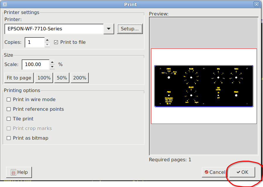

"....Then all it does is take me back to the actual printer menu (Canon 8760) with either print (on the actual printer) or cancel."
That is strange. I get the following when I am starting to print:
The last picture let me choose a file name after navigating to the directory where you want to put that .prn file.
I do not understand why it is not possible in your Windows system to simply print it. I cannot help you here because to test I need a computer with Windows which I do not have. The only Windows I have are in the walls of my house 🙂 .

Good explanation & screen shots Joe, - thanks.
Obviously mine works very differently as your print to file appears at the end and gives you a path to save etc. Mine has the print to file first and then returns to a normal printer menu.
Maybe I will try it on my Mac but same printer though.

What happens when, after again adjusting the printer parameters, you hit the OK button? Does it gives you then the possibility to navigate to the place where you want that .prn file?
