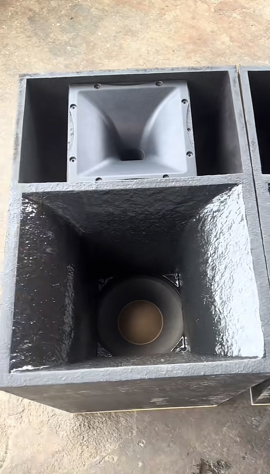

Hey all,
I’m seeking help to design a pair of front loaded horn cabinets. These cabinets will be seating a 12mh36 B&C paired with a HLCD (2445j) all controlled via DSP. I’m hoping to see a freq response from approx 250hz-1khz. (ideally would like it to go lower ~150hz but may not be applicable as it would need to be longer, from my knowledge, needs to be around 10" depth for my needs). I’m pretty new to using hornresp so i don’t know if there’s a given rule to input parameters such as s1,s2 nor actually getting the horn flare measurements for cutouts etc. I want to design a horn that starts conical and goes exponential, (see picture) open to other designs as well maybe tractrix and such. Im trying to make this as compact as can be as it would be toted in car and used. If anyone can help me even get started I’d appreciate it!
